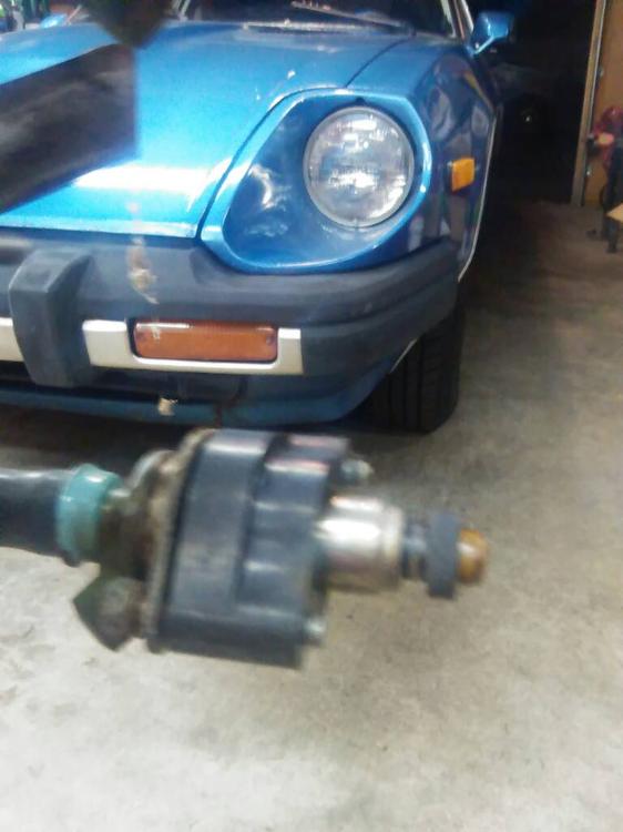

Posted November 21, 20186 yr comment_562072 I replaced my fuel rail and installed some green top Injectors into my 1981 280zx. When trying to crank it 6 puffs of smoke (one per injector) came out from the injectors ports. Do the injectors have little seals around them that I forgot to Install?? Im not sure what to do. I did notice a gap between the hole for the imjectors and the Injectors themselves. Any ideas? Link to comment https://www.classiczcars.com/forums/topic/61121-injector-issues/ Share on other sites More sharing options...

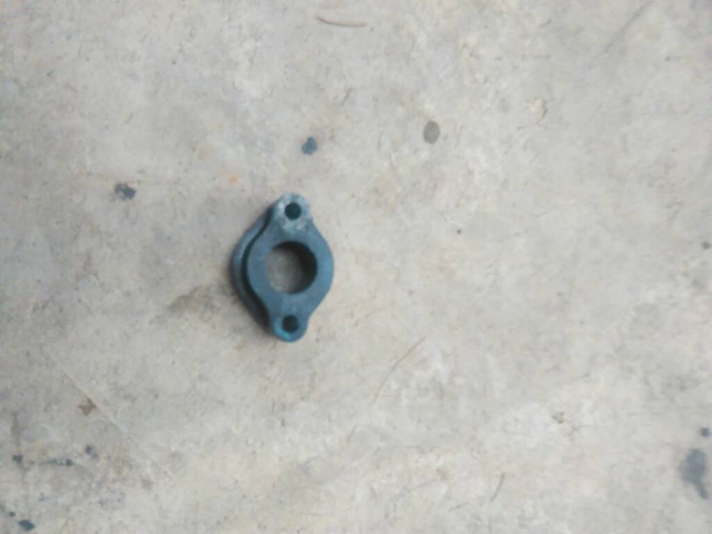

November 21, 20186 yr comment_562074 The injectors have O-rings. Also, the plastic pieces that fit over each injector might be broken. Sent from my N9130 using Tapatalk Link to comment https://www.classiczcars.com/forums/topic/61121-injector-issues/#findComment-562074 Share on other sites More sharing options...
November 21, 20186 yr comment_562075 They're cheap and probably available at one of your local parts stores. I searched on 280Z but 280ZX is the same. The small ring seals, the big top ring applies the downward force and vibration damping. https://www.oreillyauto.com/detail/b/standard-intermotor-5820/fuel---emissions-16775/fuel-injection-16471/fuel-injector-seal-o-ring-kit-12312/ee721b9bfdb5/standard-intermotor-fuel-injector-seal-kit/sk4/6017490/1976/nissan/280z?q=injector+seals&pos=3 https://www.oreillyauto.com/search/1976/nissan/280z?q=injector+seals Link to comment https://www.classiczcars.com/forums/topic/61121-injector-issues/#findComment-562075 Share on other sites More sharing options...
November 21, 20186 yr Author comment_562109 Aleigjty! I think I'm missing the little o rings like y'all linked and sent pictures of. I'll pull off the fuel rail and injectors and get a picture of them. On a side note. On the blue ECU plug under the dash, there is a 2 pin plug with a yellow solid wire (I think) and a yellow worth red stripe wire. When I replaced the harness I failed to note where that plugs in. Any ideas? Thank you for the help Link to comment https://www.classiczcars.com/forums/topic/61121-injector-issues/#findComment-562109 Share on other sites More sharing options...
