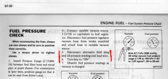

November 24, 20186 yr comment_562280 Pull the wire off of your oil pressure sender and alternator and turn the key on. The pump should get power. The FSM and the EFI Book 1980 have more about how things work. https://www.classiczcars.com/files/category/14-280zx/ https://www.classiczcars.com/files/category/4-manuals/ Link to comment https://www.classiczcars.com/forums/topic/61137-sending-unit-outputs/#findComment-562280 Share on other sites More sharing options...
