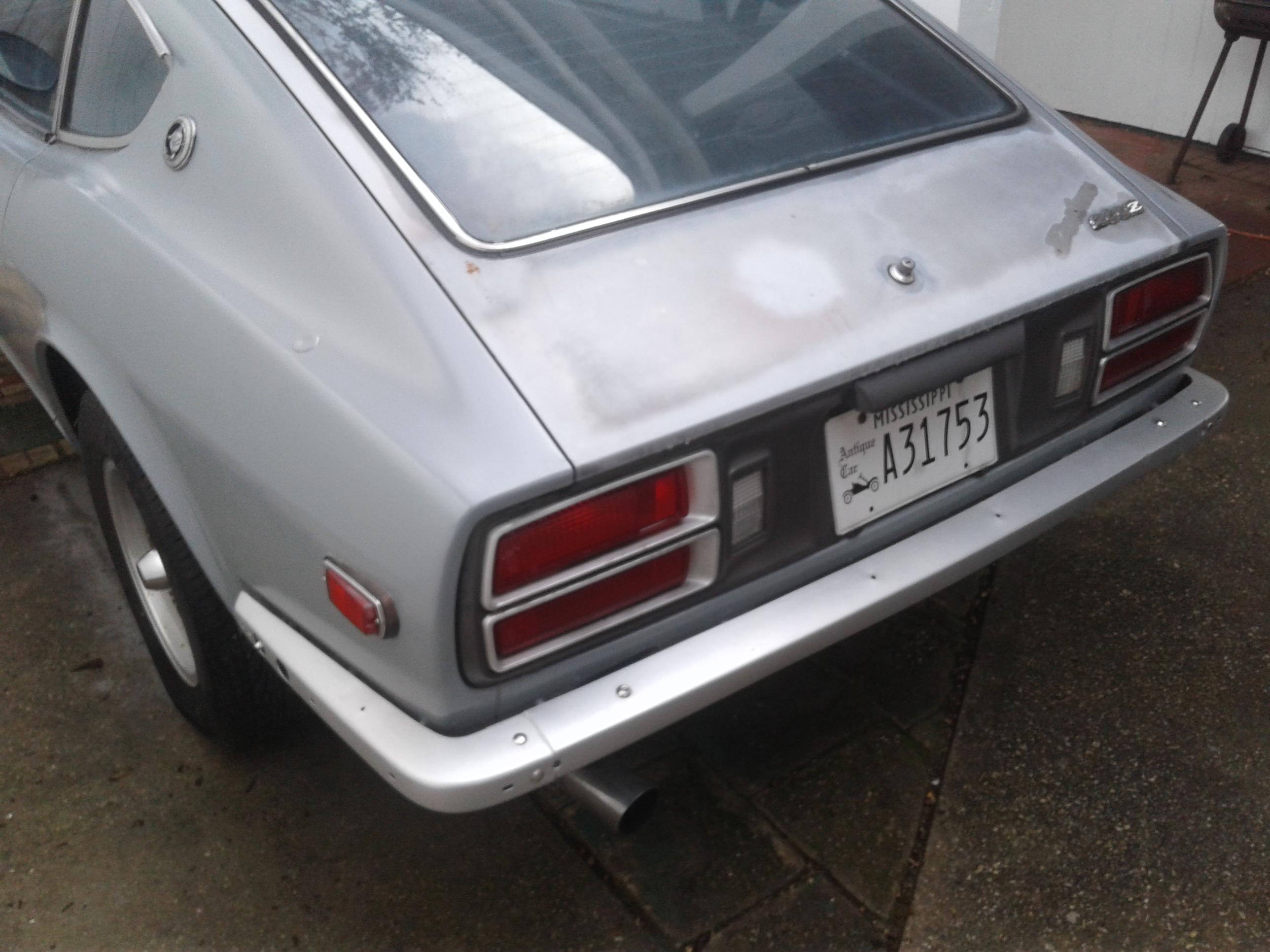

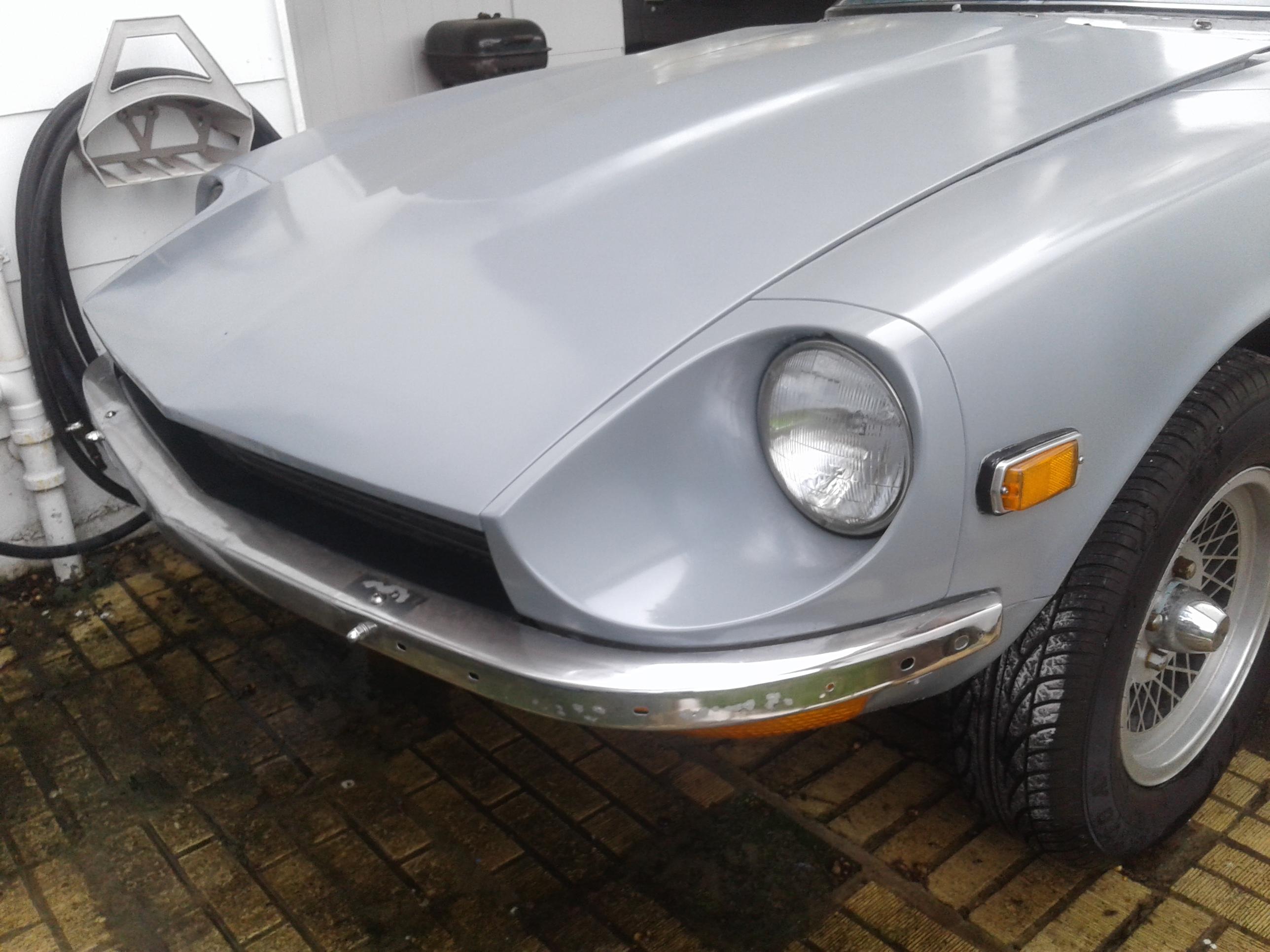

Here are my early 260 bumpers pushed in on my early 260.  They don't interfere with anything, but I have no 240 bumpers or 280 body to compare.
