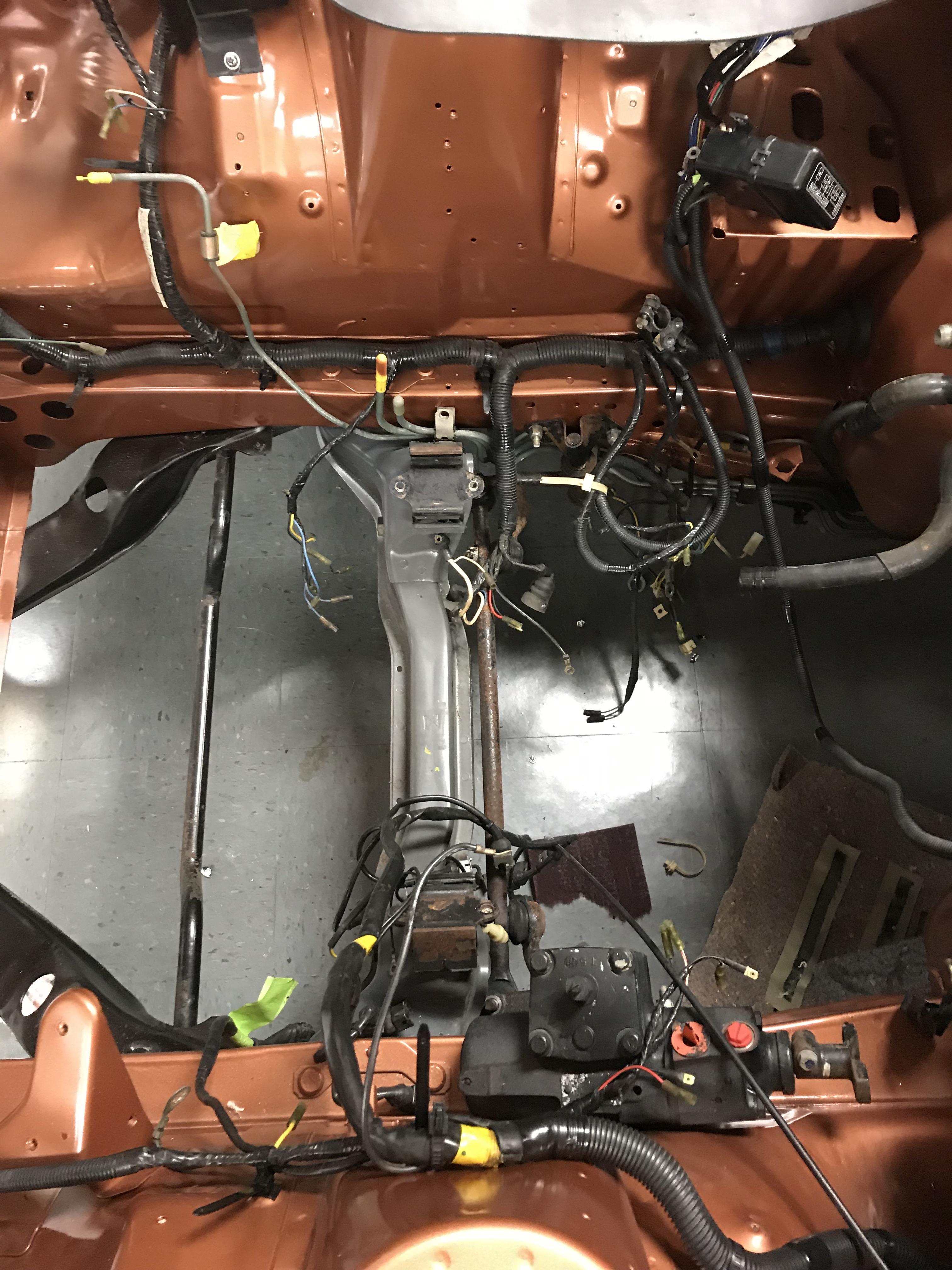

I'm steadfastly trying to restore everything on my 280zx to original stock condition as much as possible. And, the restoration crew is putting things back together now.

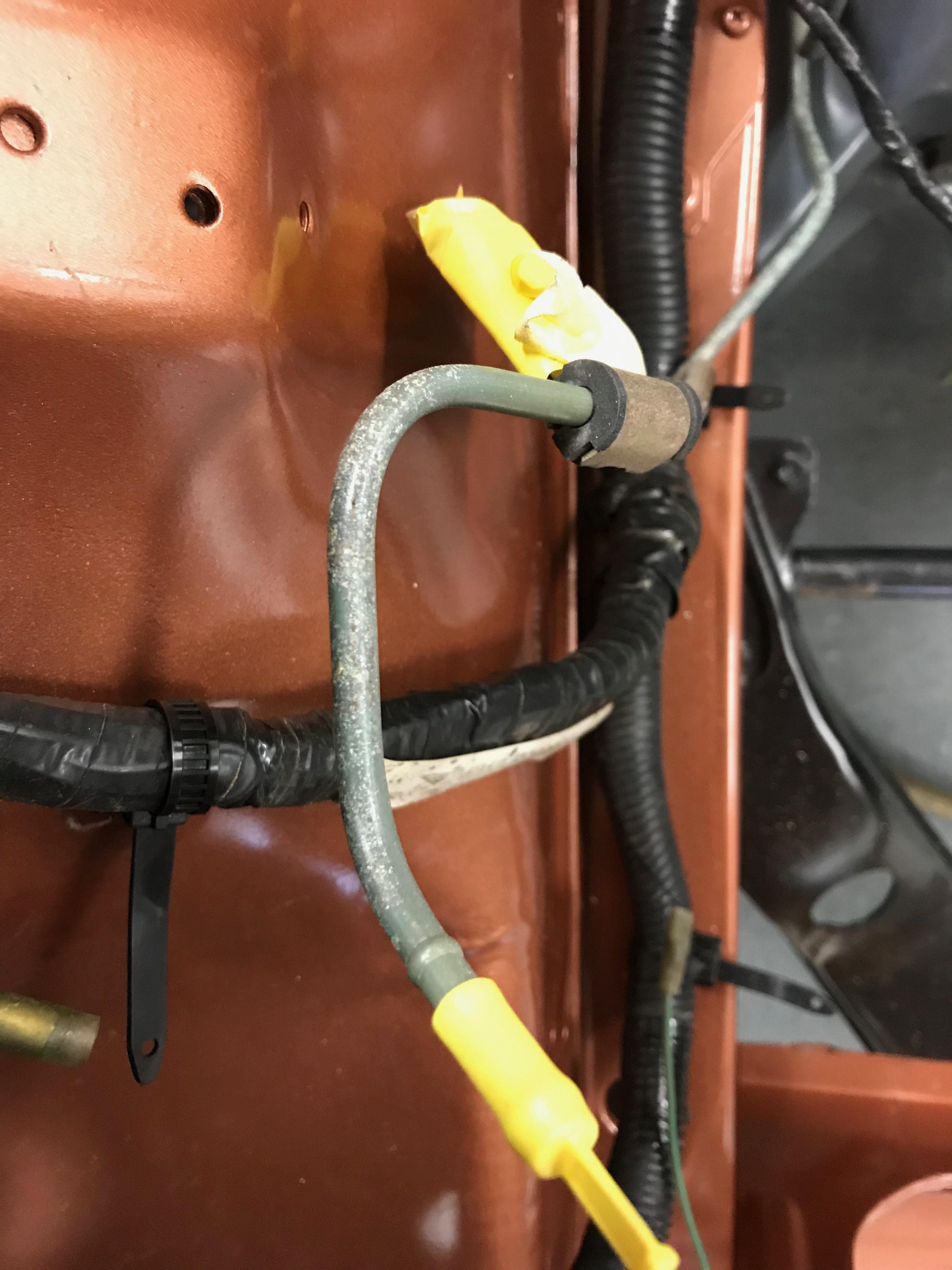

I have attached two photos of the brake line that's under the engine compartment and I'm trying to determine the original color of the brake lines. Can any one help with identifying the original color of the brake lines? It looks like the brake lines have a green-ish color. The white spots are probably from dampness and corrosion.
Engine an drive train are out. Yes, they already scratched the new engine compartment paint job. But, do you have any idea what the original color of the brake lines are? And is it paint or is it a baked-on finish?

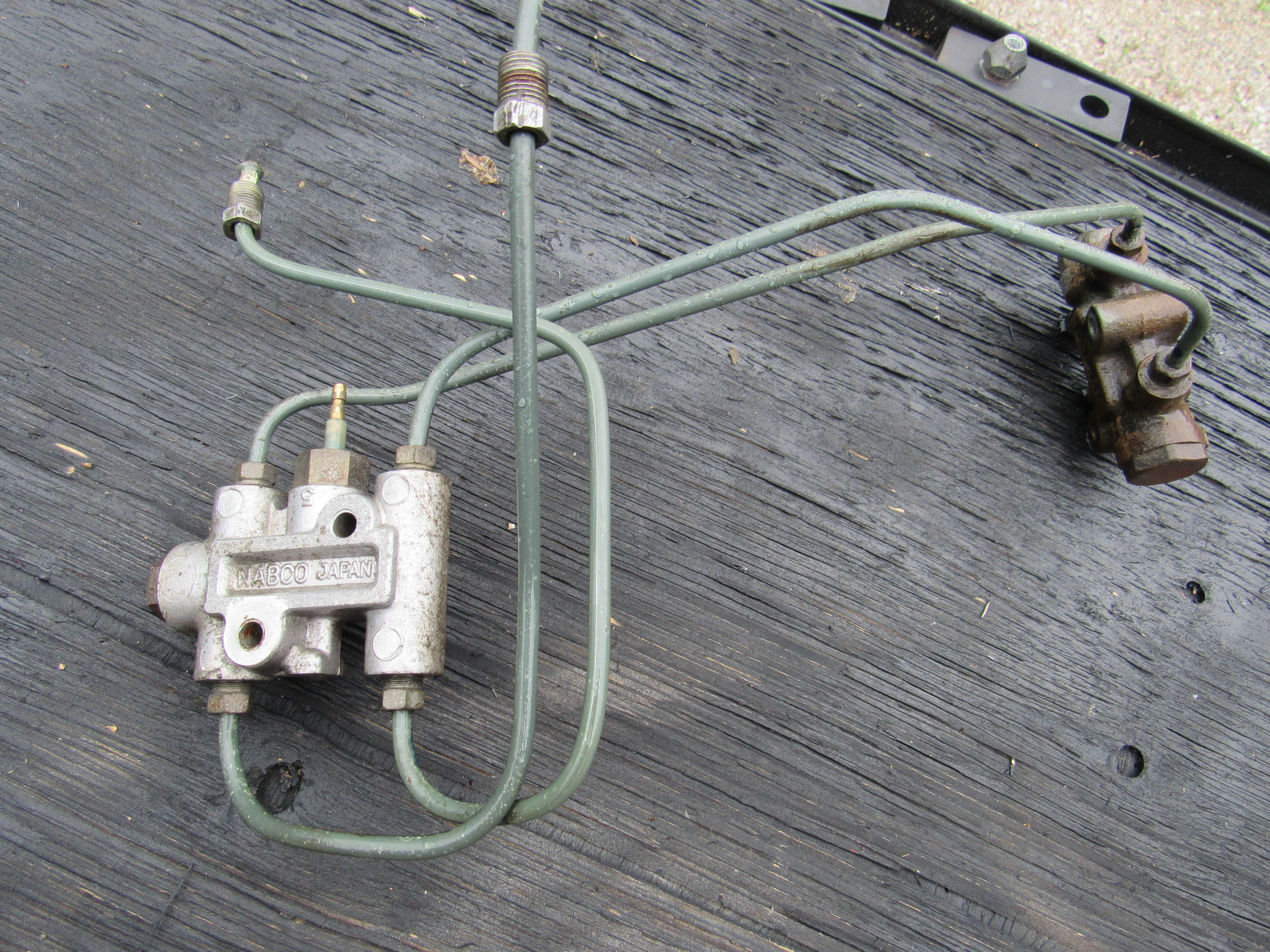

Attached are some images of a couple of NOS, OEM Nissan, hard brake lines, for my 1977-built 260Z (UK car), if it helps. There is a little bit of shade variance between the two parts, but that would be expected across items manufactured at different times.  I don't know if they salt the roads in the US, but those white specks occur on UK cars when the water evaporates from waterborne road salt. I have seen the olive green colour (color) of your hard brake lines on other Nissan parts of that late 1970's era.
Thank you for sharing the photos! I believe (now) that I'm looking at an olive green tint.

I do have a couple of NOS horns that have the olive green finish applied to them, but the photograph (attached) may not be entirely representative of the true color, unfortunately, as it was taken under a fluorescent light.  I have taken a picture of the olive green-finished horn next to a NOS brake line, as a comparison. There does appear to be a little color variance but, as I mentioned in my post above, that is to be expected.
Wow. Your parts look like they have been coated with the yellow cadmium, having a slight iridescent tint to them! That makes sense since a lot of my parts have the yellow cadmium / yellow chromate coating with an iridescent tint. The green on my brake line parts might be part of the remaining yellow cadmium coating.

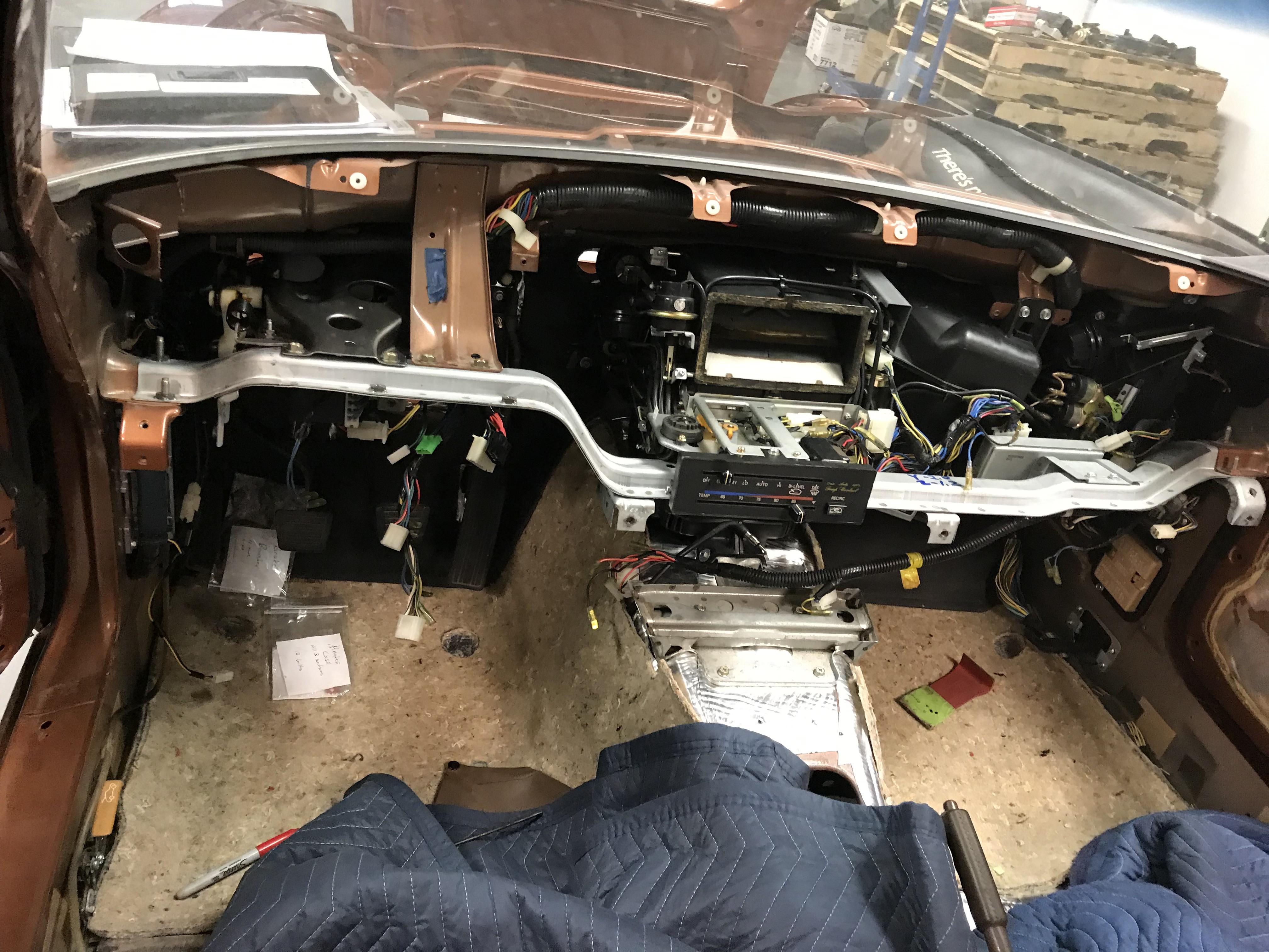

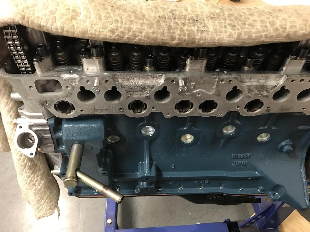

Here are some other photos taken on Friday.

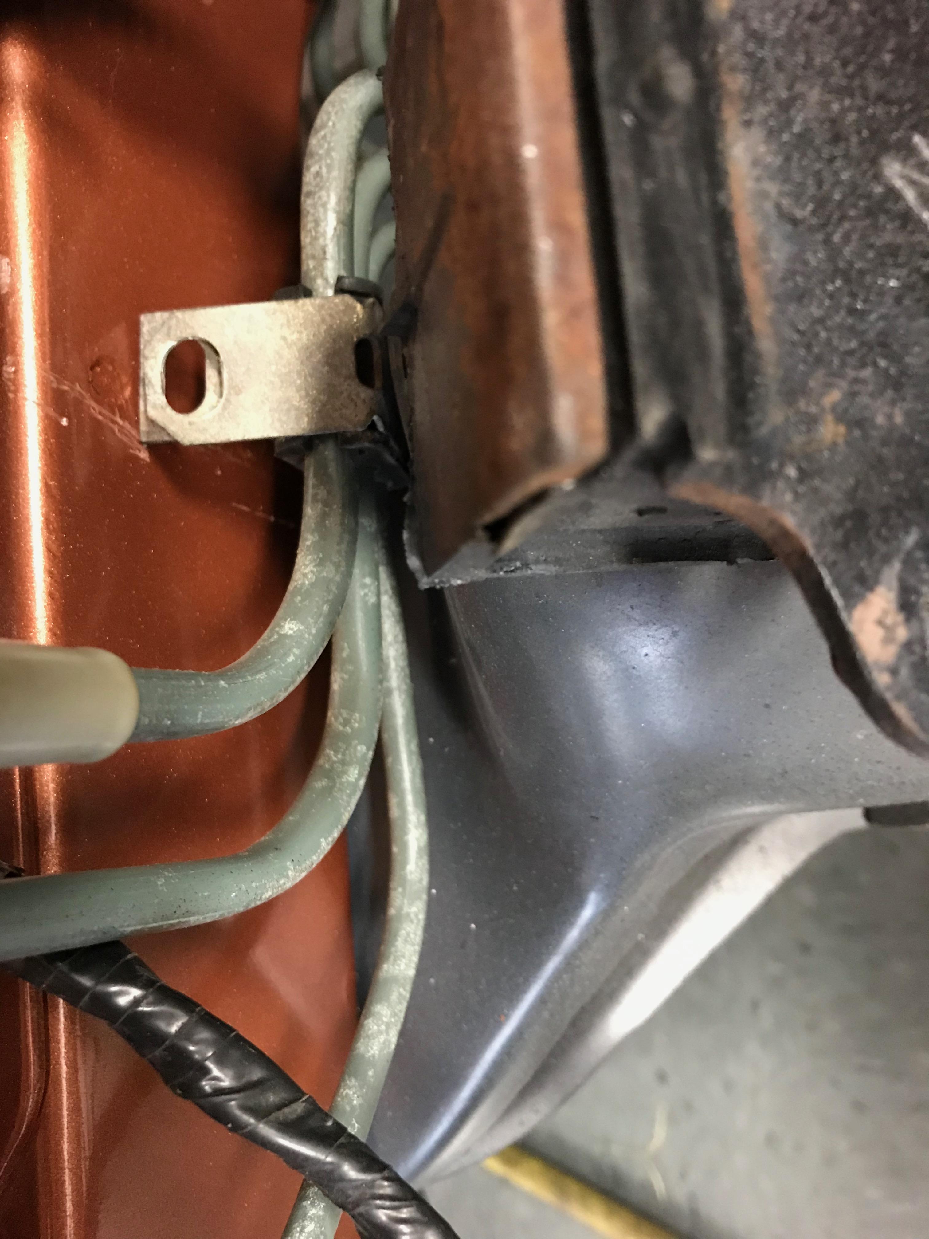

I'm restoring a Original EU (Netherlands) Datsun 280zx 1979 2+2 and they have olive green brake lines.  The lines at my car were very good preserved for 38 years!   It's a bit darker than the lines  i see in your pic's..    If it is paint or "baked on" i don't know..   for paint it looks to thin of a layer..

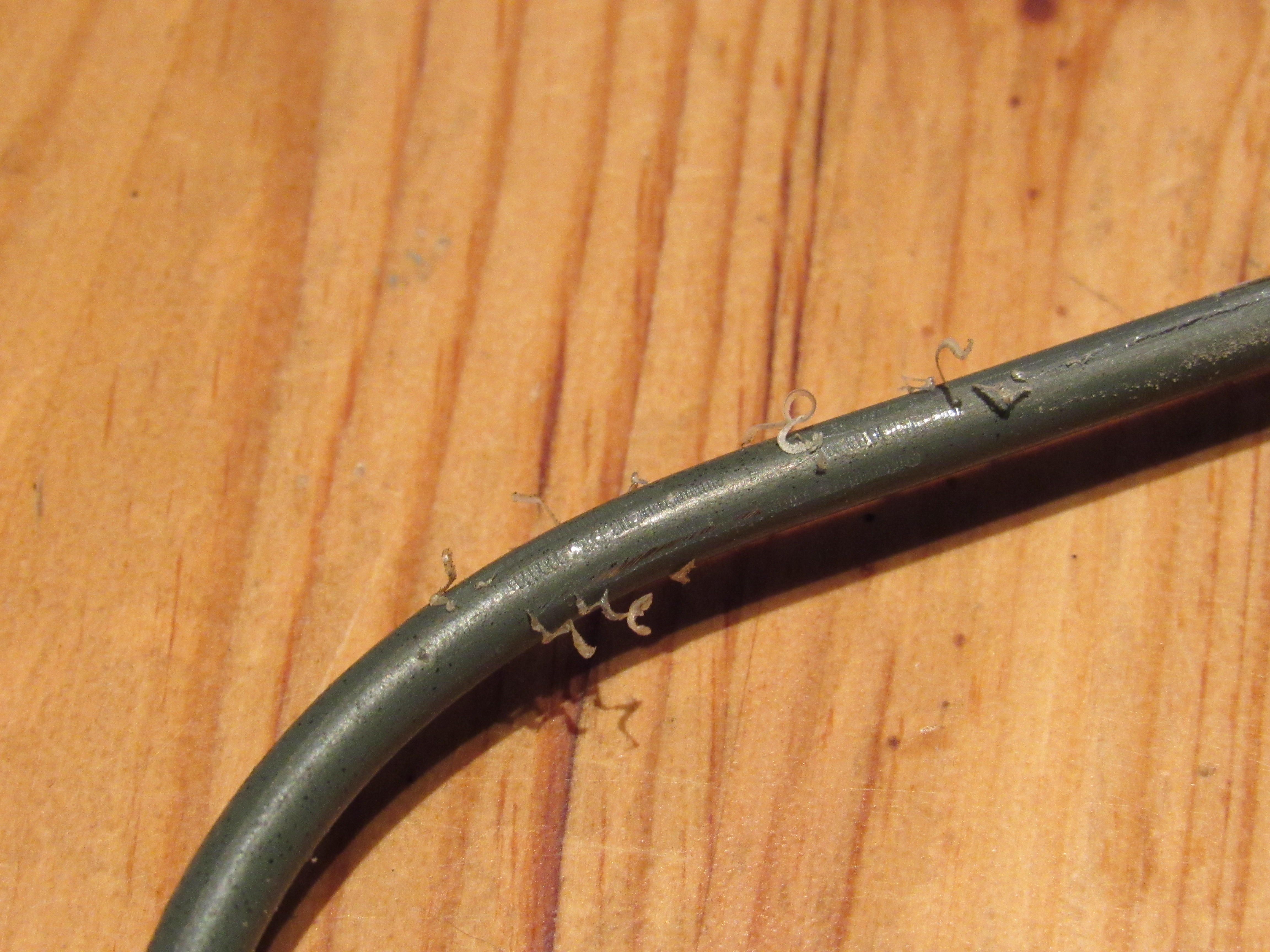

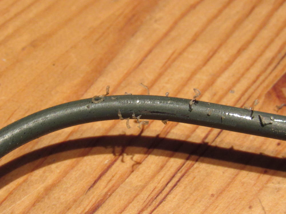

The brake lines on a my 77/280z also had the olive green coating, I started sanding it off at first,  it ended up being too difficult so I replaced them with a new set of Cunifer lines but I'm pretty sure the green coating is some  kind of plastic or at least it sands off like plastic.  You can see in the last 2 pics how the coating curls up when scraped with a razor which makes me think it isn't paint or zinc. If you can't find NOS lines there is always the possibility of stripping the lines and have them powder coated of painted.

There is no plastic coating on my brake lines.
