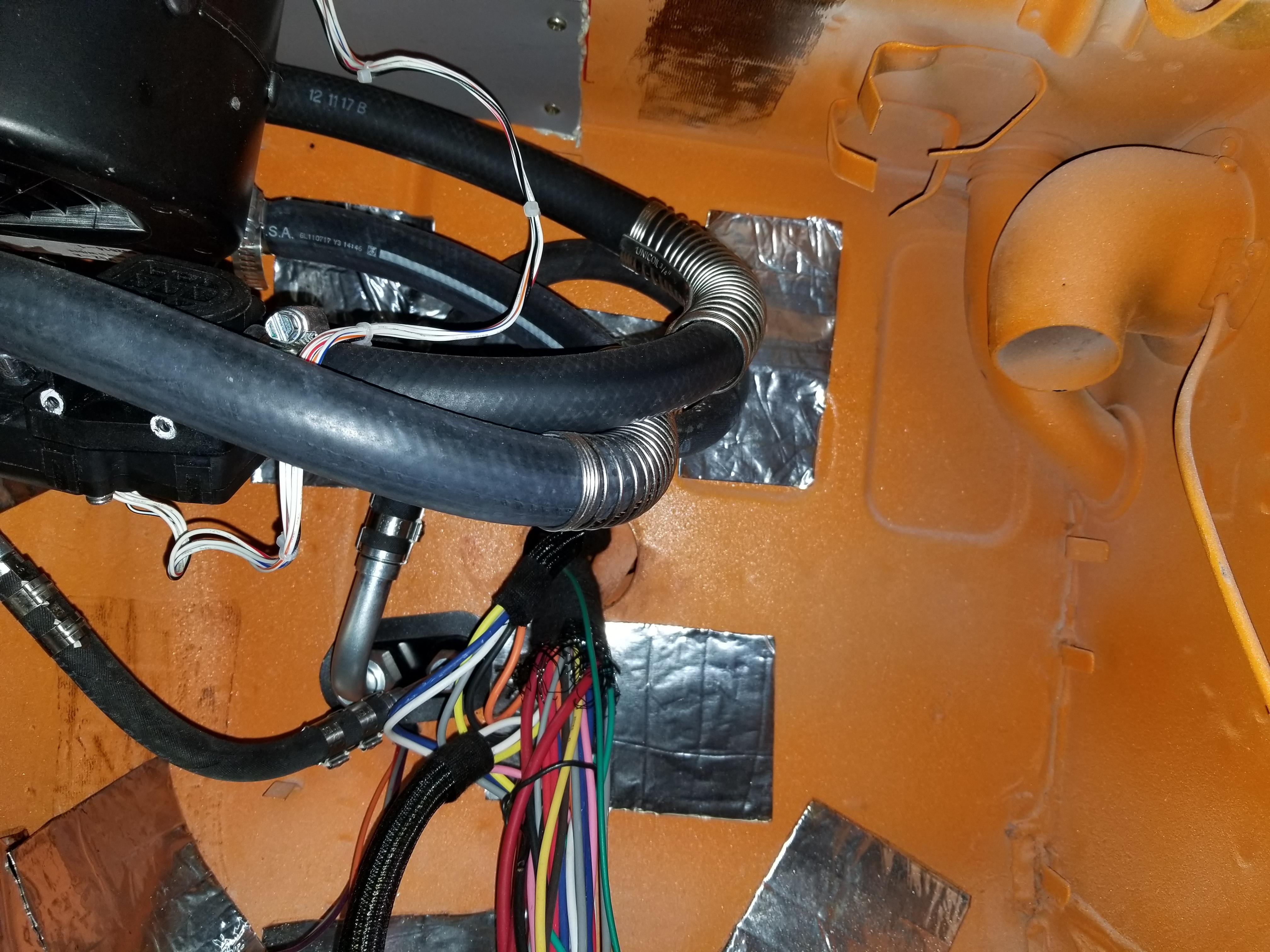

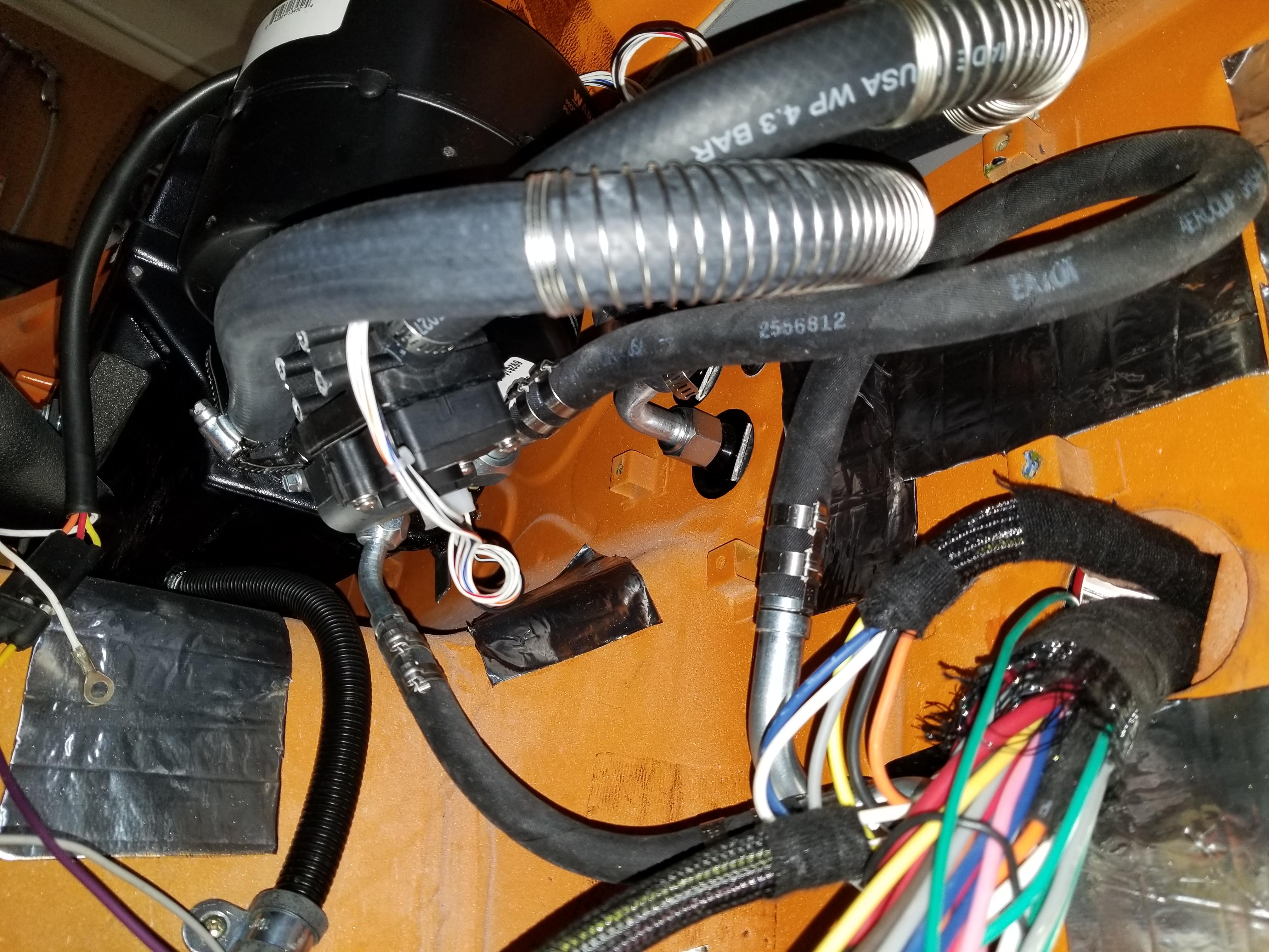

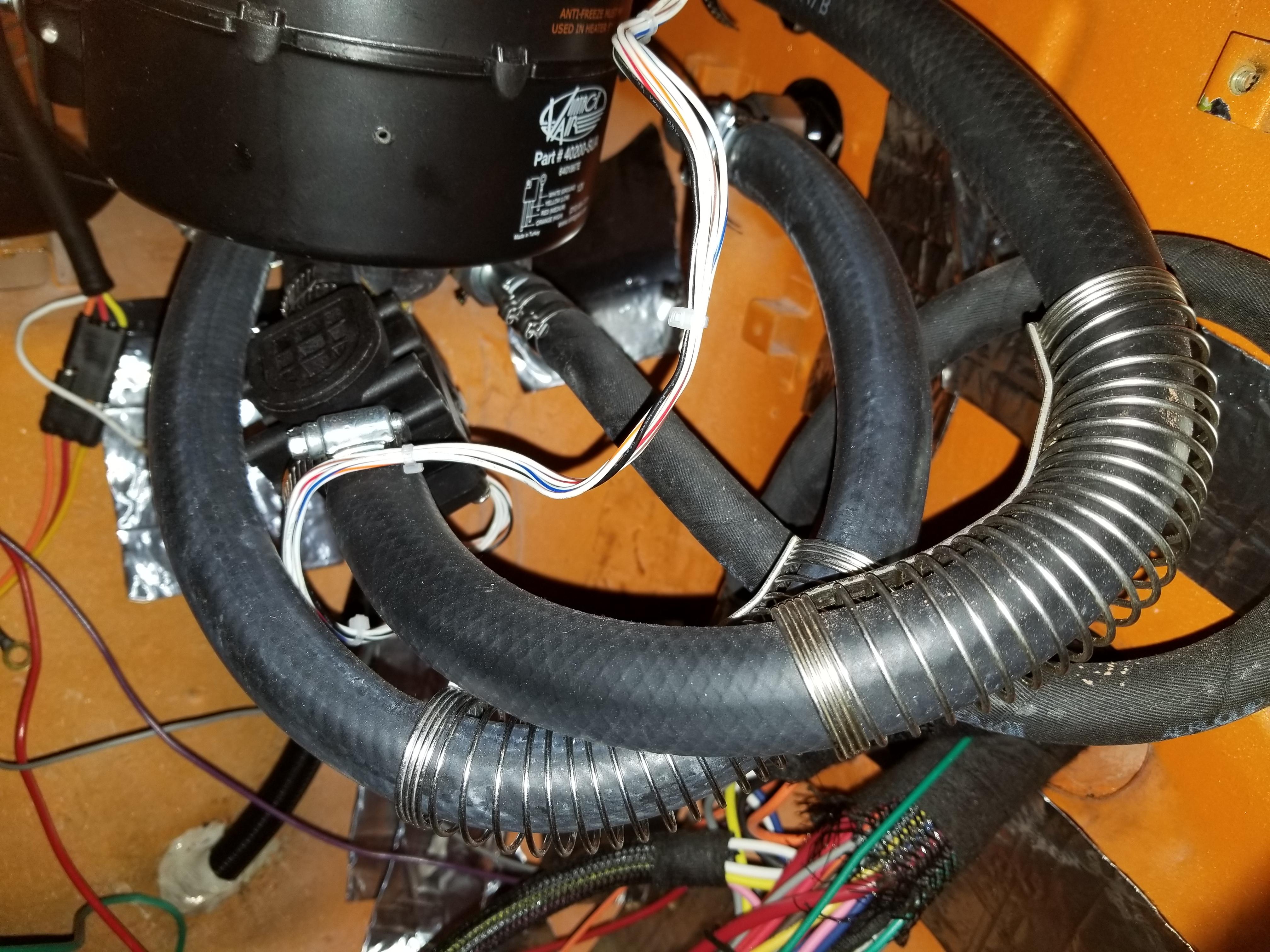

February 15, 20196 yr Author comment_568437 Wheee, I am sure that I have the detail photo for whatever you are looking for and if not I can take an additional shot or two. Having said that I am not sure what you are looking for. Below are additional pictures of the cockpit to bulkhead hose routing. Hope this helps but if not let me know what you need and I will snap another shot. So this is a fairly good shot that shows 3 of the 4 hoses. The hoses moving left to right . The first hose (furthest from the firewall is the heater return hose. The next one if the heater entry hose. It has the electric valve (box closest to the Evap Unit). Both heater hoses have EZ coils on them to prevent collapse of the hose. Probably not needed but bend is sharp (not severe) and I just wanted to be on the safe side. The heater hoses go through the firewall behind the evap unit, those bulkhead connections are partially visible in this image. This image is shows the AC bulkhead connections below and to the right of the evap unit. My partially dressed wire harness obstructs the view of the 2nd ac bulkhead connection. This image is from underneath (low in the footwell). Not a lot of extra room. It actually looks worse than it is because of the water valve (the square plastic box under the water hoses). This is really the first view of the 4th hose (the 2nd ac hose). It points down. This is probably the best view of the AC hoses, bulkhead entry/exit in the middle of the image and the goofy routing that I used to get it to the evap. Bottomline: You are correct. There is not a lot of room, but it is certainly enough. It is a pain in the neck to make the connections because of the contortions that you have to go through, kneeling on the ground outside the cockpit etc. I am a little too big to be an easy fit in the footwell. Between the cramps due to the twists of my upper body and the skinned hands I was certainly glad to be done with it. Like I said if you need a different view let me know. Link to comment https://www.classiczcars.com/forums/topic/61181-vintage-air-gen-ii-mini-install/?&page=2#findComment-568437 Share on other sites More sharing options...

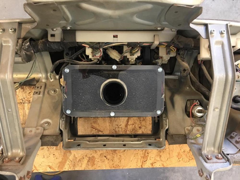

October 4, 20204 yr comment_607239 @qz16 - I am starting down the path of a full ground-up restoration of my '73 (sort of) 240Z. I've removed the dash and can now see the somewhat of a disaster the heater box and the AC system is and will be to restore. I like the compactness of the VintageAir Gen 2 Mini, however, buried in your description is the statement "Also, you need to seal off the cowl vent because there is no provision for the vintage air system to utilize that vent. The only fresh air vent system that you will have will come from the vents on the driver and passenger side which are controlled by individual mechanical cables.". The mini shows 3 oval outlets on the top. The right and left obviously get routed thru hoses to the right and left dash vents but why do you say there is no ability to use that middle vent? The original plastic piece that connects the metal center dash vent housing to the original heater box could be cut at 45 degrees and reglued so the outlet faces downwards at 90 degrees and should be pointing, pretty much, at the middle outlet. I'm making assumptions here based on your photos of the unit's placement as you didn't include any photos of how you connected up the hoses nor did you talk about it other than the above referenced statement. If you didn't make use of that middle dash vent what did you do with that middle port on the Gen 2? Link to comment https://www.classiczcars.com/forums/topic/61181-vintage-air-gen-ii-mini-install/?&page=2#findComment-607239 Share on other sites More sharing options...
October 4, 20204 yr comment_607240 I did use that vent for the centre stack on the 280. Works perfect. Link to comment https://www.classiczcars.com/forums/topic/61181-vintage-air-gen-ii-mini-install/?&page=2#findComment-607240 Share on other sites More sharing options...
October 4, 20204 yr comment_607241 The fresh air vent on the cowl is not used as the Gen II system uses the condenser to remove condensation from the recirculated air in the cabin. Link to comment https://www.classiczcars.com/forums/topic/61181-vintage-air-gen-ii-mini-install/?&page=2#findComment-607241 Share on other sites More sharing options...
