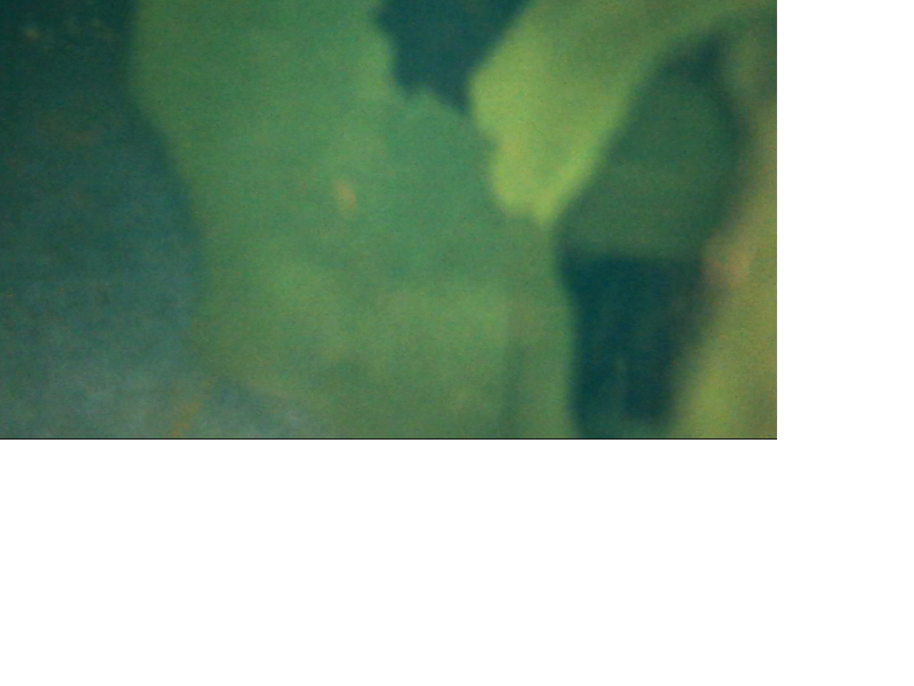

January 9, 20196 yr Author comment_565536 Thanks, I appreciate it. This weekend i'll be dropping the tank and sending it to a radiator shop. I didn't want to do this job but i'm just being lazy lol!! i'll keep you guys updated! I attached the pic, hopefully you can see the large lining flakes. Edited January 9, 20196 yr by hatepotholez pic modified Link to comment https://www.classiczcars.com/forums/topic/61188-no-fuel-going-to-rear-carb/?&page=2#findComment-565536 Share on other sites More sharing options...
