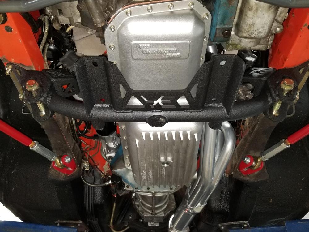

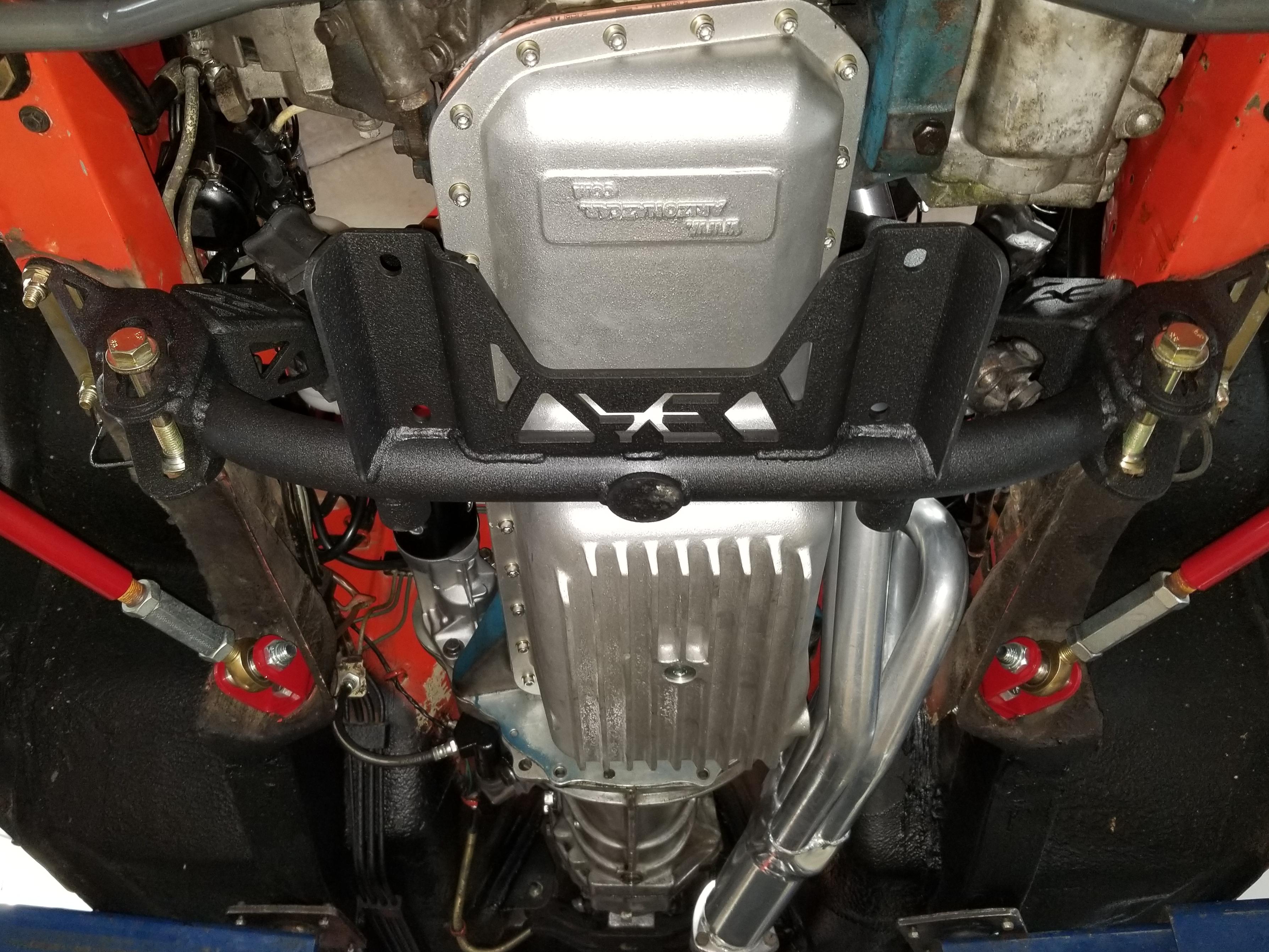

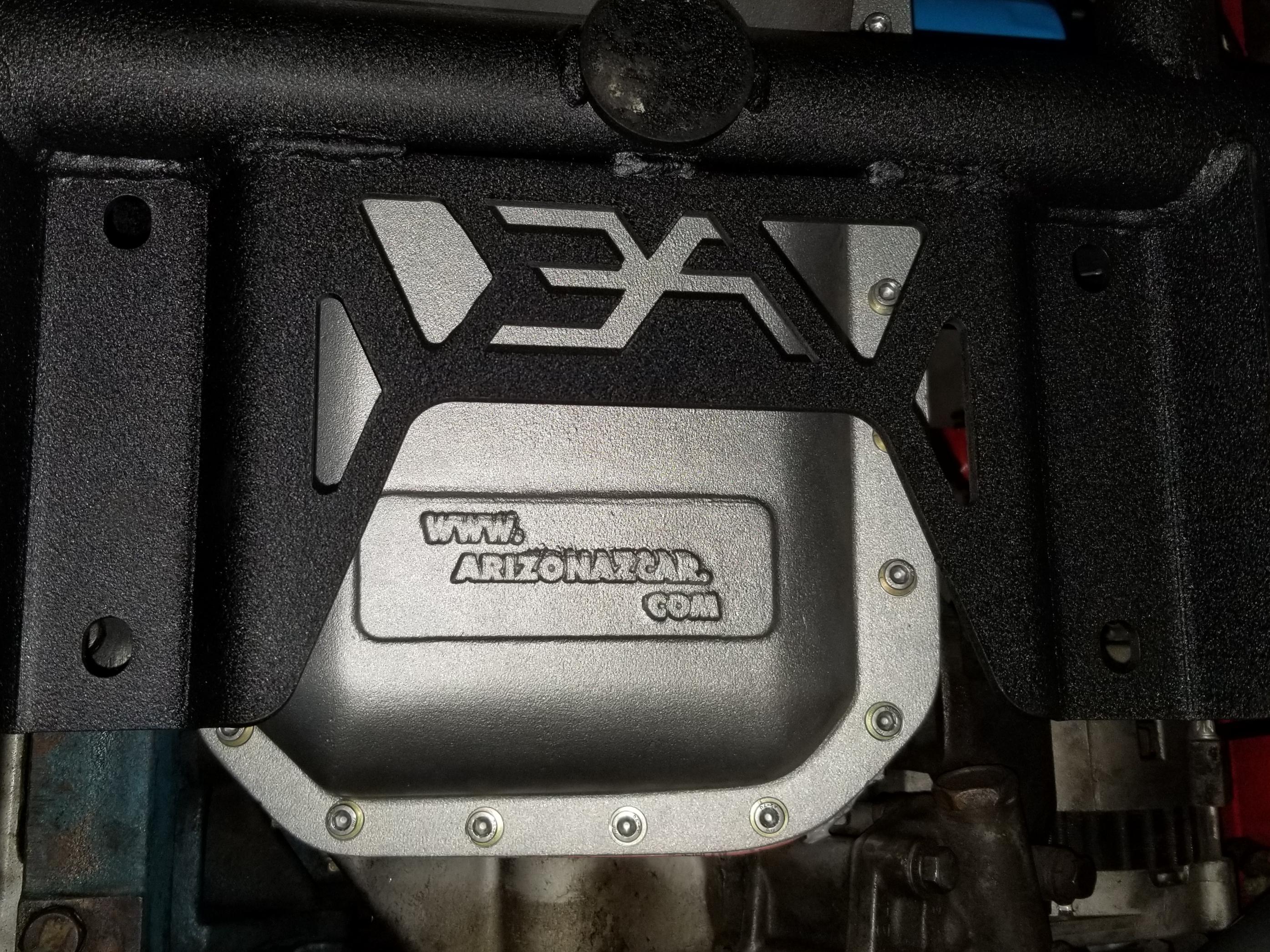

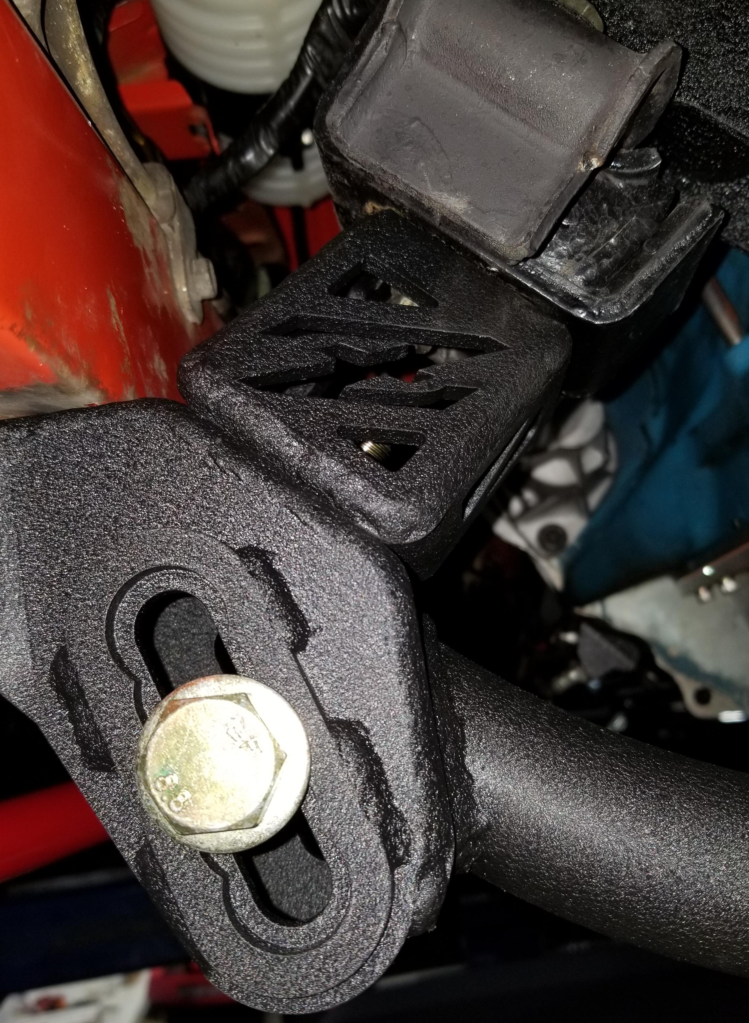

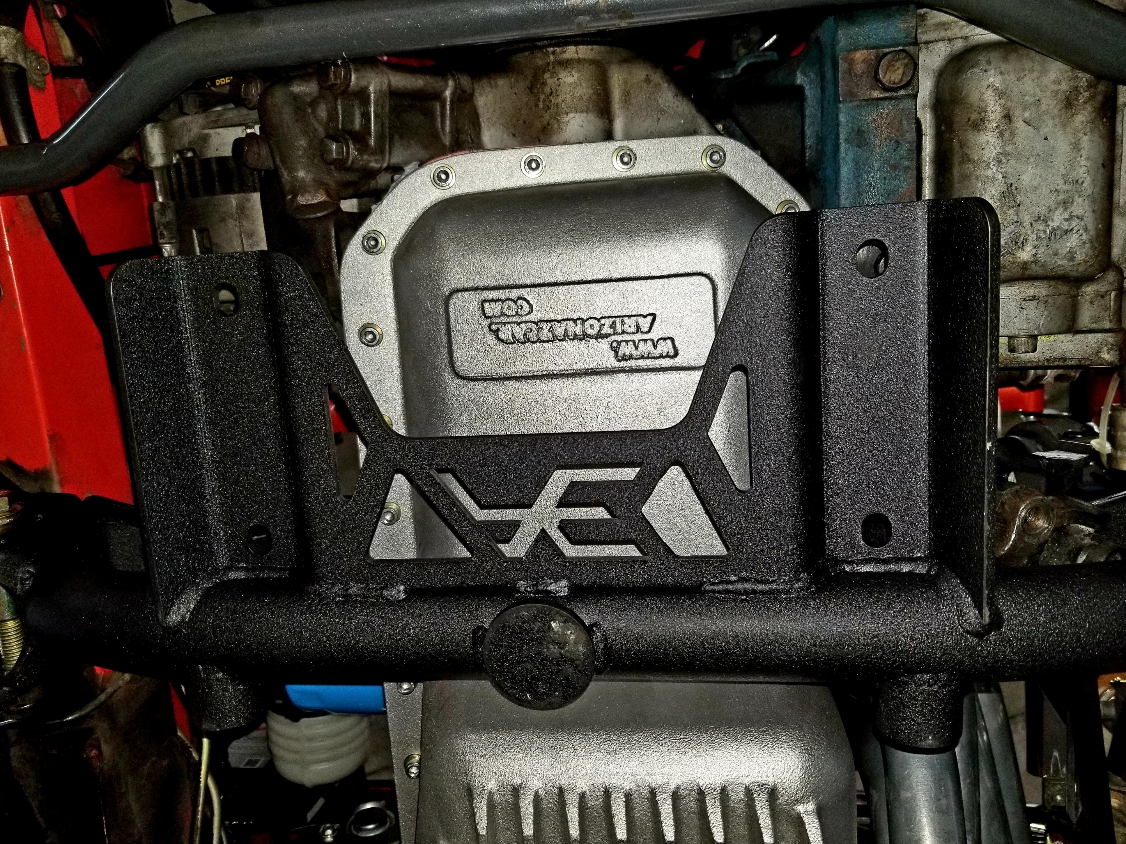

February 26, 20196 yr Author comment_569500 Update: I decided to upgrade to a tubular crossmember beautifully designed by Apex Engineered. I also purchased new tie rods and steering knuckles from them but will not receive those for another 2 to 3 weeks. I changed my banged up OE oil pan for a cast aluminum one from Arizona Z Car. With the crossmember and oil pan in hand we put the car up on a 2 post lift and held up the engine from the bottom with 3 heavy duty adjustable stands. I did let a pro like Erick Pons at "Z Pons Auto Service" here in Miami do the job since the risk of screwing up would prove way too costly. Once the engine was propped up, the crossmember swap went quite easily and took about 2 hours. Changing the oil pan was totally straight forward. I rushed the steering rack to another shop for rebuild and the strut housings, stock lower control arms, new SS splash pan and brake dust covers for media blast and powder coating. Should have all the parts back for assembly by next week but here are some progress pics.   Link to comment https://www.classiczcars.com/forums/topic/61198-engine-lift-for-front-cross-member-removal/?&page=2#findComment-569500 Share on other sites More sharing options...

February 27, 20196 yr comment_569539 LOL!!  Nice parts! So... Other than the obvious "because you can", is there a reason you changed the cross member and the oil pan? Link to comment https://www.classiczcars.com/forums/topic/61198-engine-lift-for-front-cross-member-removal/?&page=2#findComment-569539 Share on other sites More sharing options...
February 27, 20196 yr Author comment_569553 23 hours ago, Captain Obvious said: LOL!!  Nice parts! So... Other than the obvious "because you can", is there a reason you changed the cross member and the oil pan? Ahoy there, Cap'n! The original plan was to take the stock cross member out to repair it (dented by PO, some rust and 40 years of wear) and powder coat it while the engine was somewhat perilously supported from beneath (see previous posts) . This had to be a quick operation to reduce risk but the repair /powder coat process would take a week to 10 days and I failed to find another adequate stock cross member and have it ready before the swap. The only one in great shape that I could find was priced at $1,000! I stumbled upon the Apex Engineered products, was very impressed with their quality and thus decided to upgrade to a stronger, more modern tubular steel design for about $495. By having the Apex unit at hand once the car was suspended on the lift, the engine was resting on stands only for a couple of hours while we did the swap. The stock oil pan was also dented (quite heavily) and a similar "improve rather than repair" rationale prevailed. This isn't an early series 1 car so I've taken several similar liberties throughout the build.  Edited February 28, 20196 yr by dmorales-bello Link to comment https://www.classiczcars.com/forums/topic/61198-engine-lift-for-front-cross-member-removal/?&page=2#findComment-569553 Share on other sites More sharing options...
