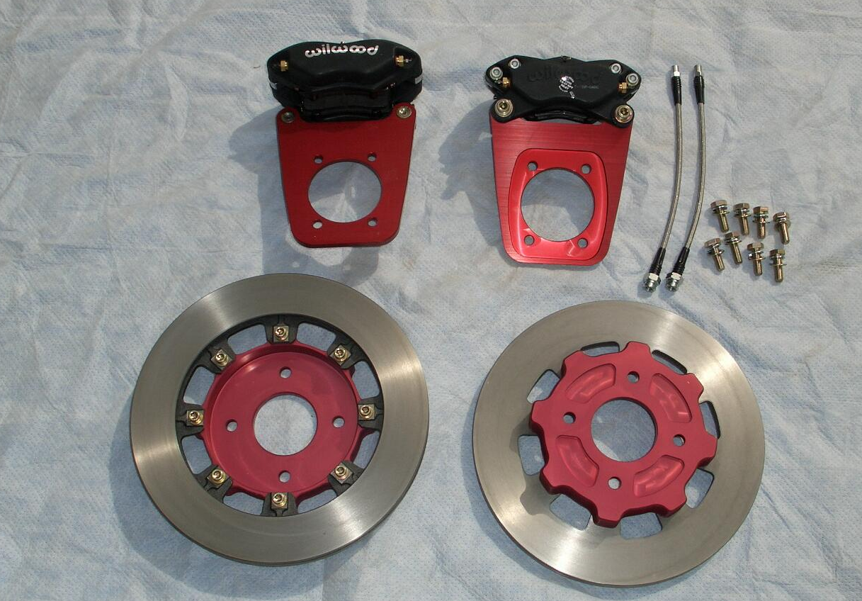

December 12, 20186 yr Author comment_563636 I did take a look at thier stuff before pulling the trigger on silvermine. Didn't notice the e brake functionality add on. Too late now! Brakes have shipped. And for the guys interested in model etc for the brakes, i asked Edan what they are for future pad replacement reasons... As followsstage 4 front kit uses 1991 toyota 4runner v6 caliper pads. and 1983 300zx n/a front rotorsstage 4 rear uses 2006 mustang gt rear caliper pads and re drilled rotorsSent from my SM-N950W using Tapatalk Link to comment https://www.classiczcars.com/forums/topic/61233-z-car-store-vs-motorsport-rear-disc-kit/?&page=3#findComment-563636 Share on other sites More sharing options...

December 12, 20195 yr comment_589149 On 12/12/2018 at 12:33 PM, wheee! said: Have you considered the Arizona Z Car setup? $795 and he has a new setup for using the Wilwood rear park brake too for this kit. I have a set of these and they are awesome looking units. I am waiting for the park brake setup to arrive to install them. The fronts are already on my car. Link to comment https://www.classiczcars.com/forums/topic/61233-z-car-store-vs-motorsport-rear-disc-kit/?&page=3#findComment-589149 Share on other sites More sharing options...
December 12, 20195 yr comment_589150 I am considering the Arizona Zcar kit. 1 year later how are they performing for you? Link to comment https://www.classiczcars.com/forums/topic/61233-z-car-store-vs-motorsport-rear-disc-kit/?&page=3#findComment-589150 Share on other sites More sharing options...
December 12, 20195 yr comment_589151 Well, my car is the perennial garage queen and has still not rolled under power since I bought her. I eventually gave up on AZC ever completing a rear park brake kit. All I ever got from Dave were promises of “two more weeks”...I worked with Edan to develop a rear park brake kit using his parts and the AZC rears. It took a bit of work, but now I have the best of both worlds! Link to comment https://www.classiczcars.com/forums/topic/61233-z-car-store-vs-motorsport-rear-disc-kit/?&page=3#findComment-589151 Share on other sites More sharing options...
