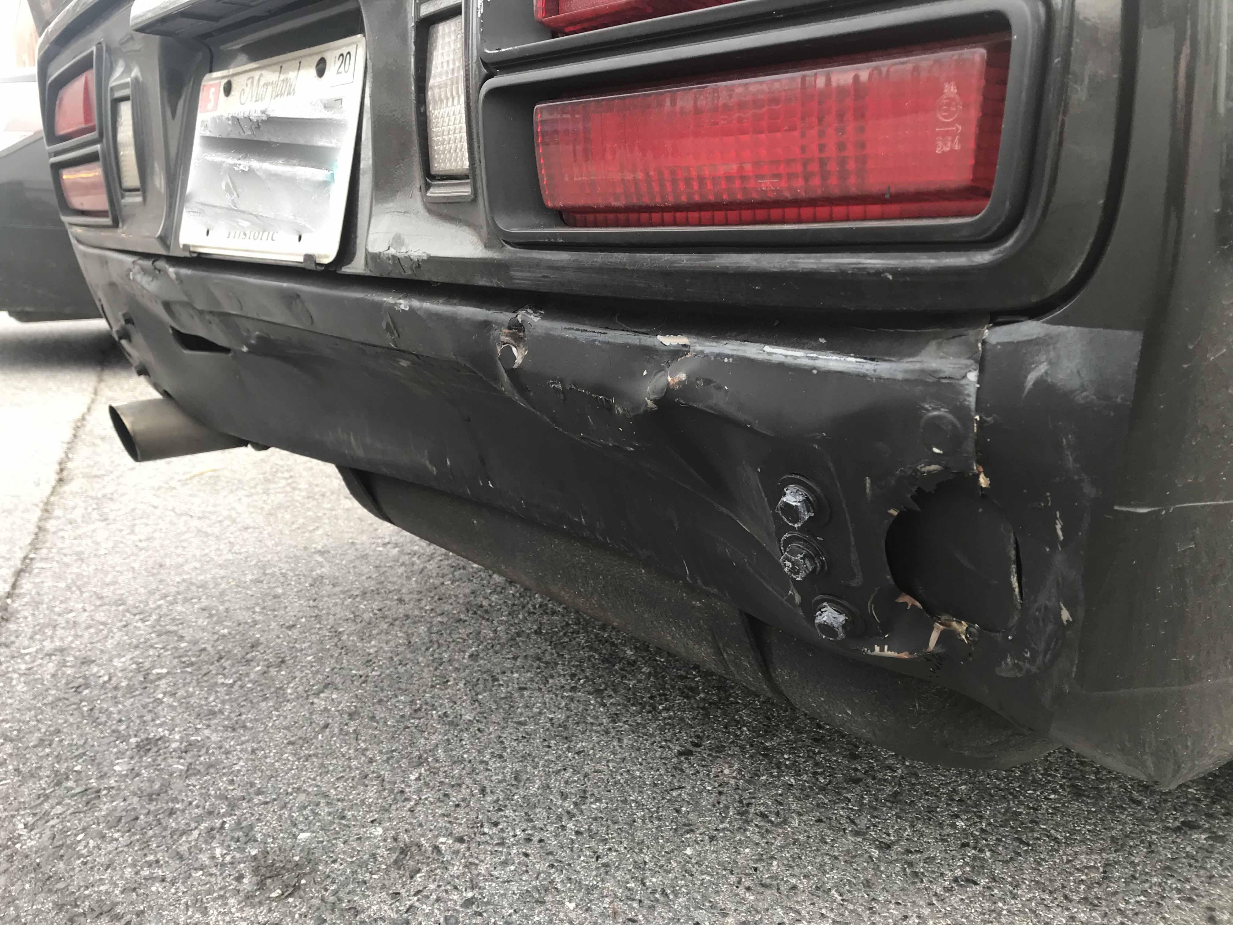

Posted December 11, 20186 yr comment_563537 Due to recent accident where I was rear ended, I'm looking for a 280z rear valence and passenger side bracket that attaches to valence and frame. Possibly the passenger side rear taillight panel if I can't smooth out the one I have. Right now, I'm only finding 240z valences out there, which could work, if that's my only option. Also any good body shop recommendations in central Maryland (West of Baltimore). Need to straighten out and square off the body panel just under the tail lights that the valence is welded to. From the pictures, you can see how it has been pulled down as you move from the drivers to the passenger side. See attached pictures. Thanks. Link to comment https://www.classiczcars.com/forums/topic/61238-78-280z-rear-endedneed-parts/ Share on other sites More sharing options...
December 12, 20186 yr comment_563589 I don't think I have what you need but I have found that is a difficult place to put back right. There is a lot of really solid metal right there. My car took a similar shot but less and I have had a hard time making it right. You will want to pull the tank or have the shop do it to have a good shot at getting it back the way it needs to be Look on "Car-part.com" and find yards with the right year cars. Then call them and tell them what you want. I wouldn't search for the rear valance. I would search for rear quarters. If they have good quarters they most likely will have a good rear pan. Might take some leg work but you should be able to find one Link to comment https://www.classiczcars.com/forums/topic/61238-78-280z-rear-endedneed-parts/#findComment-563589 Share on other sites More sharing options...

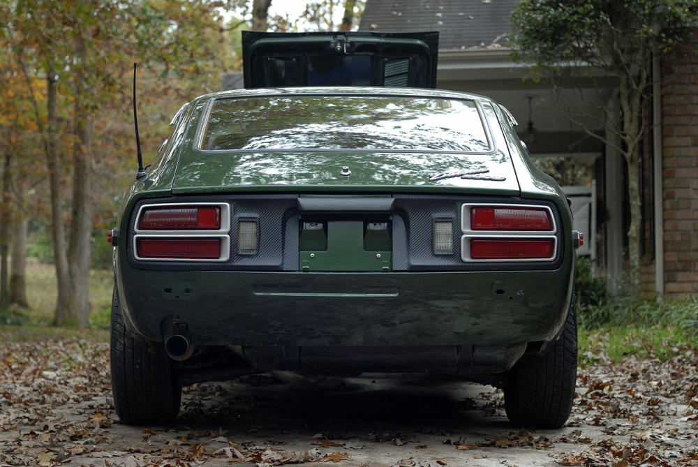

December 12, 20186 yr comment_563595 The rear valance was rusted on mine when I was getting mine ready for paint.  The guy doing the welding said it would be better to just replace it so I was kind of in the situation you are in. I really couldn't find a 77' valance in the time frame I was working in so opted for the readily available one from Banzai motor works.  It came as a stamped piece of metal but it was flat and needed to be shaped into that curve that it has which added more time and effort, not to mention that the bumper bracket holes do not line up the 280 holes.  None of those things were a deal breaker to me since I don't have a rear bumper although they are something to consider and compare too the time and cost of repairing what you've got.  Link to comment https://www.classiczcars.com/forums/topic/61238-78-280z-rear-endedneed-parts/#findComment-563595 Share on other sites More sharing options...

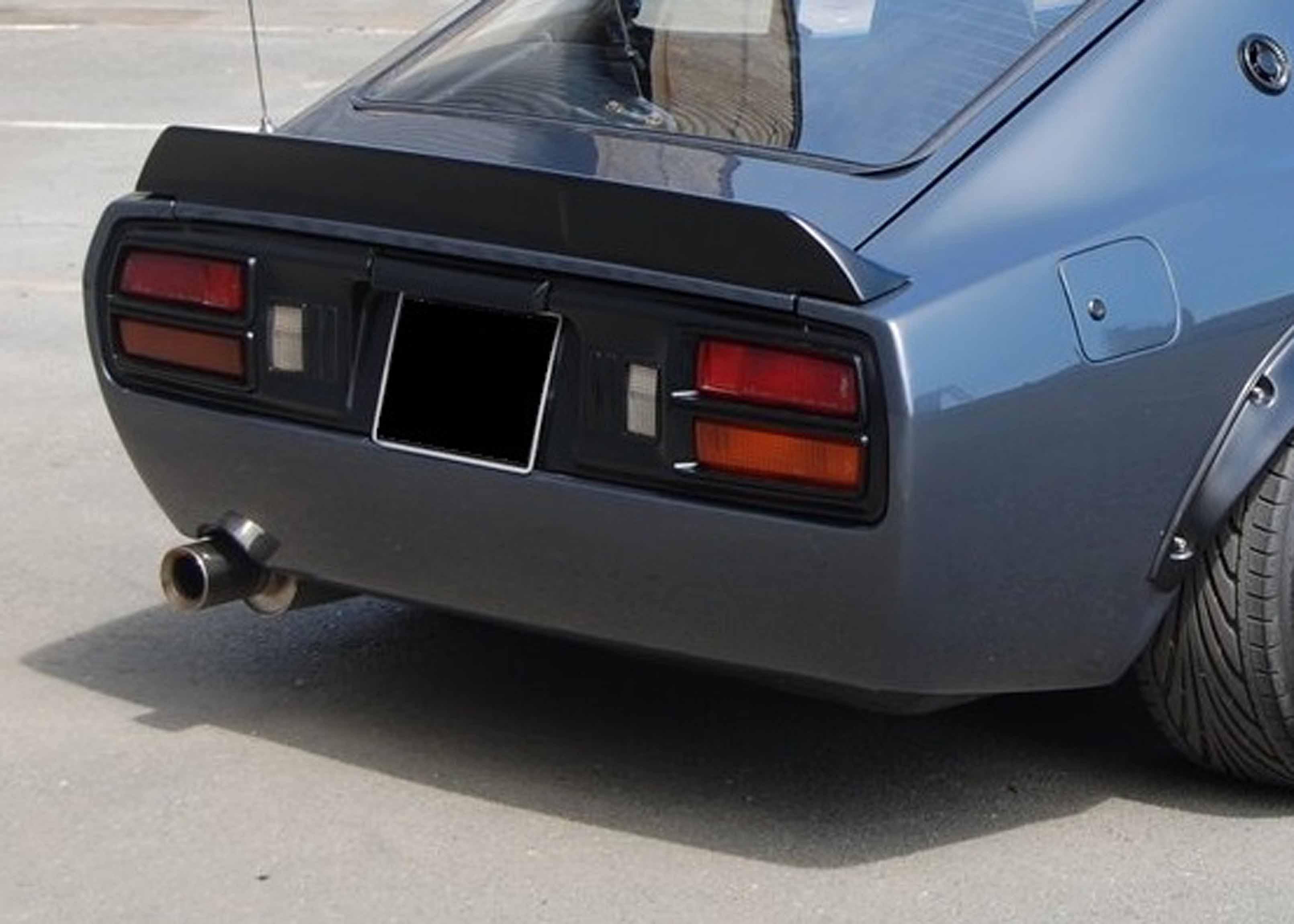

December 12, 20186 yr Author comment_563609 Thanks to both for your responses! I did reach out to Bonzai Motorworks yesterday afternoon and he said he did not have these parts. I do like the car-part.com reference. I didn't know about that site before. Nobody seems to have the 280Z panel at all. gwri8, thanks so much for the info on the bumper bracket locations and the need to curve the piece as well as the picture! Great looking car! I did come across a place that has the option to give me one identical to your piece in the picture or to get one that is the same overall shaped piece but is a totally blank piece (nothing stamped into it). With the blank piece, I'd have to cut out for the exhaust pipe. With either piece, I'd have to close up the bumper shock holes that are partially cut into the quarter panels on either side. I imagine it would look similar to the attached image when completed with the blank piece. gwri8, could you tell me where you got those tail light panels? Love that look! Ultimately, I won't be going with the bumper either, so no big deal going with the 240 style valence. I'd just like to protect the gas tank more. Maybe with a steel plate between the tank and valence and/or a tank that wouldn't rupture if crunched in an accident but still be able to mount in the same location. But that's another topic, I guess. Link to comment https://www.classiczcars.com/forums/topic/61238-78-280z-rear-endedneed-parts/#findComment-563609 Share on other sites More sharing options...

December 12, 20186 yr comment_563623 My rear panels are nothing special.  It's just a vinyl wrap over stock panels. It was hard to get right with all the complex curves on those but was realativly inexpensive .  Now they are about 3 yrs old and I should probably re-do them. Vinyl is temporary and doesn't last so I try to do something else next time. The tail light trim pieces are painted bright silver with a clear coat. I agree with everything Patcon suggested.  If you want more protection back there, that's what that the original bumper (often referred to as the park bench) was for. Link to comment https://www.classiczcars.com/forums/topic/61238-78-280z-rear-endedneed-parts/#findComment-563623 Share on other sites More sharing options...

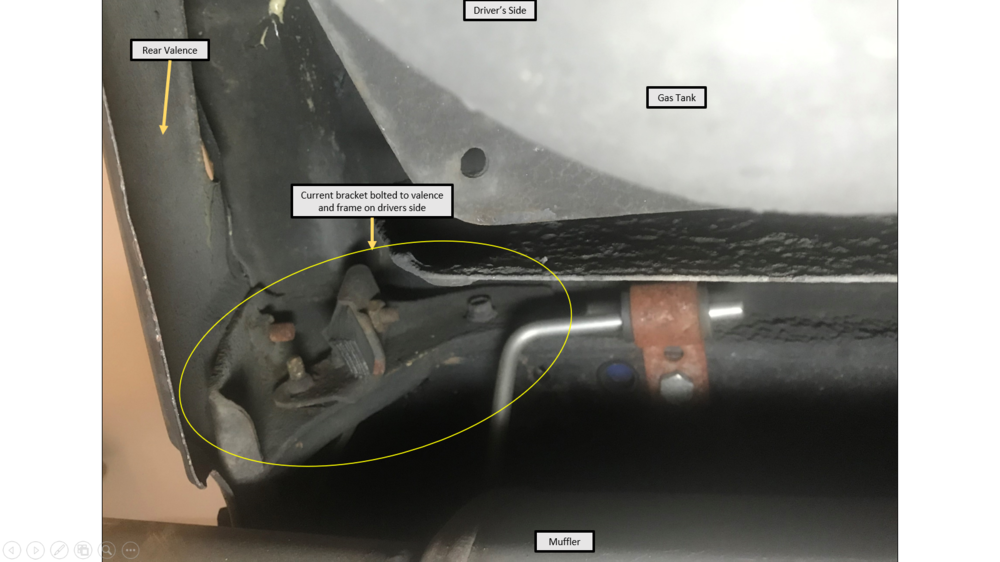

December 12, 20186 yr Author comment_563631 AlbatrossCafe: Maybe, maybe not. They were rusted out pretty bad. Plus, I like that booty without the park bench ? . Mark/Patcon, I was thinking of slightly relocating the current brackets that are currently bolted to the original valence and are attached to the frame on either side (or making new ones) and bolting a piece of thick flat steel just behind the valence, in front of the gas tank straps. That way, I could unbolt them if I needed to get to the tank in the future. Link to comment https://www.classiczcars.com/forums/topic/61238-78-280z-rear-endedneed-parts/#findComment-563631 Share on other sites More sharing options...
December 12, 20186 yr comment_563650 Bill, those valence brackets that you circled are welded on as well as bolted on, on my 77/280. I removed all the bolts but I think there is a weld somewhere on the top that I can't get to. Just thought I would give you a heads up, I hit it a few times with a BFH and couldn't budge them. Link to comment https://www.classiczcars.com/forums/topic/61238-78-280z-rear-endedneed-parts/#findComment-563650 Share on other sites More sharing options...

December 18, 20186 yr Author comment_563969 grannyknot, thanks for the heads up on the brackets. Maybe I can work around them or figure how to get them out somehow. Patcon, I think we will look into a fuel cell that can go roughly in the same location as the original tank. Starting from ground zero on that. The other person's insurance came through today and cut us a check to fix the car. Their body shop didn't feel comfortable working on the car so I may do a combination of some work ourselves (gas tank)Â as well as searching out a reputable body shop to do the body work and painting. We will be ordering a 240Z panel from the Z Store as it seems to be a good quality piece (16 guage steel). Like that look (like gwri8's car) vs the smooth look with this car! Thanks for all your help! Link to comment https://www.classiczcars.com/forums/topic/61238-78-280z-rear-endedneed-parts/#findComment-563969 Share on other sites More sharing options...
