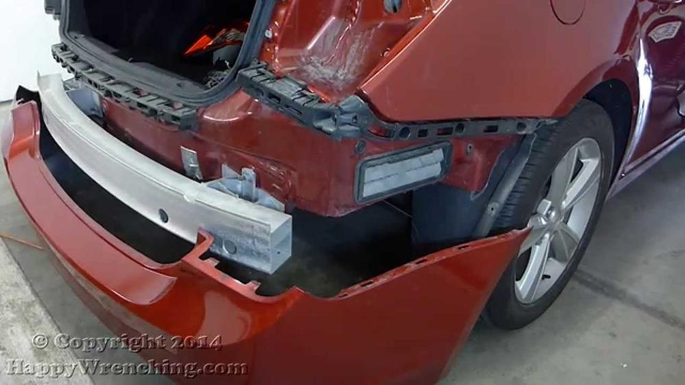

Pretty much all modern cars have aluminum or steel bars under the bumper cover. One of the problems with the z is not the bumpers. It's where the bumpers mount. If the bumpers were super strong, the force would just be transferred to the chassis and hatch floor. It would do alot more damage if it were transferred further into the car. Even the blue car above are starting to be viable for rebuilding due to the price of these cars.
39 minutes ago, siteunseen said:
yes!  My 2000 Camry has a very similar aluminium bumper like this Cruz under the bumper cover.
That is what I thought, they're just "hidden" beneath the cover.
