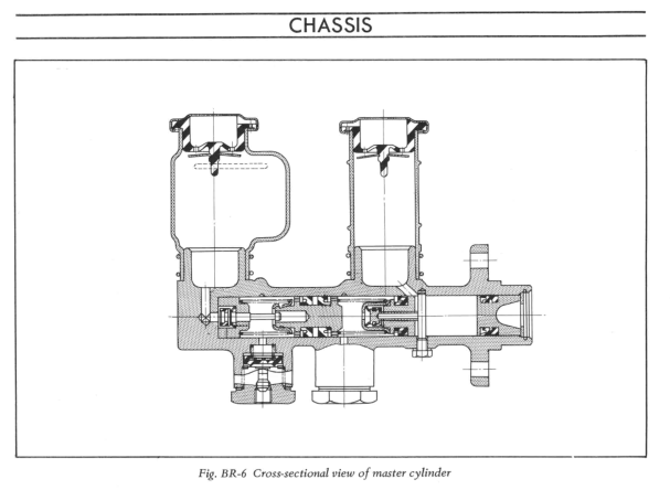

Seems like you might just have a piece of seal stuck in your rear orifice.  Ha ha.  Couldn't resist.  But it seems possible, based on the picture, below.  That would give front pressure only.  This picture is from the 1970 FSM, available from the site's Download area.
Pretty easy to remove the MC and look around.  The MC is easy to take apart also.

Thanks for the pic! I have two old Chilton manuals that cover 240 to 260 and 240 to 280, also a Clymer covering 240 to ZX - none of them shows cutaway of early MC (To be fair, Clymer shows the most accurate diagram of early Tokico MC.)  Where did you find this pic?
Re: "Rear Orifice" (not to be confused with PC virus "Back Orifice") If that's the little plunger under the "dome" on the end of the rear piston, then that was the problem! It wasn't a stray rubber fragment, though... It appears these parts are anodized aluminum, and the anodization was chaffed off the plunger right behind the rubber seal. So that's where some sort of corrosion developed and the plunger was stuck/glued about 2mm away from being closed.

I meant the hole that the fluid passes through when the piston pressurizes it.  Not clear (to me) what plunger you're describing.  Sounds like you had already taken it apart, unless you work really fast.

There's a check-valve built into the (front of) rear piston. It's supposed to close when applying brakes. When pedal is released, if there's less pressure in front of piston, fluid can move from slotted part of piston (reservoir) forward, past the front seal (of rear piston). This was stuck  open.
I tried to dismantle the front&rear orifice, but don't have a bench or vice and was never able to unscrew the large fittings.
Thank you for the that link Zed Head - I'll check it out (later, when not constrained to phone GUI).
Thanks for getting back with the results.  Looking at the diagram and thinking hydraulically I can't see how the valve sticking open would block pressure from the rear system.  Unless the seal was sitting over the orifice, blocking it, and the fluid was just passing through the open valve to pressurize the front system.  Seems like an open valve should have just acted like a single piston system.
