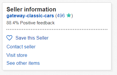

I would avoid these gateway guys.  Full of BS.  My 76 has factory air.  Mag wheels are not the single rarest option.  "Black Pearl" just means it has black paint.  That's it, black paint.  I think that somebody else coined the "Black Pearl" name too, it might not be a Nissan thing.  It's a gimmick, wherever it came from.  No info about the car either just a tedious list of pictures.

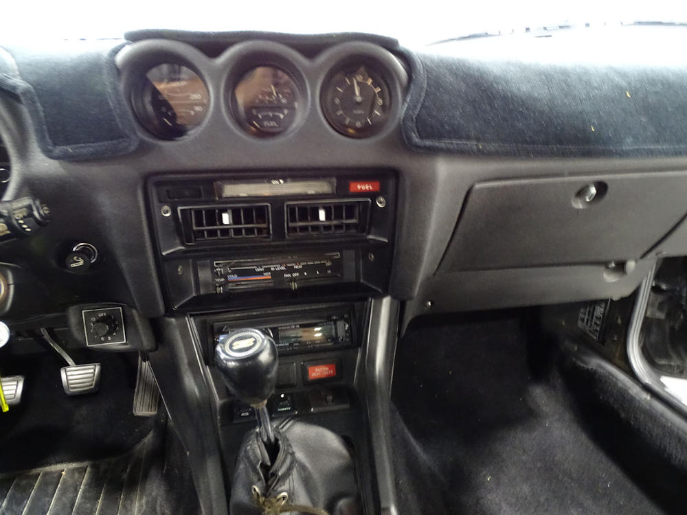

Uhhh.... About the A/C. That car left the factory without A/C. It's got the non-A/C climate control head unit.
And there's a suspicious looking knob near the driver's right knee? I suspect that's the control for the (clearly aftermarket installed) A/C system:

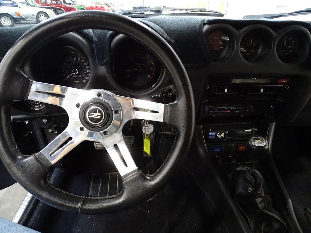

And something else that caught my eye... The tach says 1K, but the temp, oil pressure, and fuel are off scale to the left like the engine isn't running? Either the engine is stone cold, running on vapors from an empty tank and the mains are shot and can't generate any oil pressure, or... The tach is stuck:
