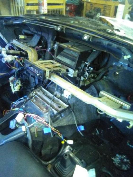

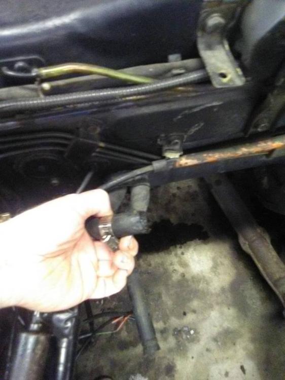

August 6, 20195 yr comment_581296 Began an archeological dig to replace the heater hoses. Sent from my Coolpad 3310A using Tapatalk Link to comment https://www.classiczcars.com/forums/topic/61322-2019-what-did-you-do-towith-your-z-today/?&page=17#findComment-581296 Share on other sites More sharing options...

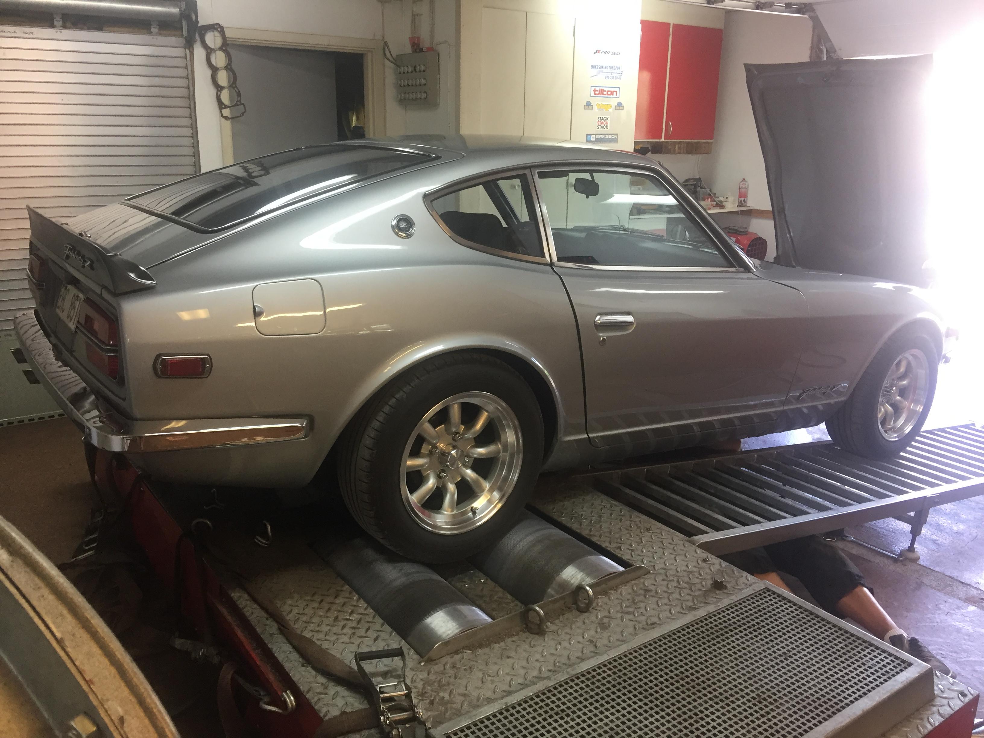

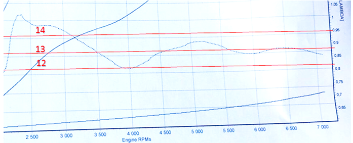

August 7, 20195 yr comment_581409 Went for a 230km “hot as hell” trip to get the engine tuned on a dyno then the same “hot as hell” 230km trip home again....damn these cars aren’t made for driving in the sun. Found some pics on the web from last car meet when waiting for the tuner. Link to comment https://www.classiczcars.com/forums/topic/61322-2019-what-did-you-do-towith-your-z-today/?&page=17#findComment-581409 Share on other sites More sharing options...
August 7, 20195 yr comment_581410 Very nice (except for the heat) but no dyno results? Link to comment https://www.classiczcars.com/forums/topic/61322-2019-what-did-you-do-towith-your-z-today/?&page=17#findComment-581410 Share on other sites More sharing options...
August 7, 20195 yr comment_581432 Less power on this dyno but i think this dyno is very accurate (have been on two other dynos before). But i have a nice curve. Edited August 7, 20195 yr by moelk Link to comment https://www.classiczcars.com/forums/topic/61322-2019-what-did-you-do-towith-your-z-today/?&page=17#findComment-581432 Share on other sites More sharing options...

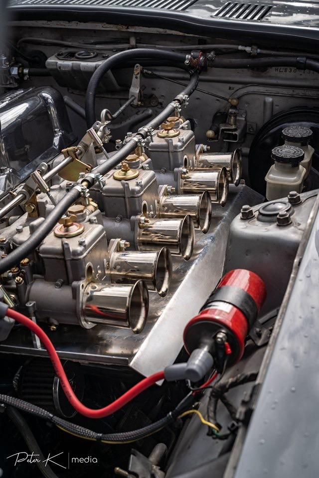

August 7, 20195 yr comment_581434 194 HP is nice! @blodi had similar with 45's, cam, and L28. Edited August 7, 20195 yr by 240260280 Link to comment https://www.classiczcars.com/forums/topic/61322-2019-what-did-you-do-towith-your-z-today/?&page=17#findComment-581434 Share on other sites More sharing options...

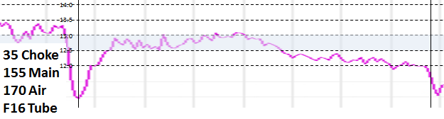

August 7, 20195 yr comment_581436 @moelk Nice A/F. What jets, chokes, fuel level etc are you using? Looks like they had smoothing on. Very similar to @blodi's Edited August 7, 20195 yr by 240260280 Link to comment https://www.classiczcars.com/forums/topic/61322-2019-what-did-you-do-towith-your-z-today/?&page=17#findComment-581436 Share on other sites More sharing options...
August 7, 20195 yr comment_581446 1 hour ago, 240260280 said: @moelk Nice A/F. What jets, chokes, fuel level etc are you using? Looks like they had smoothing on. Very similar to @blodi's Lowspeed 55 F8 Main155 Air 160 Tube F16 Acc 45 Choke 36 But i had some problems at around 2500-3000rpms and the tuner adjusted something that made it a bit better will check tomorrow. Link to comment https://www.classiczcars.com/forums/topic/61322-2019-what-did-you-do-towith-your-z-today/?&page=17#findComment-581446 Share on other sites More sharing options...

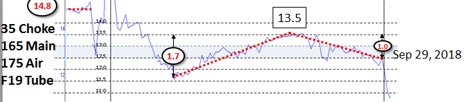

August 8, 20195 yr comment_581455 Here is @blodi's similar config to yours: It is fairly flat and around 12-13 like yours but a big dip to ~ 10 at the start. Link to comment https://www.classiczcars.com/forums/topic/61322-2019-what-did-you-do-towith-your-z-today/?&page=17#findComment-581455 Share on other sites More sharing options...

August 9, 20195 yr comment_581575 On 8/8/2019 at 2:54 AM, 240260280 said: Here is @blodi's similar config to yours: It is fairly flat and around 12-13 like yours but a big dip to ~ 10 at the start. My tuner played with the lowspeed to get the afr a bit better from the start, sadly i don’t know what he put in but it made it a bit better. Link to comment https://www.classiczcars.com/forums/topic/61322-2019-what-did-you-do-towith-your-z-today/?&page=17#findComment-581575 Share on other sites More sharing options...
