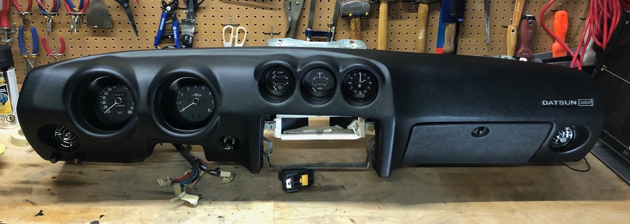

11 hours ago, YZFMax said:
Installed the dash this weekend.  Overall, it's a great fit and had no issues with the fitment.  I have to say, this is a high quality reproduction.
The wiring was all labelled before I removed the dash, so it was just a matter of plugging it into the right connectors.  While I had the dash out, I also installed the power steering unit and wired this up.
Double checked all my connections and wiring and fired up the car.  Everything worked including the power steering.  So this had been a very productive weekend.
Next weekend I'll complete the centre console, trim and install the bluetooth amp.
