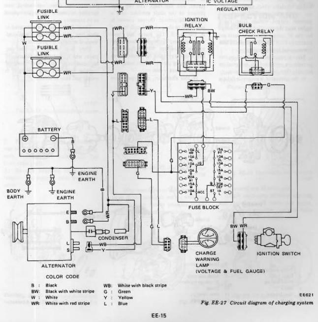

I've done some forum searching and there were some mentions due to the specific gauges not working that maybe the ignition module isn't working right. I can't find one in the FSM. I found reference to ignition coil, which I tested and it's fine.
I finally found the ignition relay after searching the FSMs
At this point I'm thinking I need to test this ignition relay, however I can't find anything in the FSM that will tell me which pin is which nor what readings I should get.

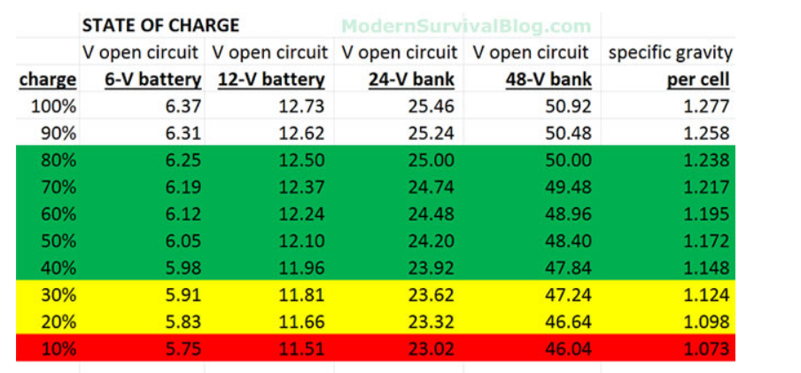

Your voltage numbers are way off, for starters.  Could be that there is a drain somewhere.  Start with a fully charged battery, over 12.6 volts with nothing connected, and see if voltage drops when you connect the cables.  11.3 volts shouldn't even crank the engine.  Something is wrong.  You might just have a failing battery.
https://ussolarinstitute.com/glossary/battery-state-charge/

As for checking the ignition relay... There are two sections to it. One section sends power to a bunch of fuses when the key is turned to the ACC position, and the other section sends power to a bunch of fuses when the key is turned to the next click in the ON position. The click you're hearing when you turn the key to ACC is the first side of the ignition relay, and based on the fact that your heater fan, defroster, and antenna work, that side is working correctly.
The other side of the ignition relay (the side that is engaged with the key in the ON position) powers (among other things), the turn signals. So with the key in the ON position, the turn signals should work. Check for that next time the problem occurs and let us know what you find?
The above is a non-meter required way to check the function of the ignition relay. If, however you have a meter and want to test the relay a little more directly... Measure the voltages on the fuses, You should see the bottom three on the forward column (closest to the firewall) go hot when the key is turned to ACC. Those three, I believe are labeled AIR CON, WIPER, and RADIO.
Then on the next click to ON, you should see the two above that go hot. I believe they are labeled FLASHER and FUEL GAUGE.

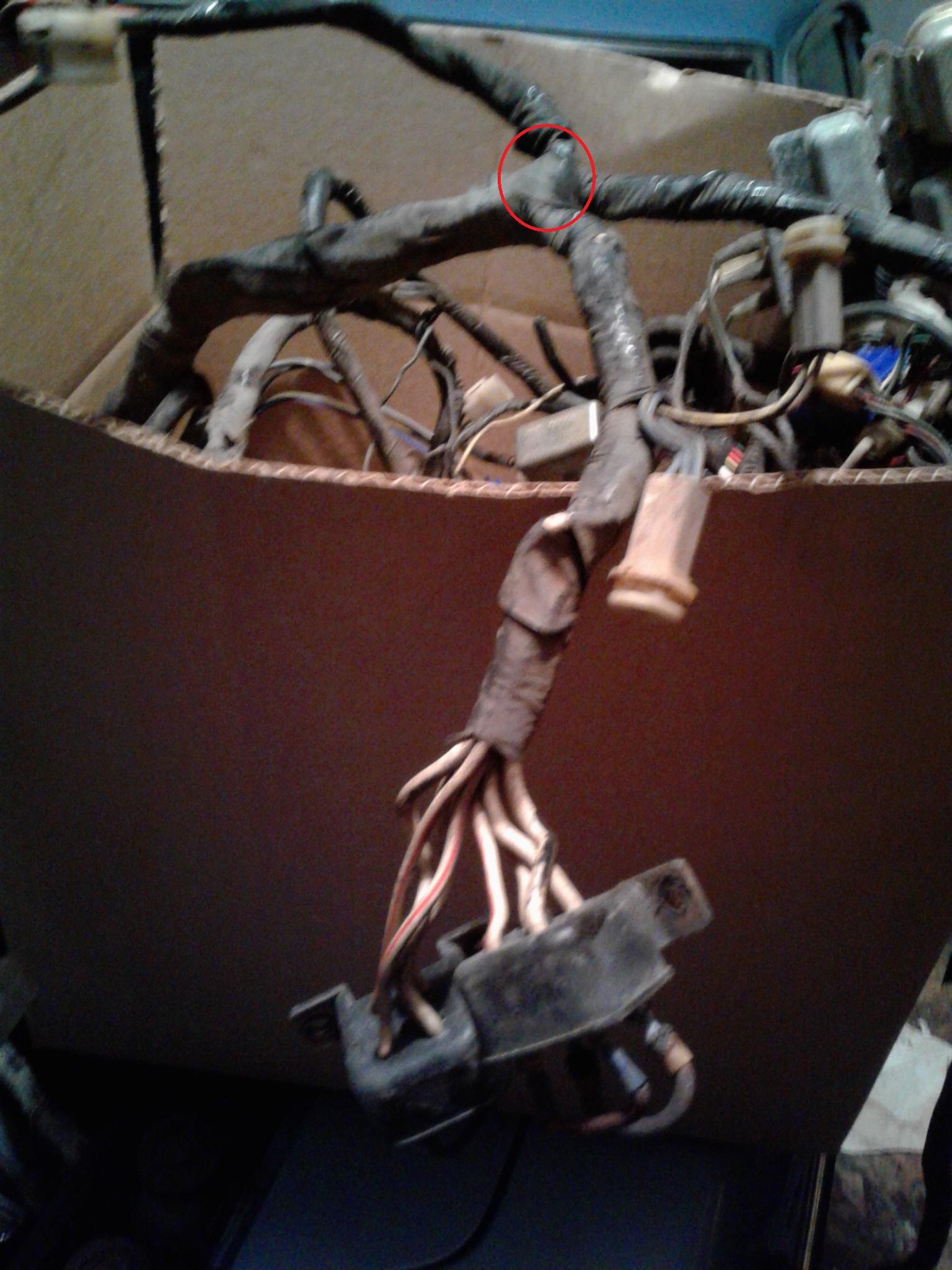

Not to discredit any of the above advise, but from what I have experienced, 80% of the issues arise due to the 'vintage wiring connections' available at the time of production.
First picture shows an unmolested harness from the fusible links to the main harness. The circled area is the highlight of my post.
Unwrapping the harness gave an abundance of gritty, sand type substance. My best guess is that the harness from the fusible link acted as a 'funnel' for atmosphere & water to weep into the harness. Pic #2... As you can see, I have unwrapped more of the 'upper left' harness, which, in reality, feeds from the alternator.

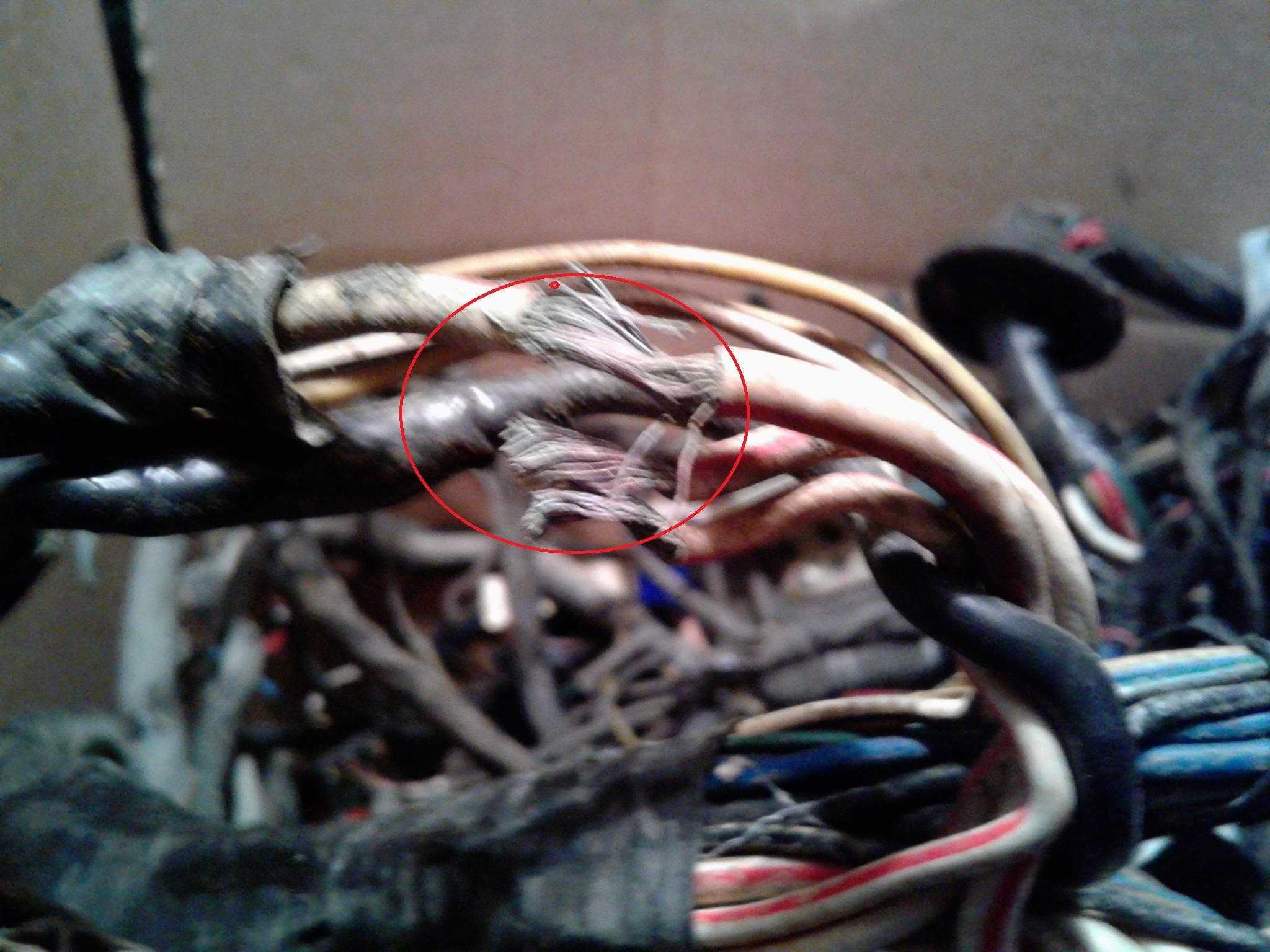

Now, once in that hornet's nest, I discovered why I was having so many electrical issues that I couldn't chase down but to the fusible links, changing them never helped. Pic #3 shows a close up of the factory 'crimp' connection, which is now non-existent.

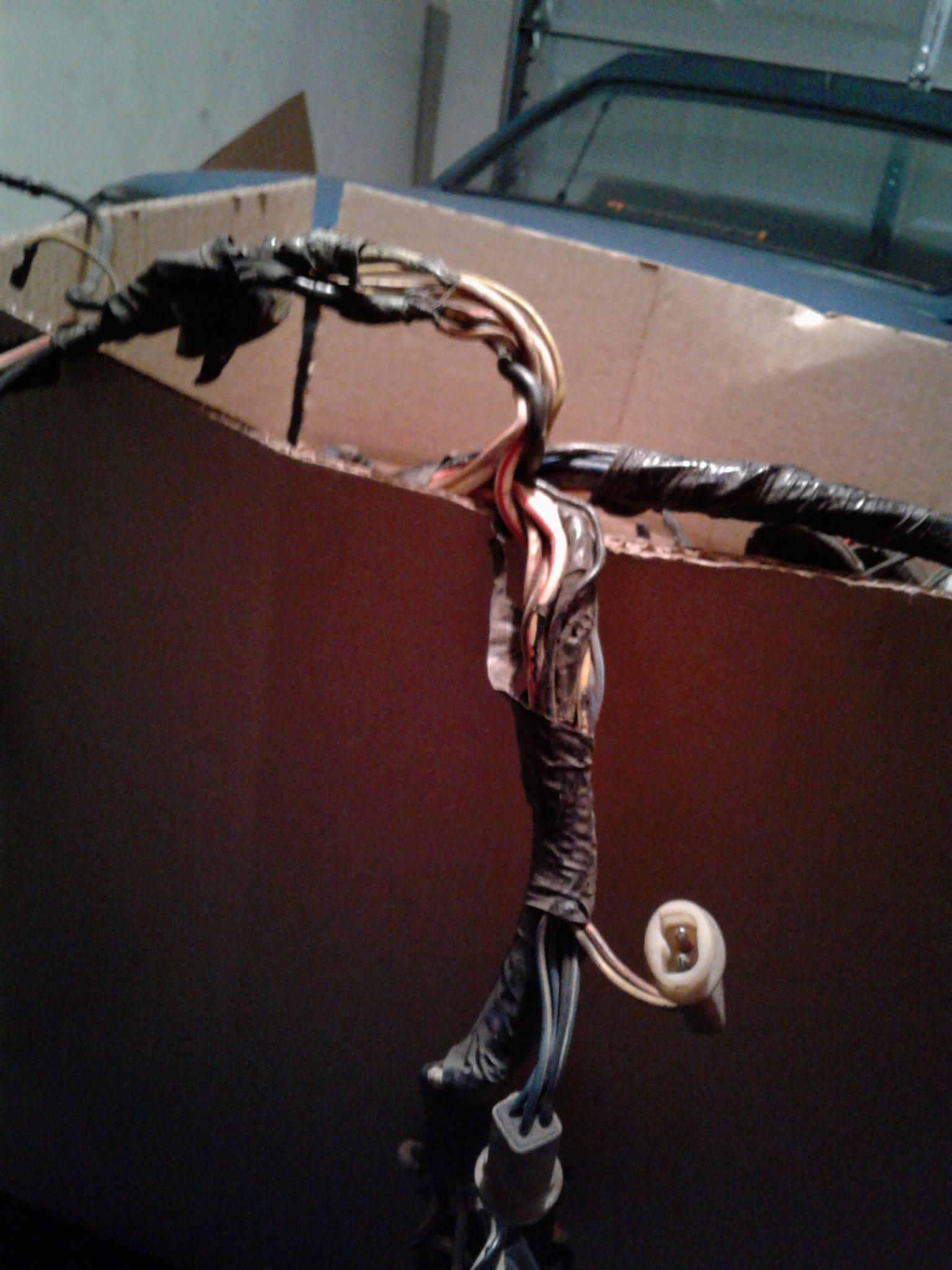

Well, I guess I got a bit of camera shake on that last one, but you can still see the remaining amount of gritty/sand substance left on that part of the harness. The electrical 'connection' was relying on the pressure of the wrapping tape, and, whatever else obtained access..... like gritty sand... as in intermittent...
I have since upgraded my fusible links from the factory to the Caddy Catera Maxi-Fuse setup.  In the OEM configuration, the 3-way (front) connector had 3-80A fuses, so I was assured the assembly could handle whatever the Z could throw at it...

Well I'm not yet ready to condemn the ignition relay. That blinker test was just a quick and dirty way to do a rough test. If the blinkers DID work, then you can be pretty sure that the relay is working. But if the blinkers did NOT work, then there's a number of things that could cause that, including (but not limited to) a bad ignition relay.
In fact, the same (largest) black fusible link that would cause the voltmeter to read zero (or four) would also cause the blinkers to not work as well. (It would also cause the dome light, map light, brake lights, horn, etc. to all fail.)
