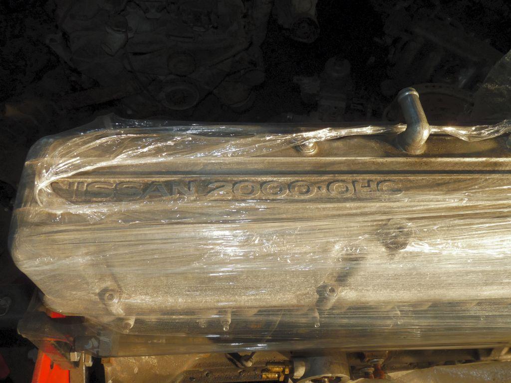

The L24 engine has been replaced with a JDM 2.0 L  with 73 flat top carbs.  The seller hasn't responded to questions of why.  The original block and head come with it but no mention if there is any damage to them.  Also a throttle lever installed even though the VIN is HLS30-04000

As I've posted on BaT, the carburettors appear to be Hitachi HJG38W-8 type, which would be correct for the '74-up Japanese market L20AT engine that this seems to be. They are not North American market 'Flat Top' carburettors.
As for "why?", how about because the owner had the engine available, having taken it out of his Fairlady Z, which had received a modified L24 engine...?

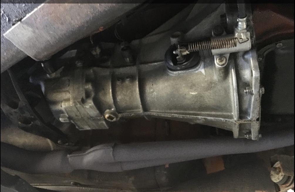

Are you familiar with why the shifter location on this car would be so far forward? Seller doesn’t seem to know what it is. They must of really cut into the tunnel.
The description says that it has been fitted with a 5-speed transmission. If it came from the same source vehicle as the engine (?) then it would be an FS5C71-B, which would require shifter and/or tunnel mods in this 1970 production bodyshell. An FS5C71-A would be a straight fit, so I presume it is a B-type 5-speed.
Looks way to far forward for a Bll type trans.

Alan , you are correct, I see the picture of the car showed in BAT it has the B type transmission which is designed for two-piece casting case while an A type is designed for three - piece .
This car should originally have an A type 4 speed ( spline type ) which is easy for this modify , because  a late 1972 or later B type 5 speed  is a spline type . Just use an existing propeller shaft . However, cutting the floor tunnel /part of  the console is not an easy work for me .
