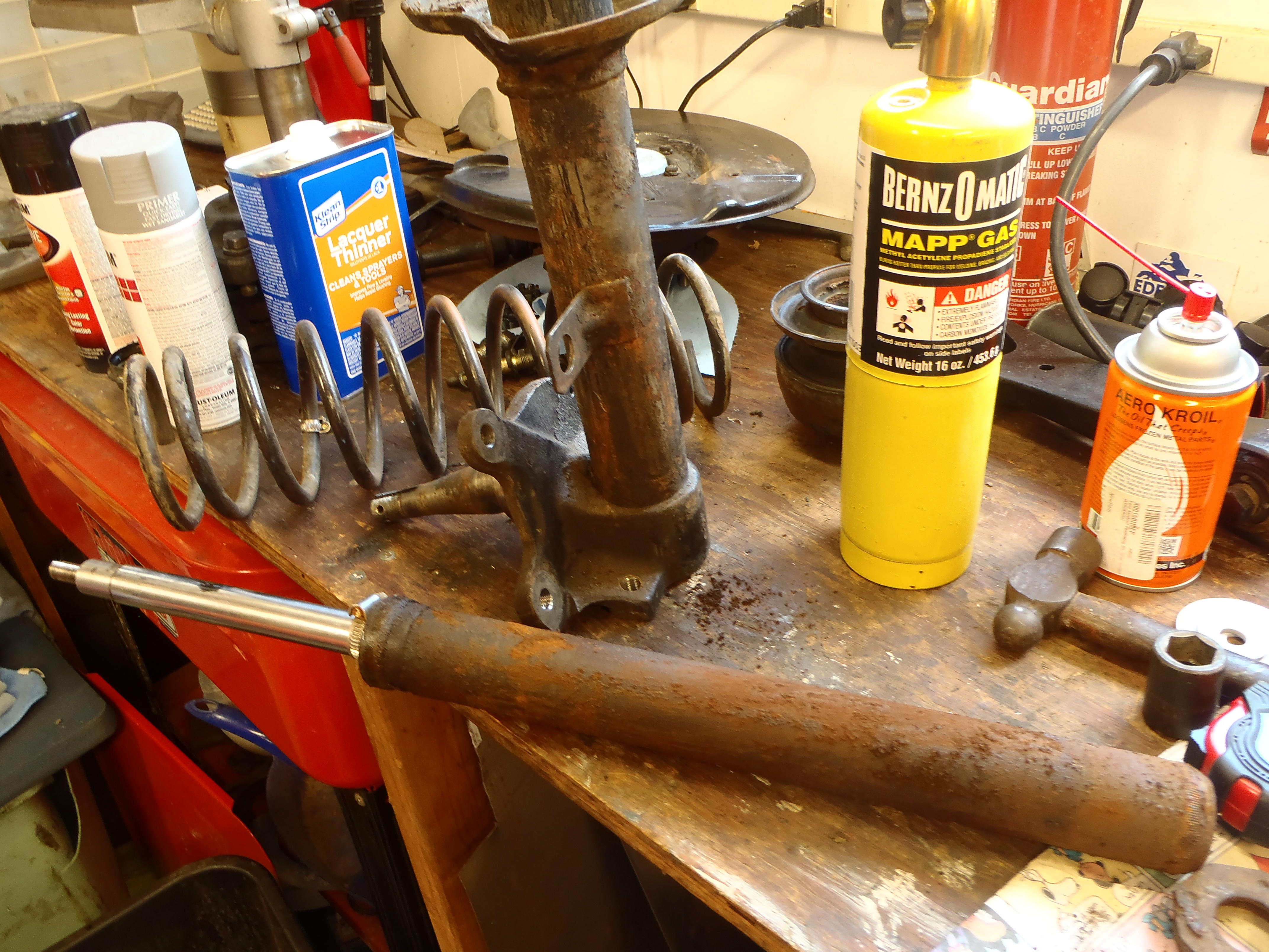

I'm going thru the front suspension of my '71 Series II and am having trouble figuring out how to remove the old strut cartridge.  I've searched and mostly get that I need to remove the big nut (I have) and the cartridge will slide out.  It may be original so it may have 46 years of inertia holding it in but perhaps I'm missing something.  No access from below, all the instructions seem to say I just pull it out.  I've soaked the area with Aero-Kroll but no luck.  Any suggestions?  What am I missing?
You're missing heat, sometimes those inserts can be real buggars to get out.  Get yourself a bottle of MAP gas and put some heat into the tube,  once it is good and hot spray it with your Kroll or WD40 around the top lip to cool it quickly.  3-4 cycles of that routine should get it moving, you can also give it some wacks with small hammer but not enough to dent,  you are just trying to break up the corrosion.

Excellent, thanks for the tips.  I hadn't considered heat but I was considering a slide hammer.  The main point is I have all the retaining stuff out of the way and it's only stuck by "habit" :-)

OK, this isn't cooperating at all.  I've tried the MAPP gas but am probably being too timid with the heat.  I guess I should be heating the whole length of the tube?
Conceivably I'm fighting 48 years of corrosion between the tube and the strut, correct?  Just to be sure, once I remove the gland nut, there's no cir-clips or hidden set screws I'm missing?  Nothing holds the cartridge in the tube other than the big nut, right?

That is correct. Gland nut and corrosion. I would heat the whole tube then add some penetrating oil. You will be hard pressed to damage the strut with MAP gas.

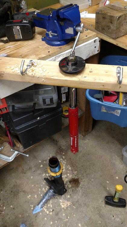

Success!  "Well there's your problem!"  Looks like I was battling 48 years of rust.  Lots of Kroll and I finally manned up with the MAP gas.  I made a sleeve out of heavy wall PVC and used an impact wrench to try and pull the strut up the tube.  Sort of working in the blind and the strut rod spun until it all tightened up but it worked.  Now I have to figure out how to clean the tube, probably with a wire wheel and a drill extension.  Thanks for all the suggestions and support.

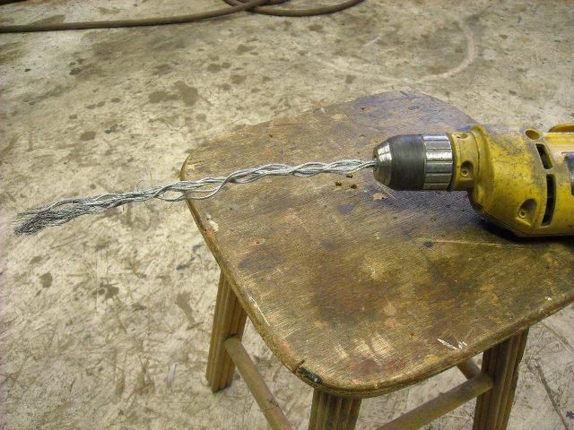

 I remember a fellow who made a long rotary wire brush using a length of wire rope (cable) to clean the interior of a piece of tubing. He taped around the cable about 2" up from the end and frayed the cable end out to around 45`. He chucked the other end of the cable in his drill motor and scrubbed out the interior of the tube until it was shiny.
Mark, was this it? I posted this about 5 yrs ago
