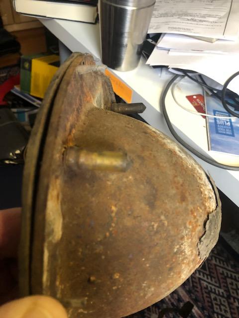

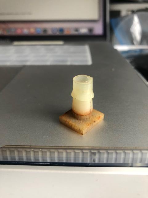

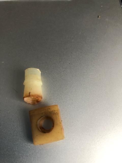

Posted January 23, 20196 yr comment_566514 I'm refurbishing my lights and all the nuts broke when I took them apart. I found a set on eBay but they are from Thailand. I looked at all the usual parts sources. Does anyone know where to get them? https://www.ebay.com/itm/3X-HEADLIGHT-ADJUST-SCREW-WHITE-PLASTIC-FITFOR-DATSUN-FAIRLADY-240Z-260Z-280Z/150882540704?_trkparms=aid%3D222007%26algo%3DSIM.MBE%26ao%3D2%26asc%3D20131003132420%26meid%3D206154ce5fbd4f39b962027a811efb99%26pid%3D100005%26rk%3D1%26rkt%3D8%26mehot%3Dag%26sd%3D162684278544%26itm%3D150882540704&_trksid=p2047675.c100005.m1851 Edited January 23, 20196 yr by SurferD added info Link to comment https://www.classiczcars.com/forums/topic/61462-headlight-adjustor-plastic-nut-source/ Share on other sites More sharing options...

January 25, 20196 yr comment_566636 They apply to all S30's. They will work, although the plastic housing is somewhat different---your photo of the screw housing ( I assume from your 10/70 car) does not fully enclose the threaded portion of the adjusting screw---which I find interesting as my 7/70 had the fully enclosed type. Link to comment https://www.classiczcars.com/forums/topic/61462-headlight-adjustor-plastic-nut-source/#findComment-566636 Share on other sites More sharing options...
January 25, 20196 yr Author comment_566640 59 minutes ago, Zup said: They apply to all S30's. They will work, although the plastic housing is somewhat different---your photo of the screw housing ( I assume from your 10/70 car) does not fully enclose the threaded portion of the adjusting screw---which I find interesting as my 7/70 had the fully enclosed type. Mine had transparent caps over the ends so they were enclosed too. The material had hardened over time and I had to break/cut them off. The shape of the end of the nut is barbed so a cap or improvised tubing will work. Edited January 25, 20196 yr by SurferD Link to comment https://www.classiczcars.com/forums/topic/61462-headlight-adjustor-plastic-nut-source/#findComment-566640 Share on other sites More sharing options...

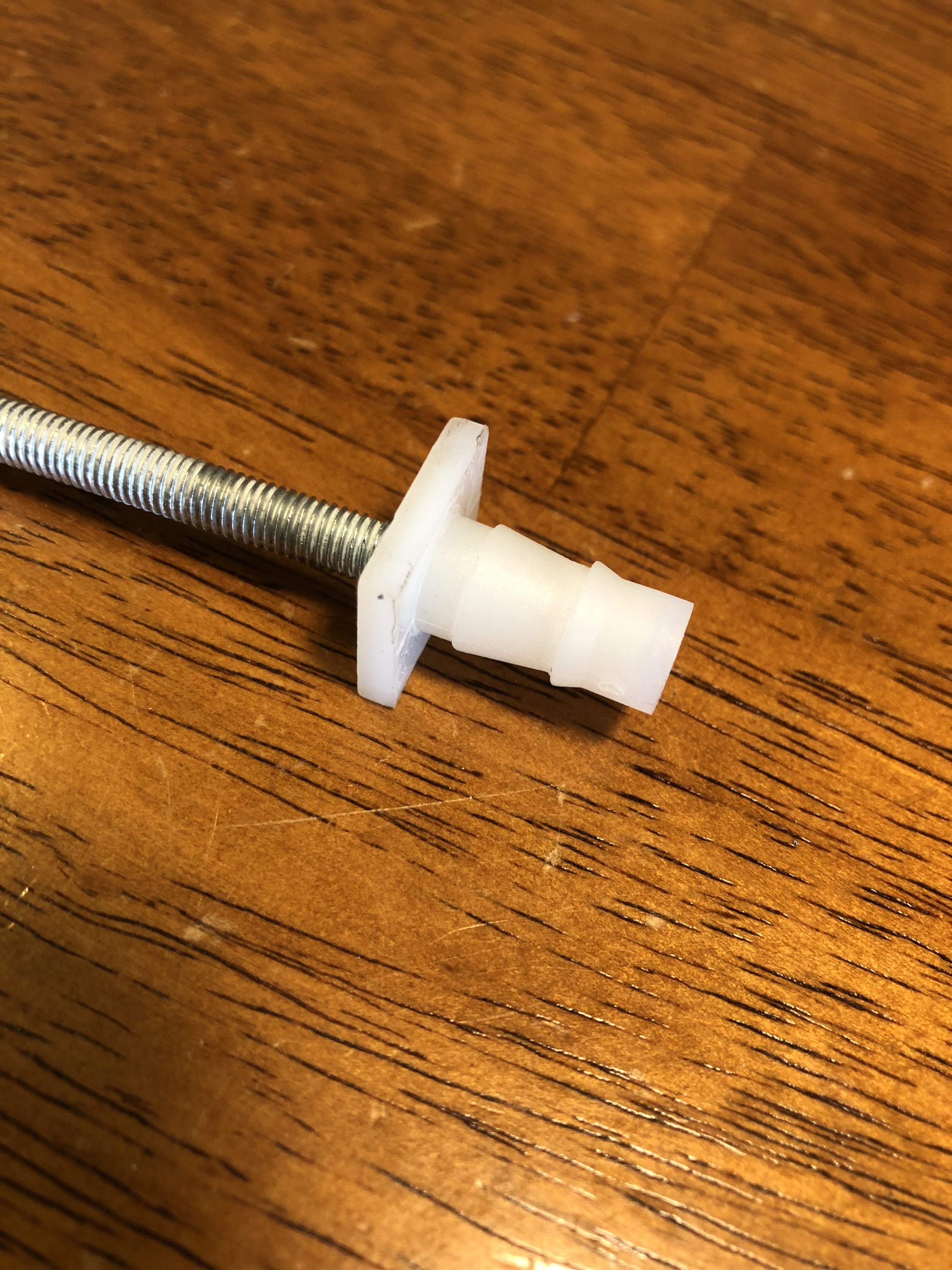

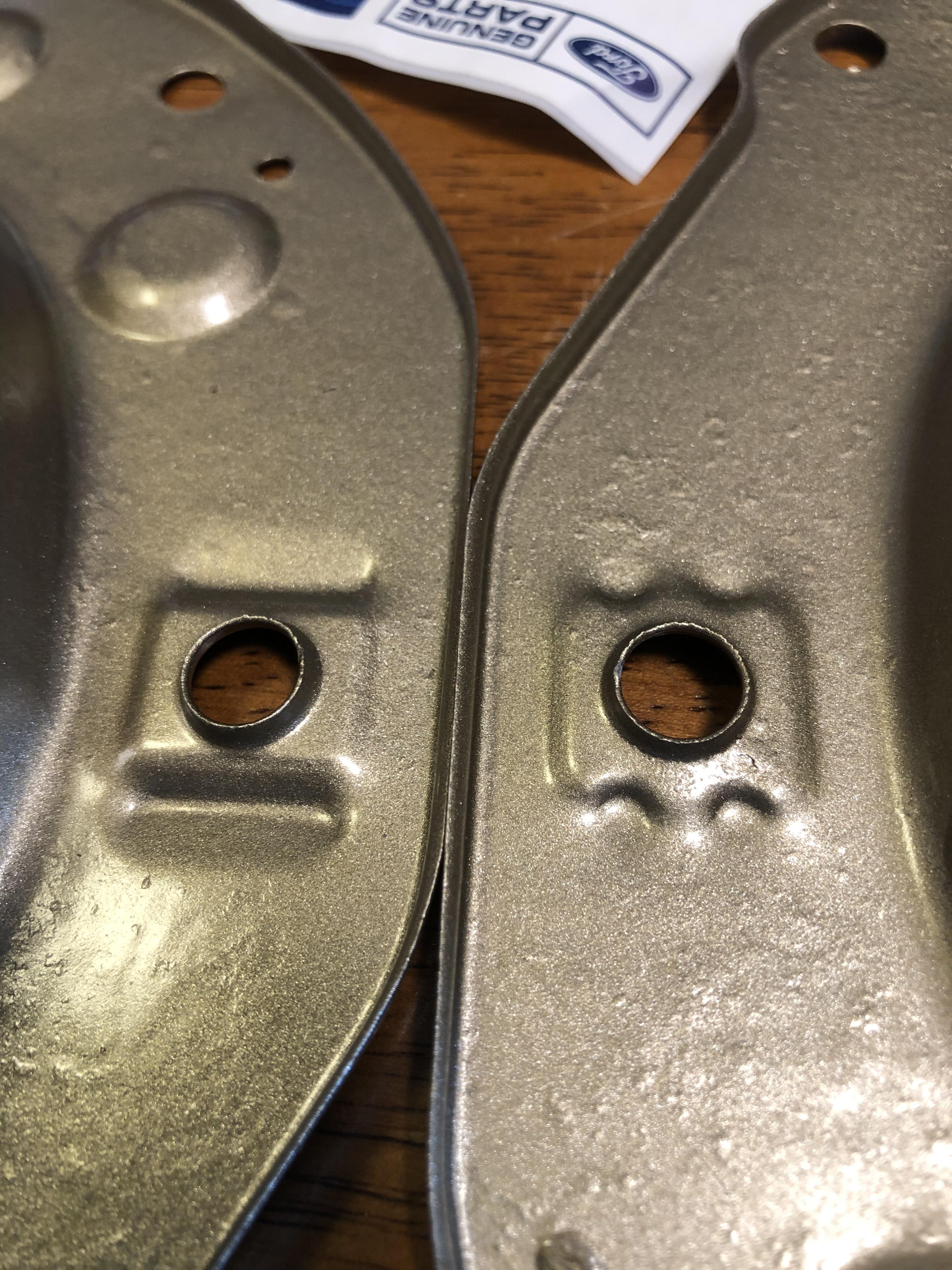

February 13, 20196 yr Author comment_568221 So I got the set from the bay seller and they are very good. they are the correct dimensions and are made of ABS. My only gripe is that the screws supplied are very tight and I think the ID of the parts is a little small. I used some Elmer's Dry lube on them and they are a little easier. The new screws are smalIer diameter than stock. I definitely recommend these for restoring light buckets. Another interesting change that I found and never read about before from series one to later versions of the lights is the recessed mounting locations of these nuts. On my original ones there's a stamped area with serrations so they don't spin. On later buckets I have, it's a more pronounced full rectangular stamping. Also on the early buckets there's no holes for the locating nibs on the new gaskets. I drilled 4mm holes so the gaskets fit. Another "why would they do that" find. Edited February 14, 20196 yr by SurferD Link to comment https://www.classiczcars.com/forums/topic/61462-headlight-adjustor-plastic-nut-source/#findComment-568221 Share on other sites More sharing options...
