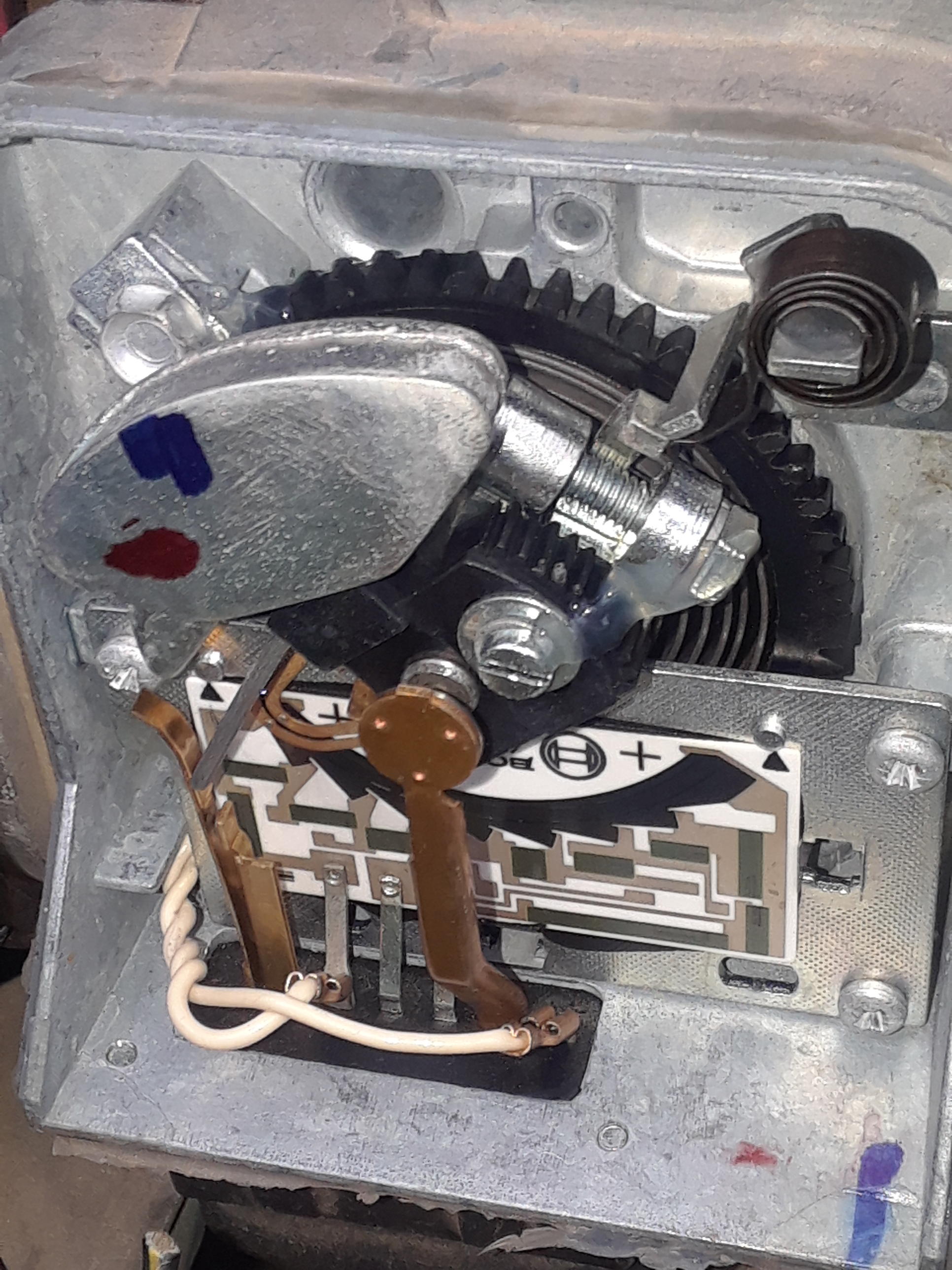

January 24, 20196 yr comment_566577 Make sure the vane isn't stuck behind the black box on the afm. Try tapping it first if it hasn't been off before. Are the distributor cap contacts worn down? New cap and button would be money well spent. Have you tried turning the distributor to advance timing when it's running? Guesses... Link to comment https://www.classiczcars.com/forums/topic/61469-my-280z-cranks-but-doesnt-stay-running-once-started/#findComment-566577 Share on other sites More sharing options...

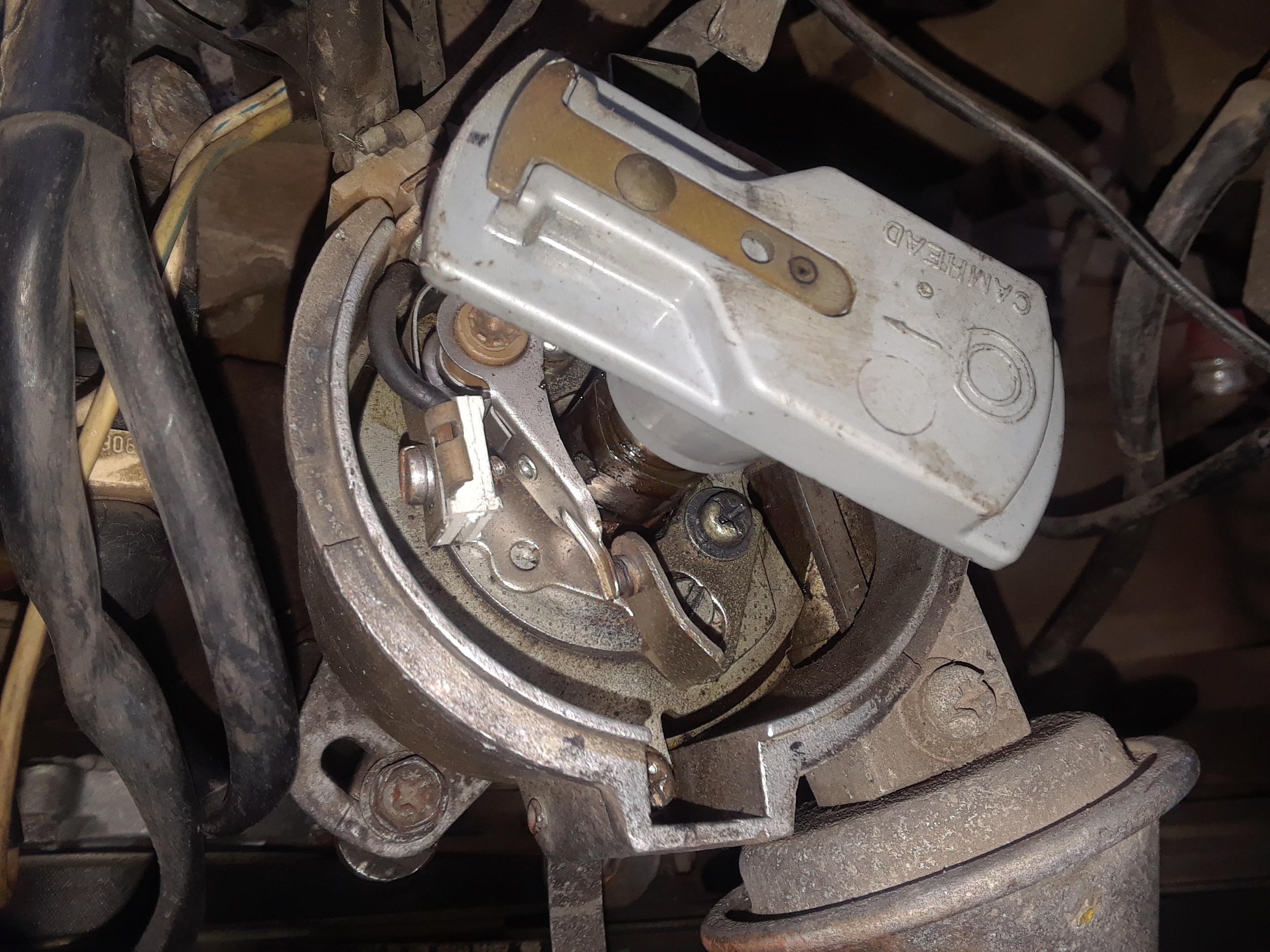

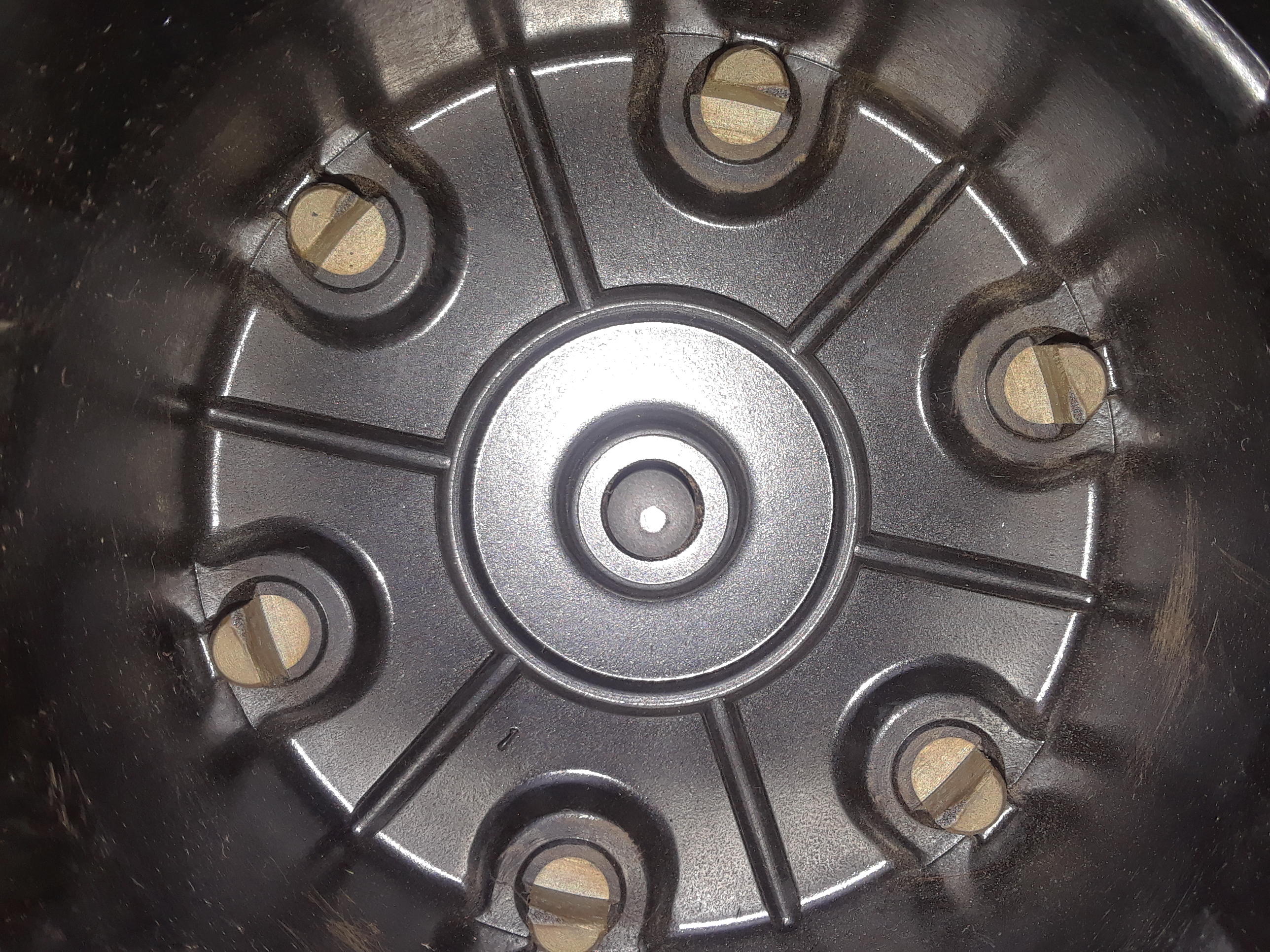

January 24, 20196 yr Author comment_566581 I actually don't know how to tell if the points are bad, I took a few pictures of the bottom of the cap and the rotor. I also have no idea how to set it to advanced timing too, its my first car, im really new to it, and here's a picture if you can tell it looks stuck on the AFM, I tried moving it a little and nothing seems to look stuck Link to comment https://www.classiczcars.com/forums/topic/61469-my-280z-cranks-but-doesnt-stay-running-once-started/#findComment-566581 Share on other sites More sharing options...

January 24, 20196 yr comment_566588 His timing is maxed out looks like. Why are you running a points distributor? Just curious. Link to comment https://www.classiczcars.com/forums/topic/61469-my-280z-cranks-but-doesnt-stay-running-once-started/#findComment-566588 Share on other sites More sharing options...
January 25, 20196 yr Author comment_566593 That distributor just what came with the car when I bought it, I never put it in or anything. Edited January 25, 20196 yr by K Koehn Link to comment https://www.classiczcars.com/forums/topic/61469-my-280z-cranks-but-doesnt-stay-running-once-started/#findComment-566593 Share on other sites More sharing options...

January 25, 20196 yr comment_566609 1 hour ago, K Koehn said: I hear a spray coming from the fuel rail area, I figured that was the injectors firing in there. I had no idea my 280 wasn't supposed to have points, what should my car have? I could use some help on that, ill also have a look at the spark plugs and ill listen in on the injectors it should have a distributor with a reluctor and some electromagnet coils (1 or 2 depending on if its a cali car on not). there should be a ignition module on the passenger side up by the fuse box in the foot well area. The points should work to fire the ignition coil, just prob not as hot a spark and more maintenance, but certainly fine for the job, cars used points for decades. Prob the PO just did not understand the ign module, or it was bad, or the distributor was bad or they just liked points. The key is the ECU needs a signal, as mentioned by ZH just need to make sure its hooked up. I assume the car ran at one time with that setup, but assumptions can get you in trouble. Put the stethoscope probe right on the injector, you will here it clicking away if its working. If you have good ears you may hear it without the stethoscope, or just get some hose about 2ft long and hold that to your ear, with the other end up next to the injector. Edited January 25, 20196 yr by Dave WM Link to comment https://www.classiczcars.com/forums/topic/61469-my-280z-cranks-but-doesnt-stay-running-once-started/#findComment-566609 Share on other sites More sharing options...
January 25, 20196 yr comment_566611 How long have you had this Z? Do you know if they installed the correct cap and rotor considering its a points dizzy? IIRC the 70-73 cap and rotor are different from the other years. Do you know how to adjust and clean points? Like mentioned above, check spark (looking for strong spark), fuel pressure and if the injectors are firing. Fast clicking sound will be heard. Look at the spark plugs. They tell you a lot. Not sure then take pics and post. Edited January 25, 20196 yr by rcb280z Link to comment https://www.classiczcars.com/forums/topic/61469-my-280z-cranks-but-doesnt-stay-running-once-started/#findComment-566611 Share on other sites More sharing options...
