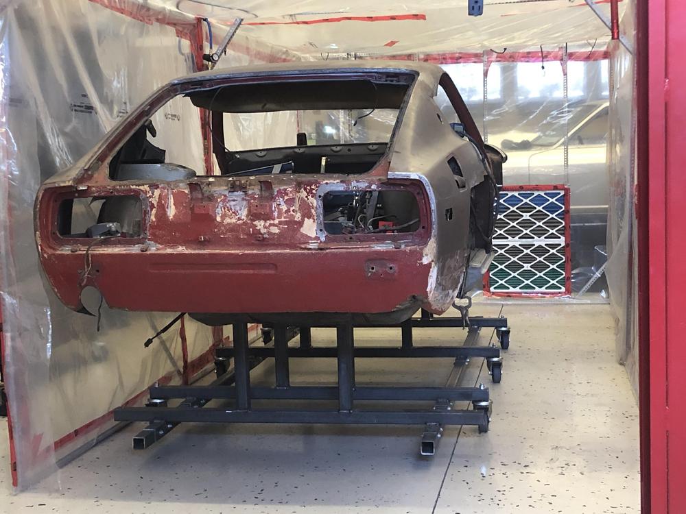

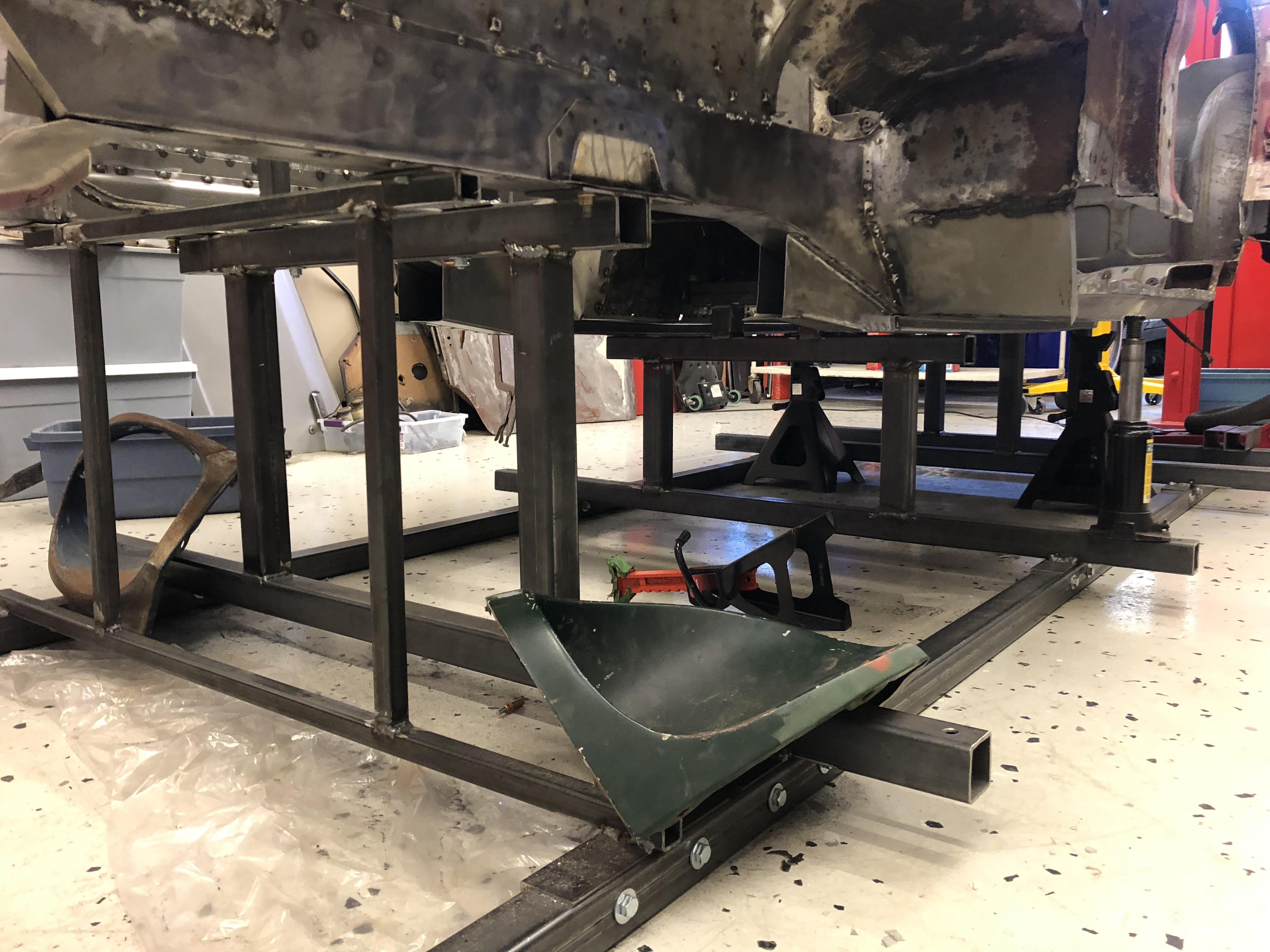

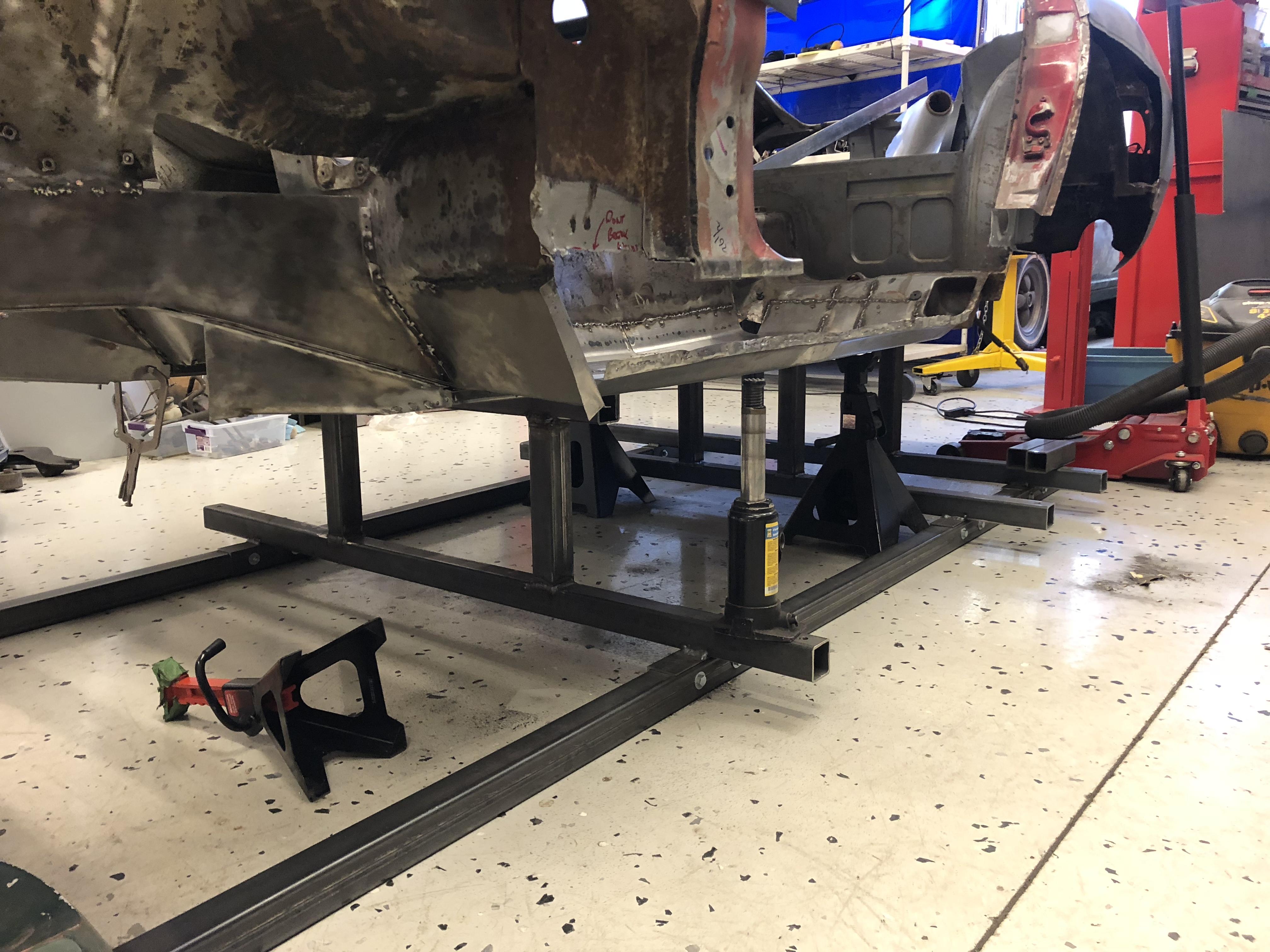

March 29, 20196 yr Author comment_572089 Cut out the driver’s side rocker with no additional bracing. No drama ... Edited March 29, 20196 yr by ConVerTT Double pic Link to comment https://www.classiczcars.com/forums/topic/61482-240z-gets-jiggy/?&page=3#findComment-572089 Share on other sites More sharing options...
March 29, 20196 yr comment_572097 No inner or outer rockers, that's a view that you don't see very often. Kent, before you put that rocker back together, could you possibly layout all the panels on the floor next to the D/S door opening kind of like an exploded diagram and post a photo of it? That photo would be a useful addition to the Knowledge Base section of the forum as a quick reference. Link to comment https://www.classiczcars.com/forums/topic/61482-240z-gets-jiggy/?&page=3#findComment-572097 Share on other sites More sharing options...
March 29, 20196 yr Author comment_572121 Certainly, no problem. It will be next week as I still need to fab the internal bracing ... ‘Details of the destruction and repair are in this thread too Link to comment https://www.classiczcars.com/forums/topic/61482-240z-gets-jiggy/?&page=3#findComment-572121 Share on other sites More sharing options...

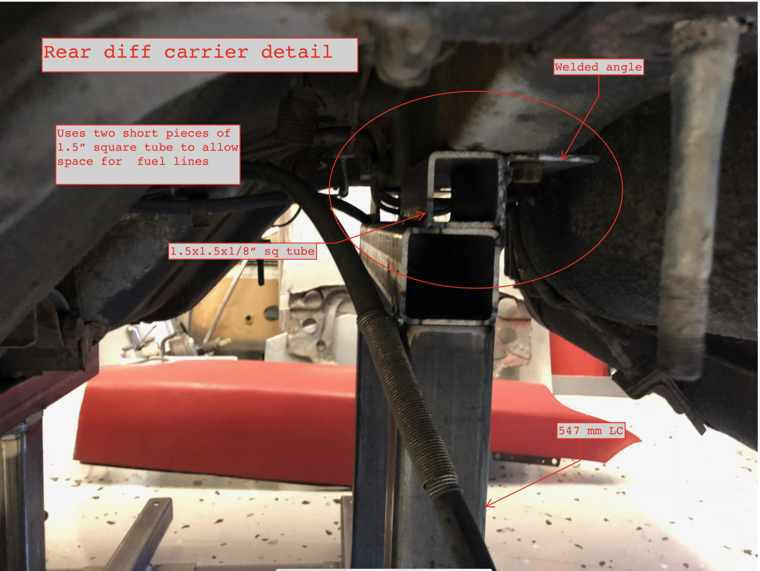

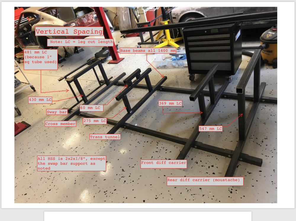

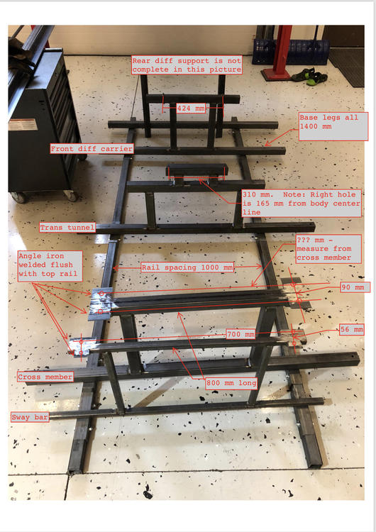

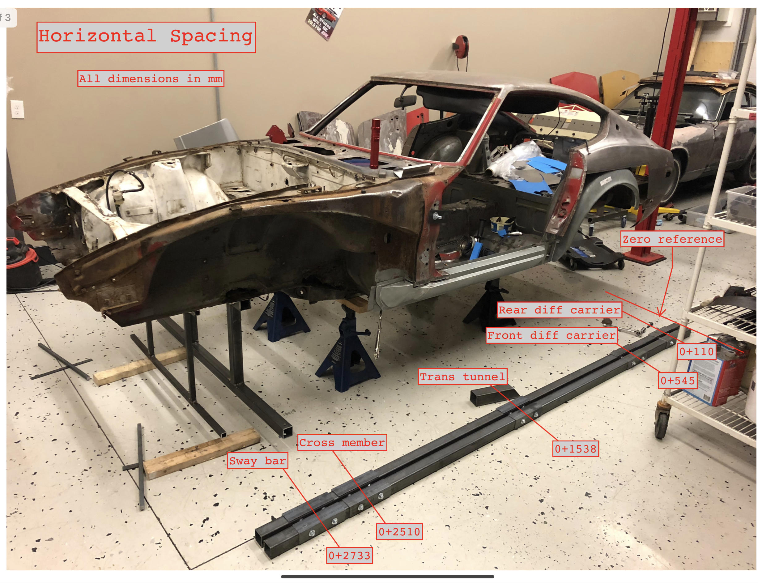

April 10, 20195 yr Author Popular Post comment_573004 A couple of folks have asked for plans for the jig. I’ve marked up a few pics with all the key dimensions. Feel free to post here or PM me with any questions.... Hope this this helps somebody .... Link to comment https://www.classiczcars.com/forums/topic/61482-240z-gets-jiggy/?&page=3#findComment-573004 Share on other sites More sharing options...

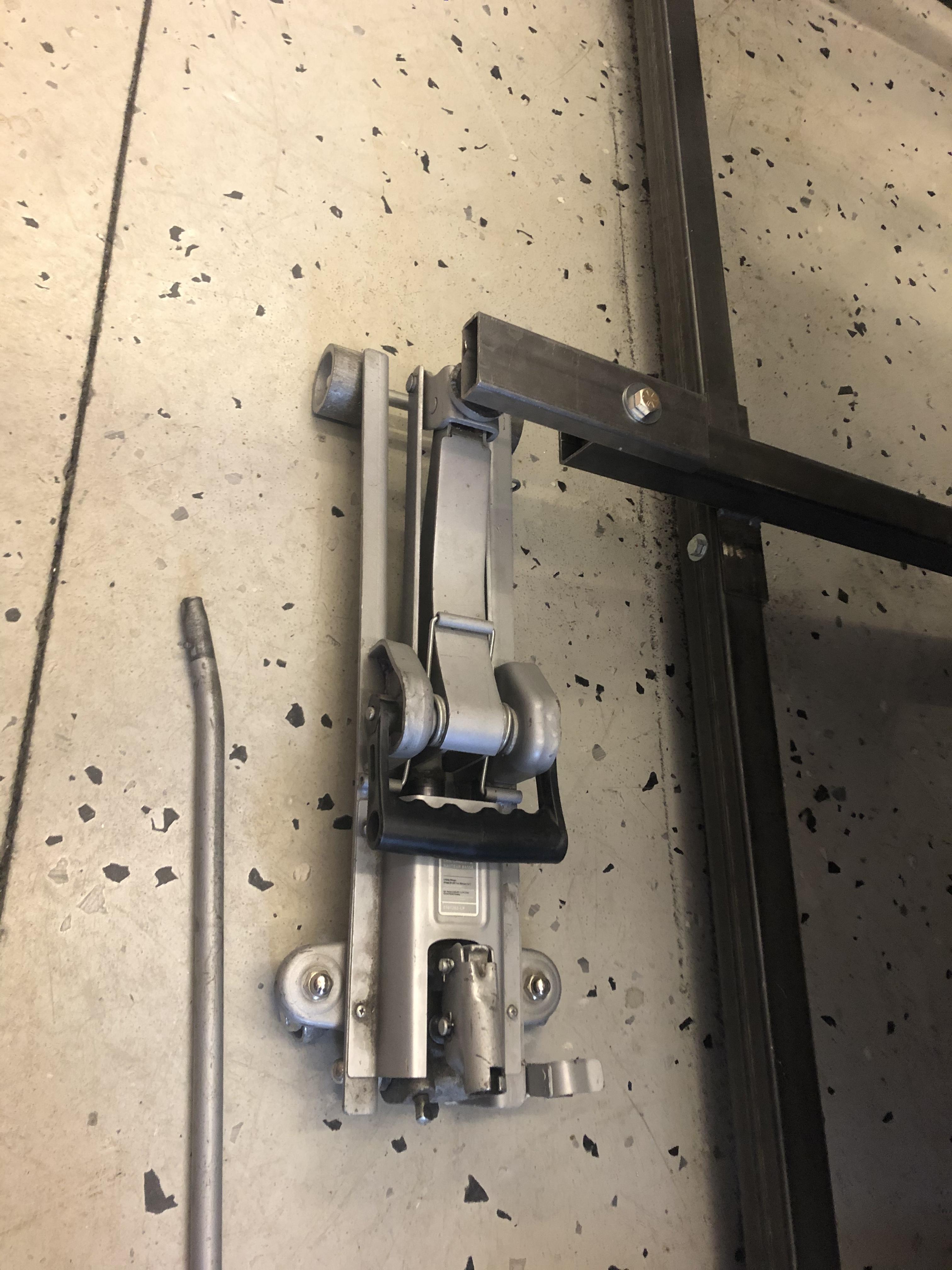

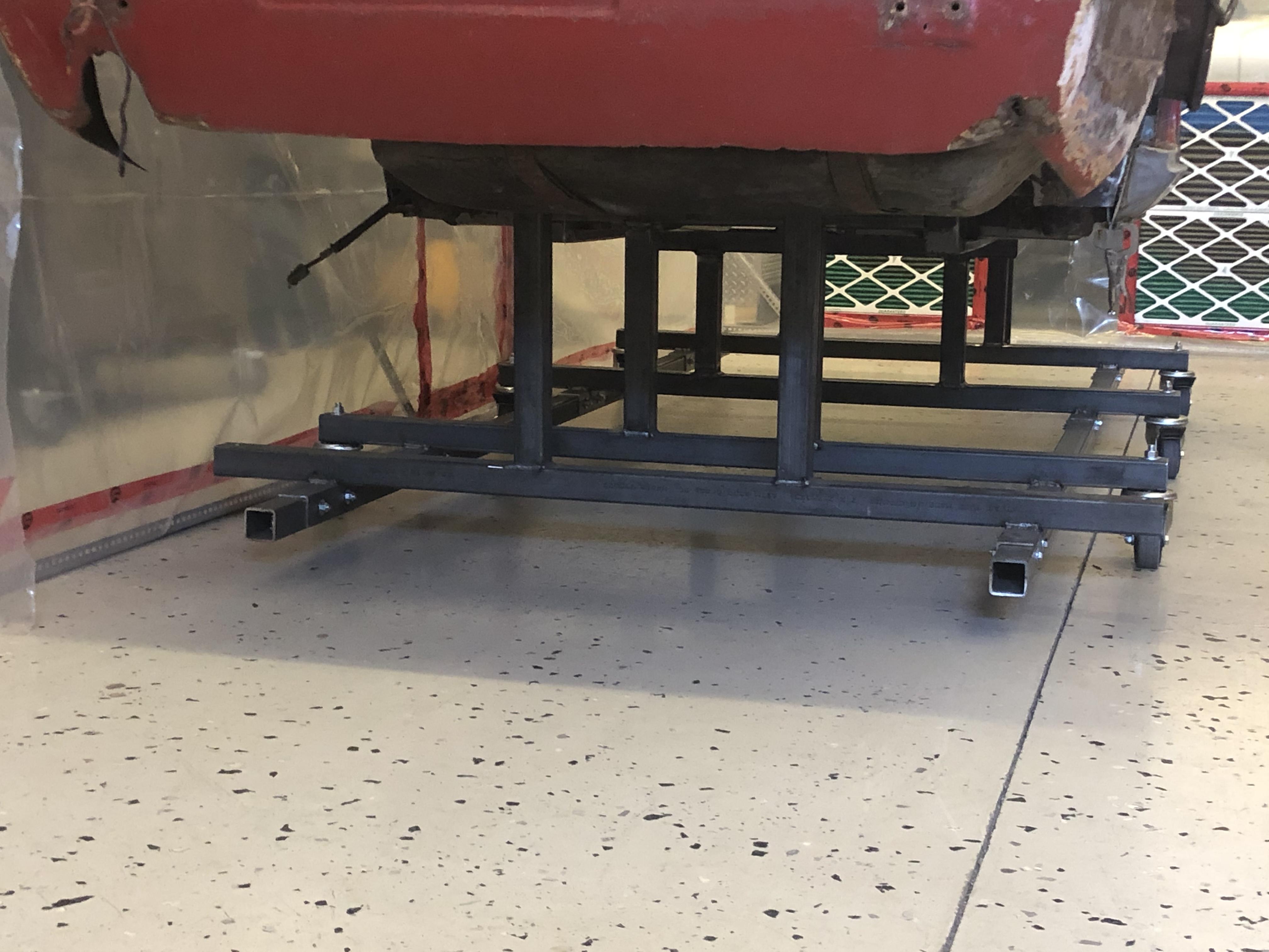

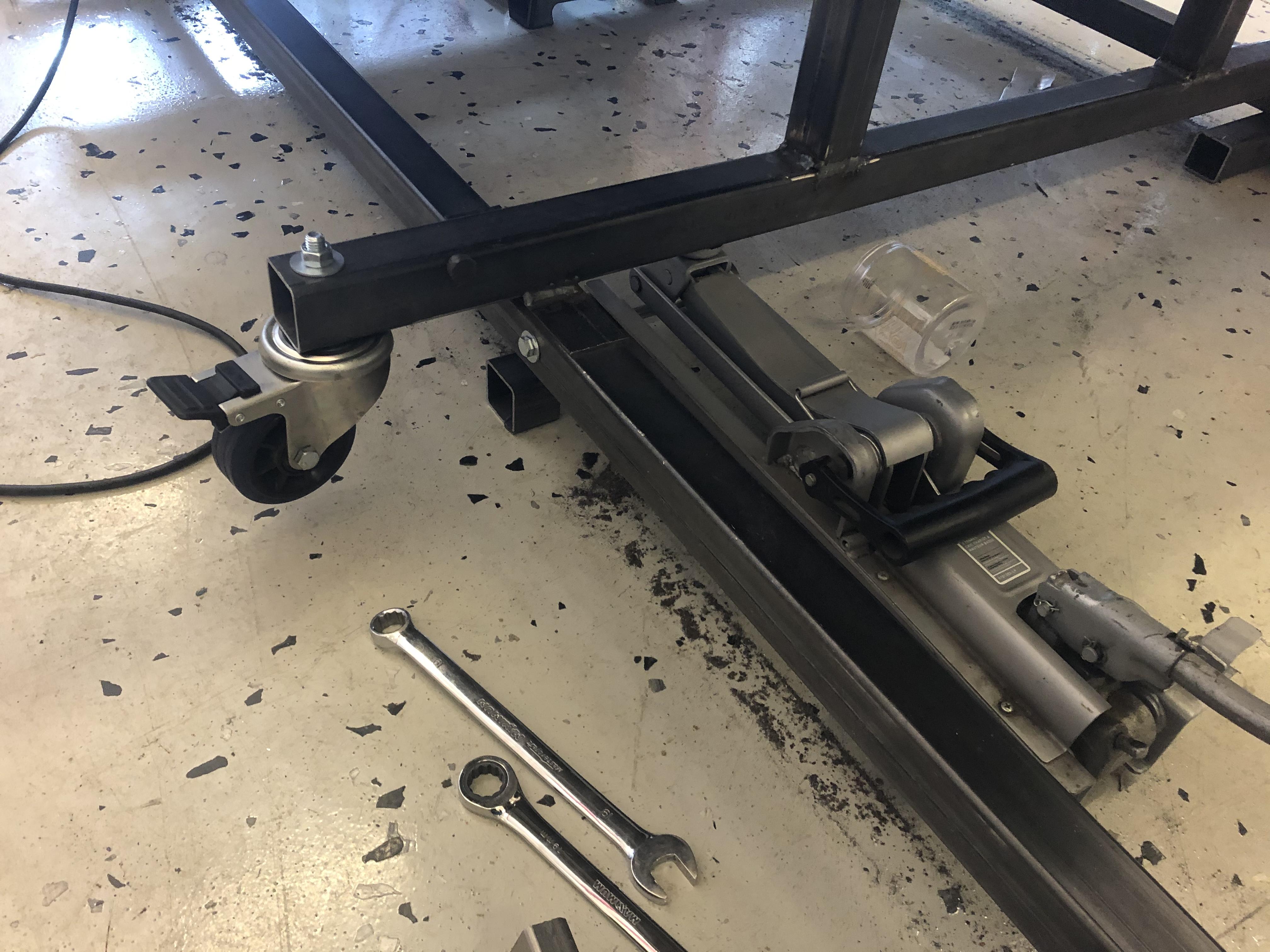

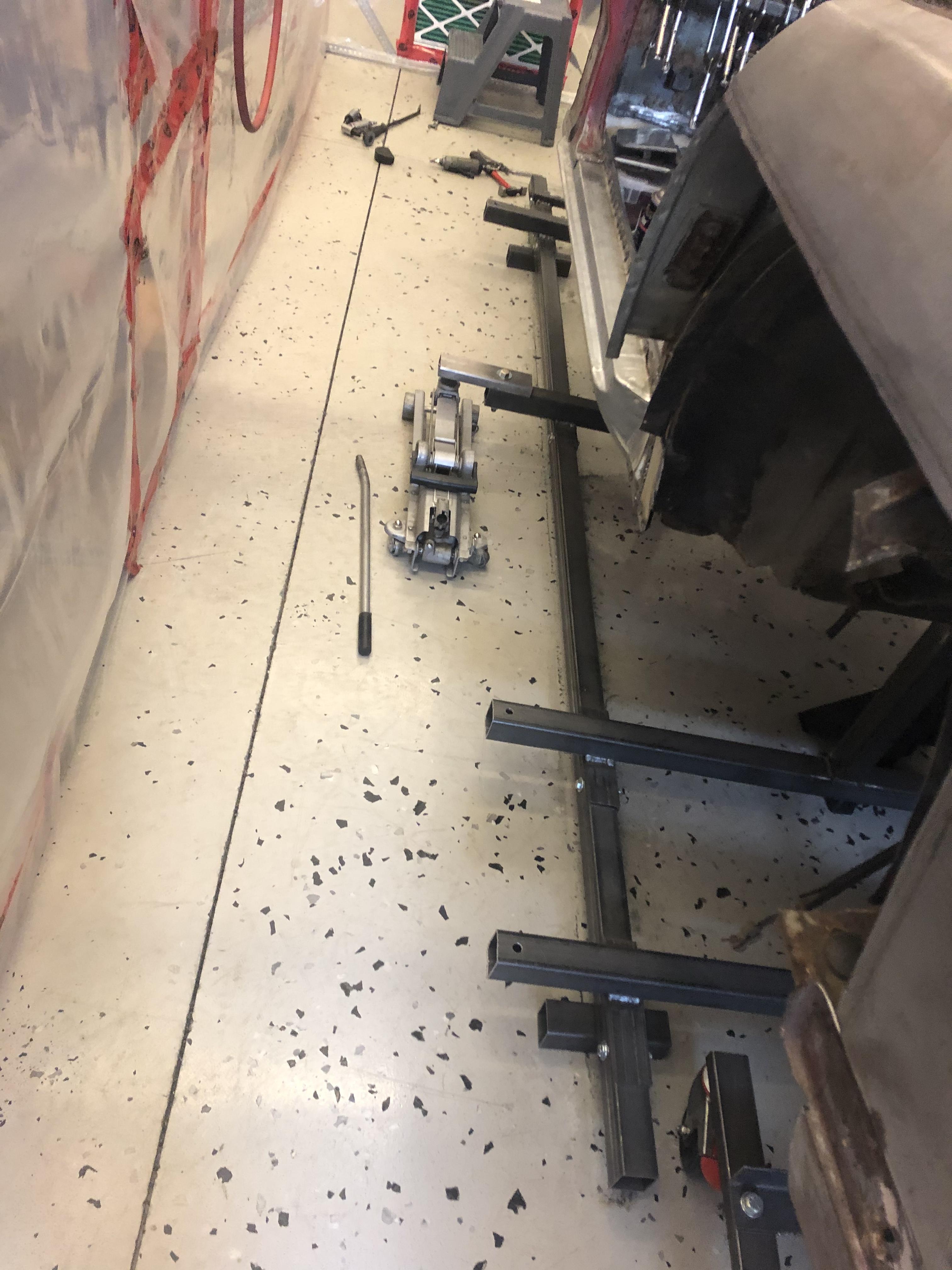

March 3, 20205 yr Author Popular Post comment_593584 It's finally time to move the jig ... lets see if the dolly plan worked .... custom lifting tool .... ...caster bolted up ... repeat ... easy peasy .... Link to comment https://www.classiczcars.com/forums/topic/61482-240z-gets-jiggy/?&page=3#findComment-593584 Share on other sites More sharing options...
