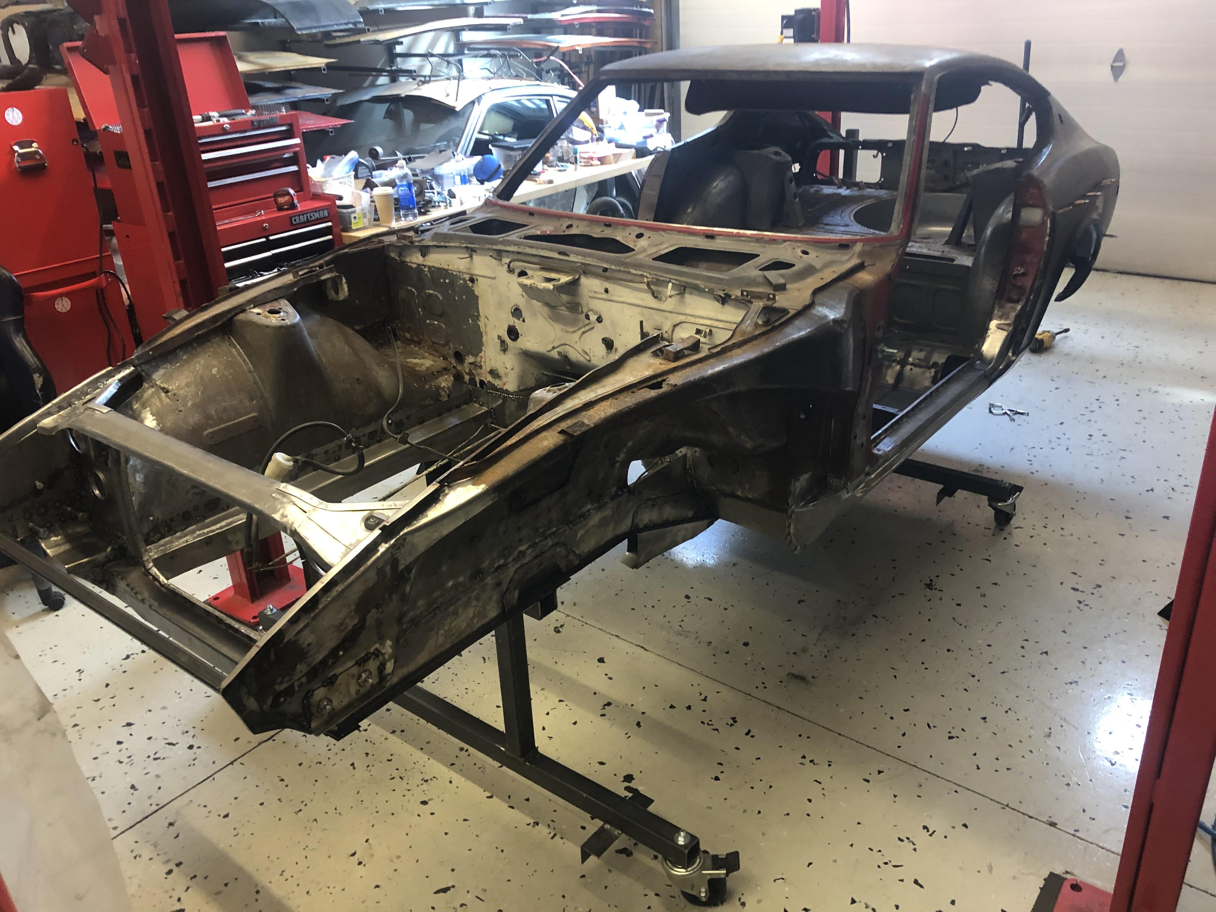

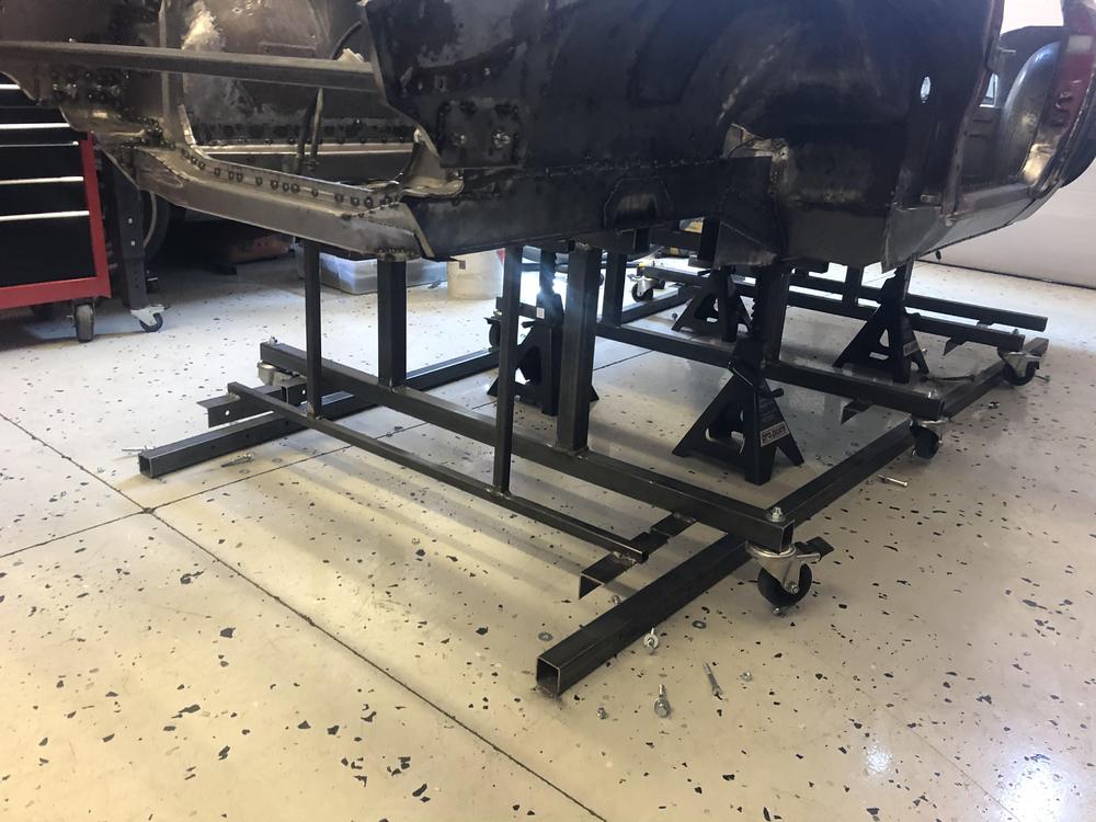

 Well now that the chassis is nice and strong, it's finally time to remove the jig and let the chassis stand on it's own.  I thought about this step when I originally built the jig and made it so that it can be easily unbolted from the shell - everything went as planned....
first step - lift entire assembly and support with jack stands under the shell ....
next - unbolt / remove the two full length runners ...
next - unbolt and stow the individual supports ....
I left the supports at the differential carrier and the front cross member so I can roll the shell around the shop for a few more days until she goes on the rotisserie...
Last step - set her back down (or leave her on jack stands for reassembly or whatever- depending on what stage you are at)
The empty shell is very light.  It is stable and rolls around easily without tying the front and back casters together (although it wouldn't take much to bolt on a couple of pieces of angle iron either)

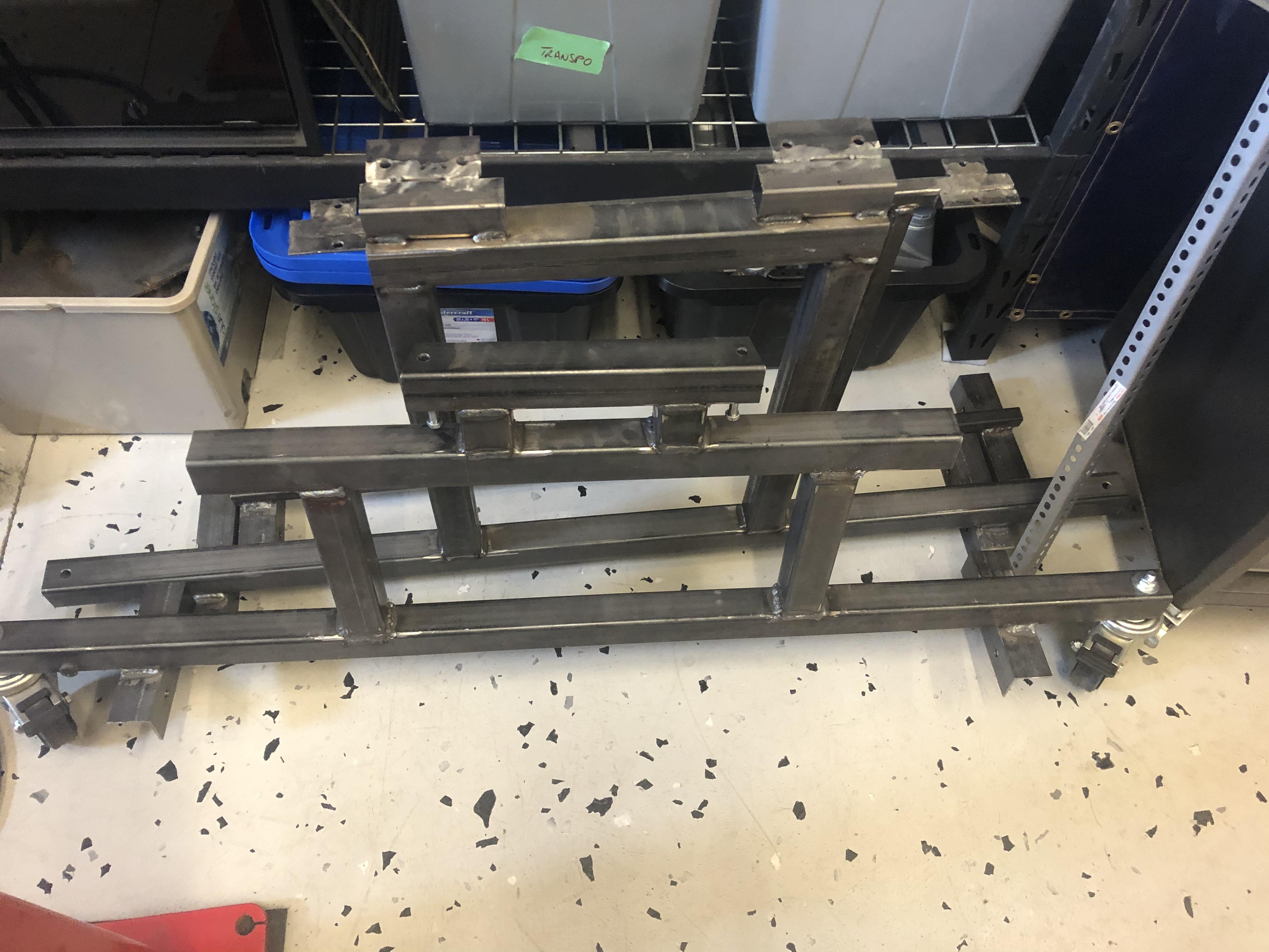

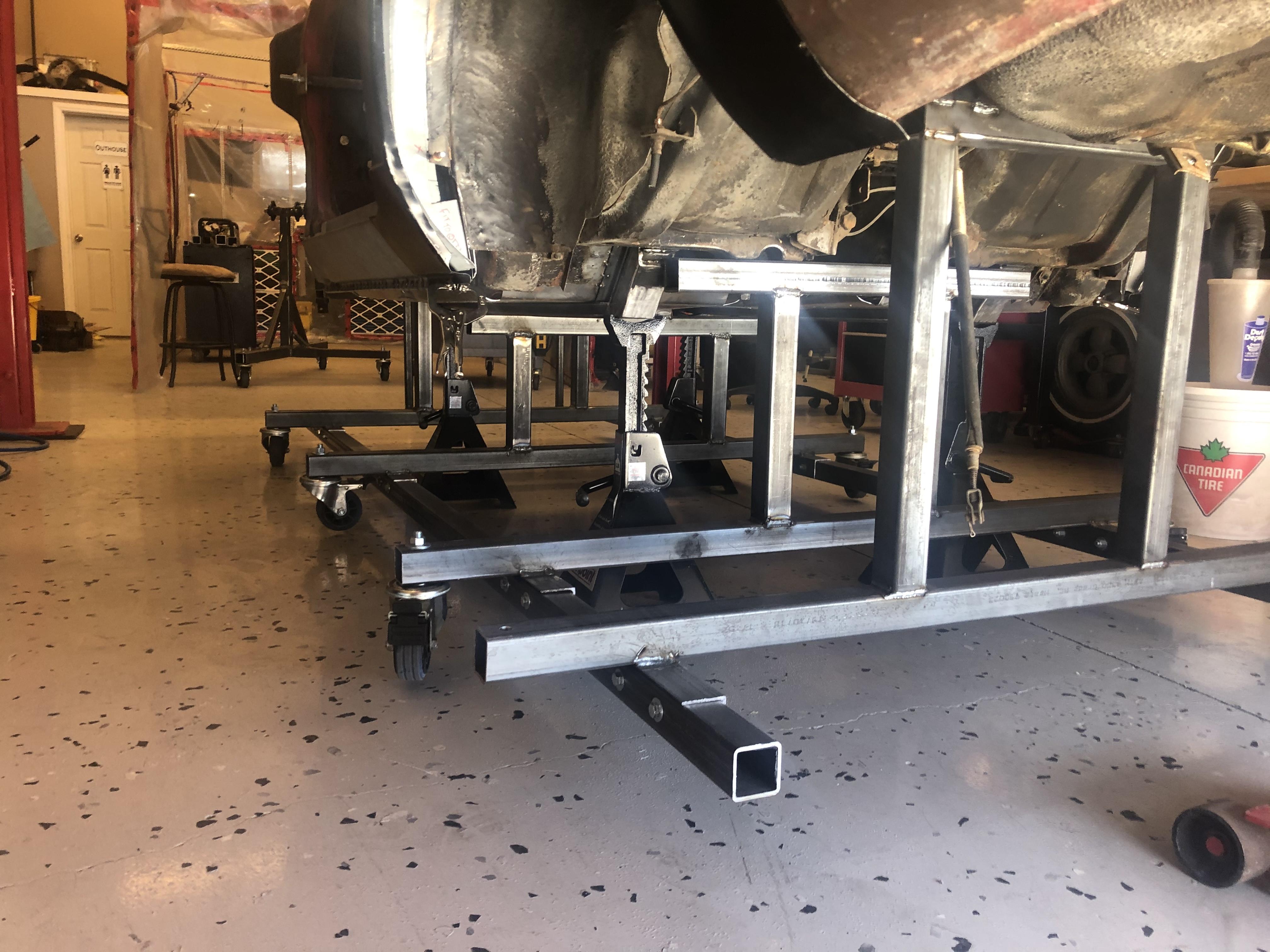

Hey ConverTT
I've just started building this jig for my project. Thanks very much for your detailed dimensions and photos. It’s taking me a while due to lack of previous metal fabrication experience but I will get quicker.
With the rear diff carrier frame, did you build it with the smaller box section and angle to avoid removing the fuel lines or so during reassembly you could install fuel lines with the frame on?
Do you recommend getting the the base 3m lengths completely level before you assemble all the frames and attach to chassis? Or doesn’t really matter?
also do you recall the rough size of bolt you used on the jig?

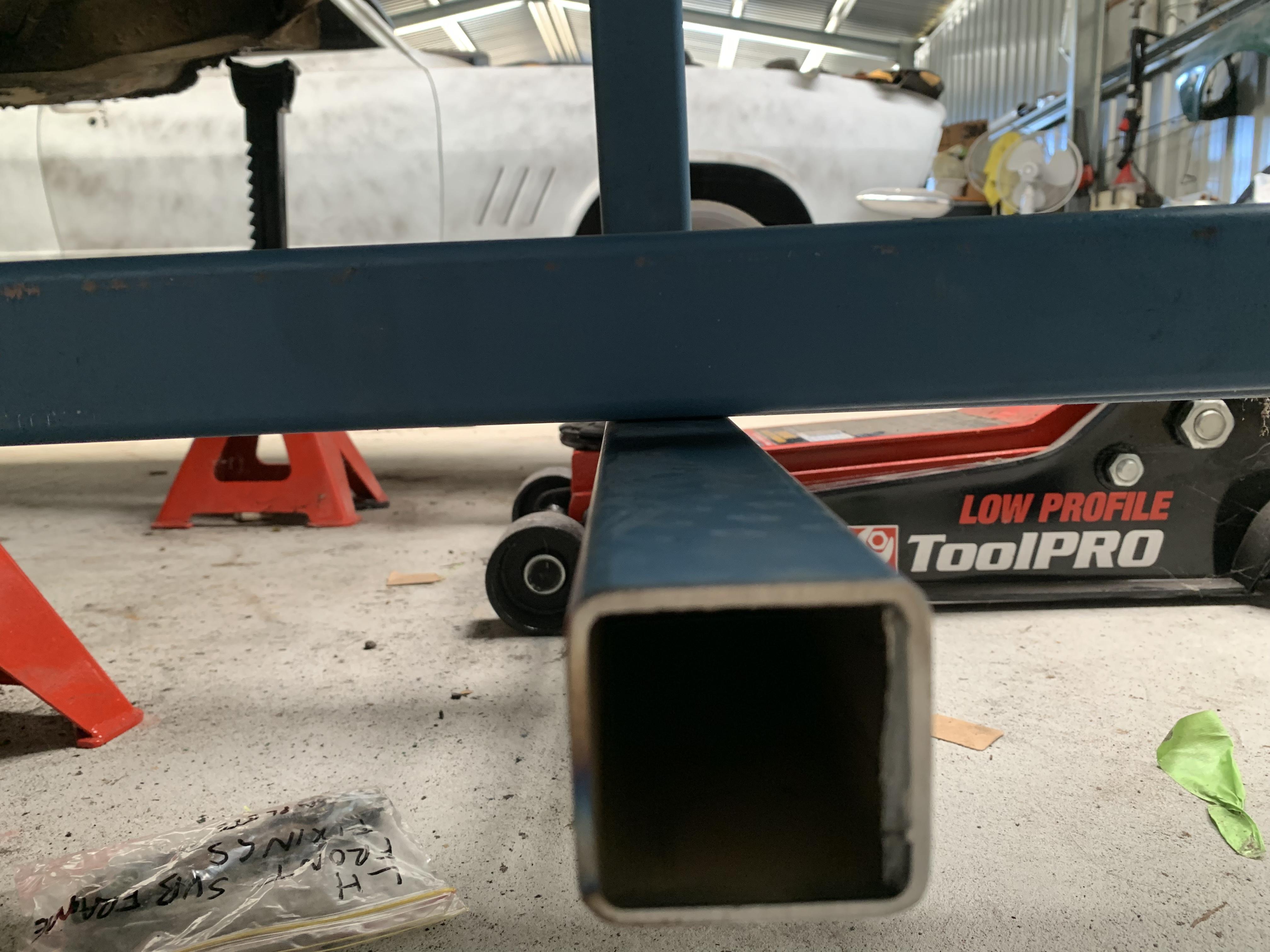

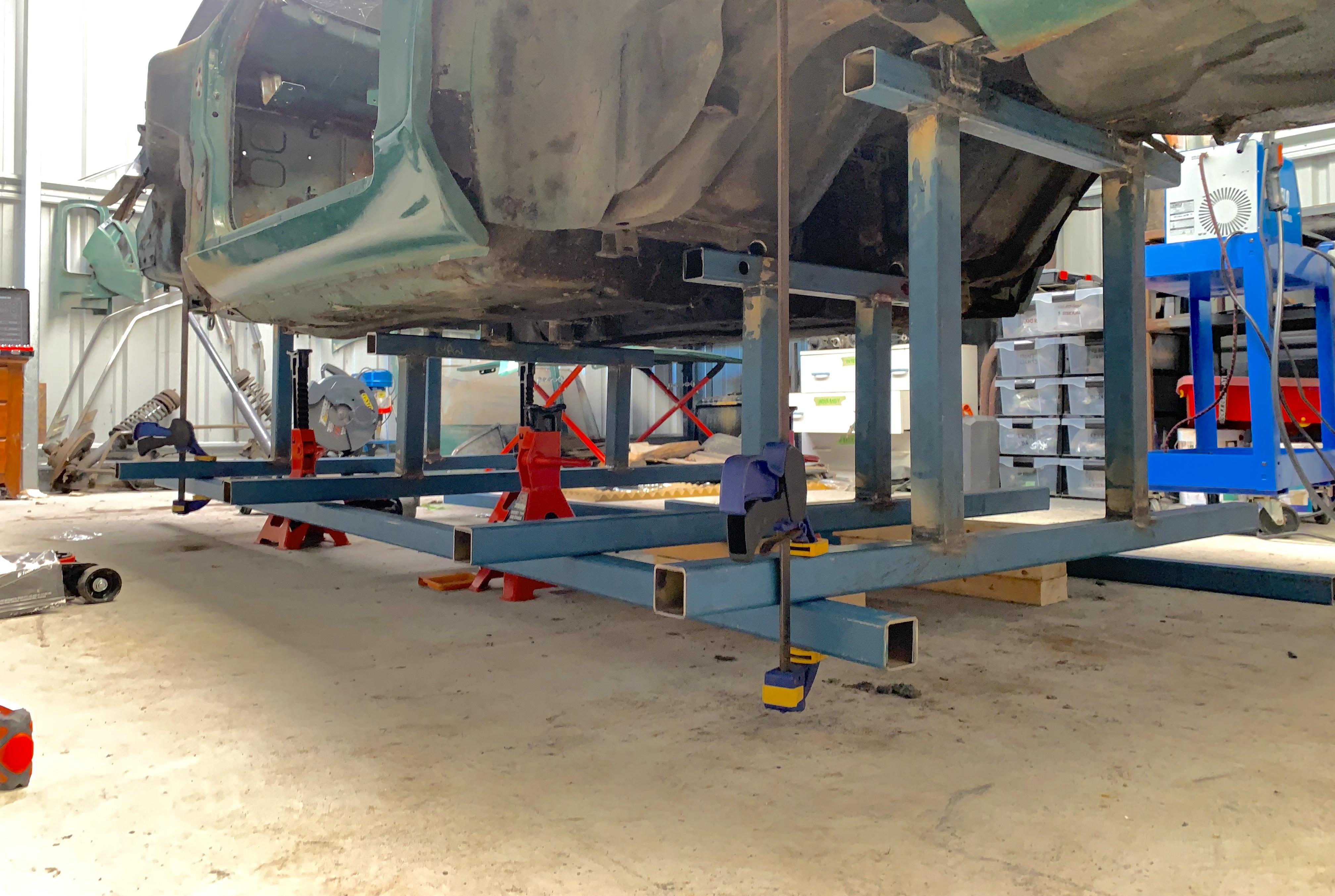

Hi Kent @ConVerTT
just wondering if your gearbox support frame was a little short when offering up the 3m lengths up into place?
I found the gearbox support frame to be the only one that had an issue, the others were fine. Only a 5mm gap so nothing crazy
I PM’d Jon @tyroguru who also had a similar discrepancy with only his gearbox frame as well.
I did double check all my measurements to yours and all were correct. Might just be a slight discrepancy between chassis’s? These were handmade back in the 60’s/70’s so slight variation is to be expected in my mind. I’m pretty confident my chassis is reasonably straight as I'm sure yours is too. I’m just going to pack the gap with sheet metal and weld in place.
Just thought I would document this for anyone else who builds this jig in the future. I would build the gearbox frame last, offering the 3m lengths up to the other frames and measuring up distance before cutting uprights for gearbox support frame.
