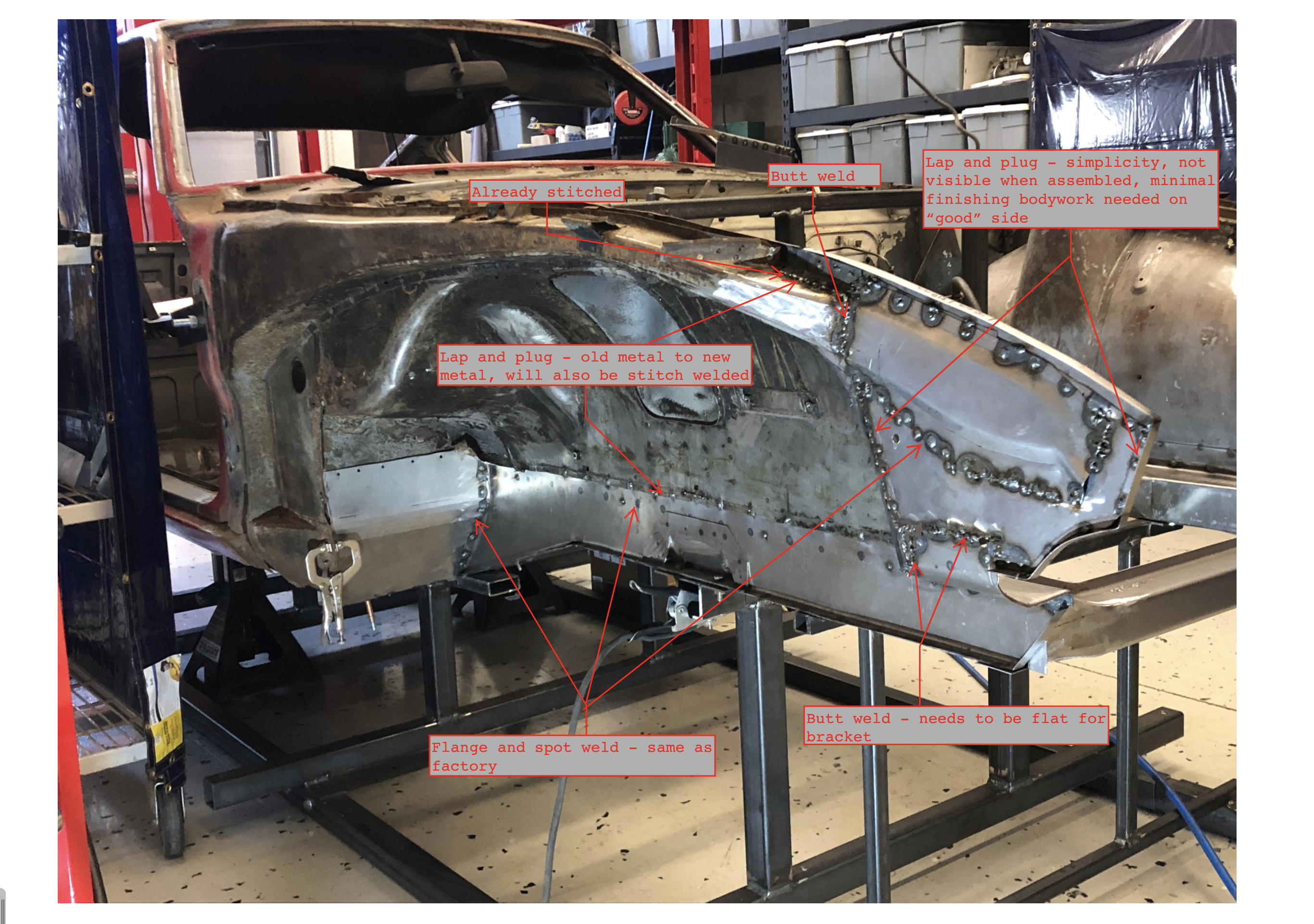

Got the Franken - Fender backing plate welded up
Out of curiosity, are those butt welds throughout, or do I see a few plug welds in certain places?  If you did use plug welds for this repair, what's the rationale?
So ... there are a lot of opinions on butts, versus laps/flanges and plugs versus stitches.  I use all of them depending on the circumstance.  For example: I will almost always lap, plug stitch when attaching “Important” old metal to new metal (like floors to transmission tunnel, or frame rails to the inner fender patch).
I used almost every type on the Franken Fender ....
