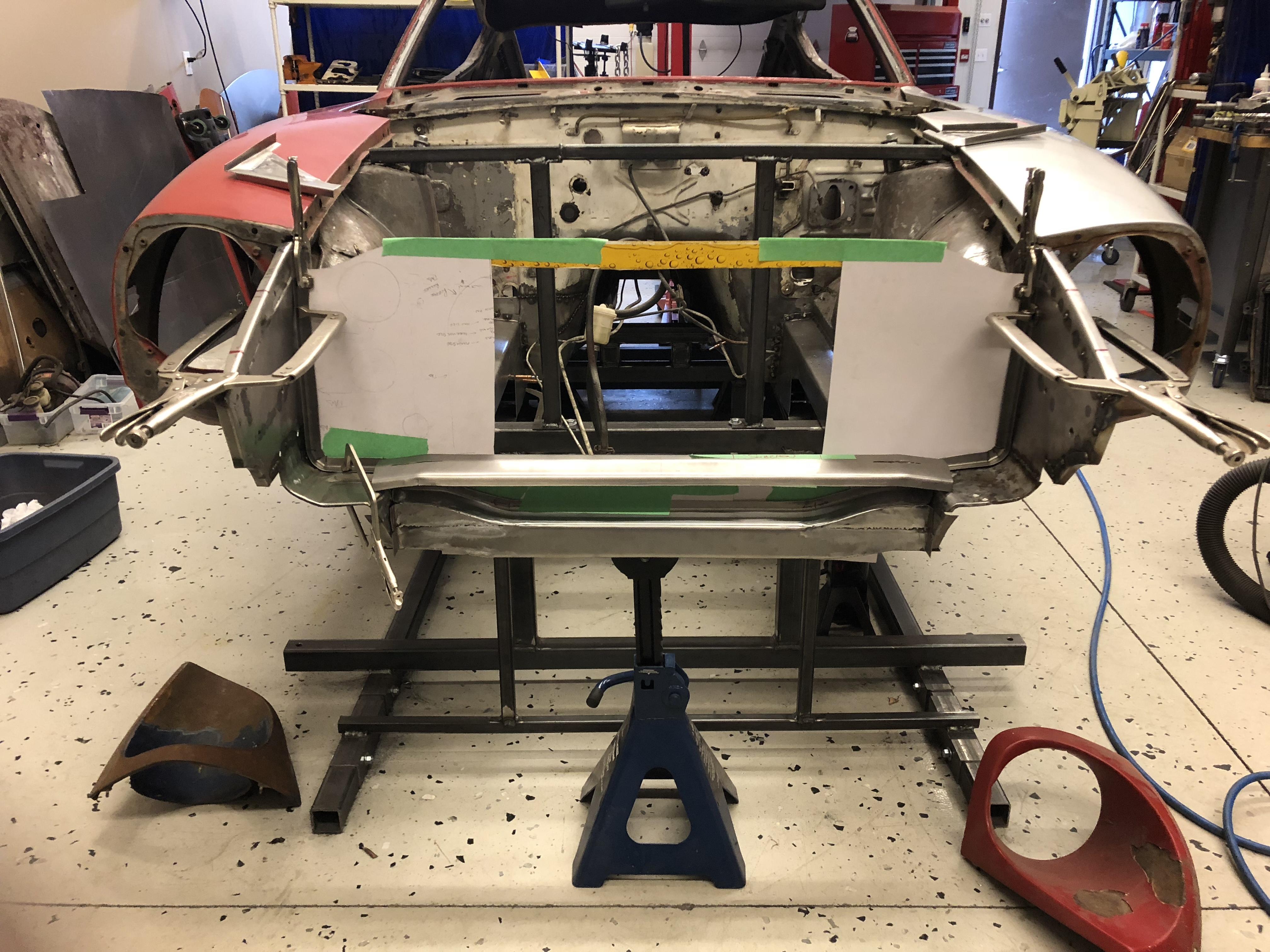

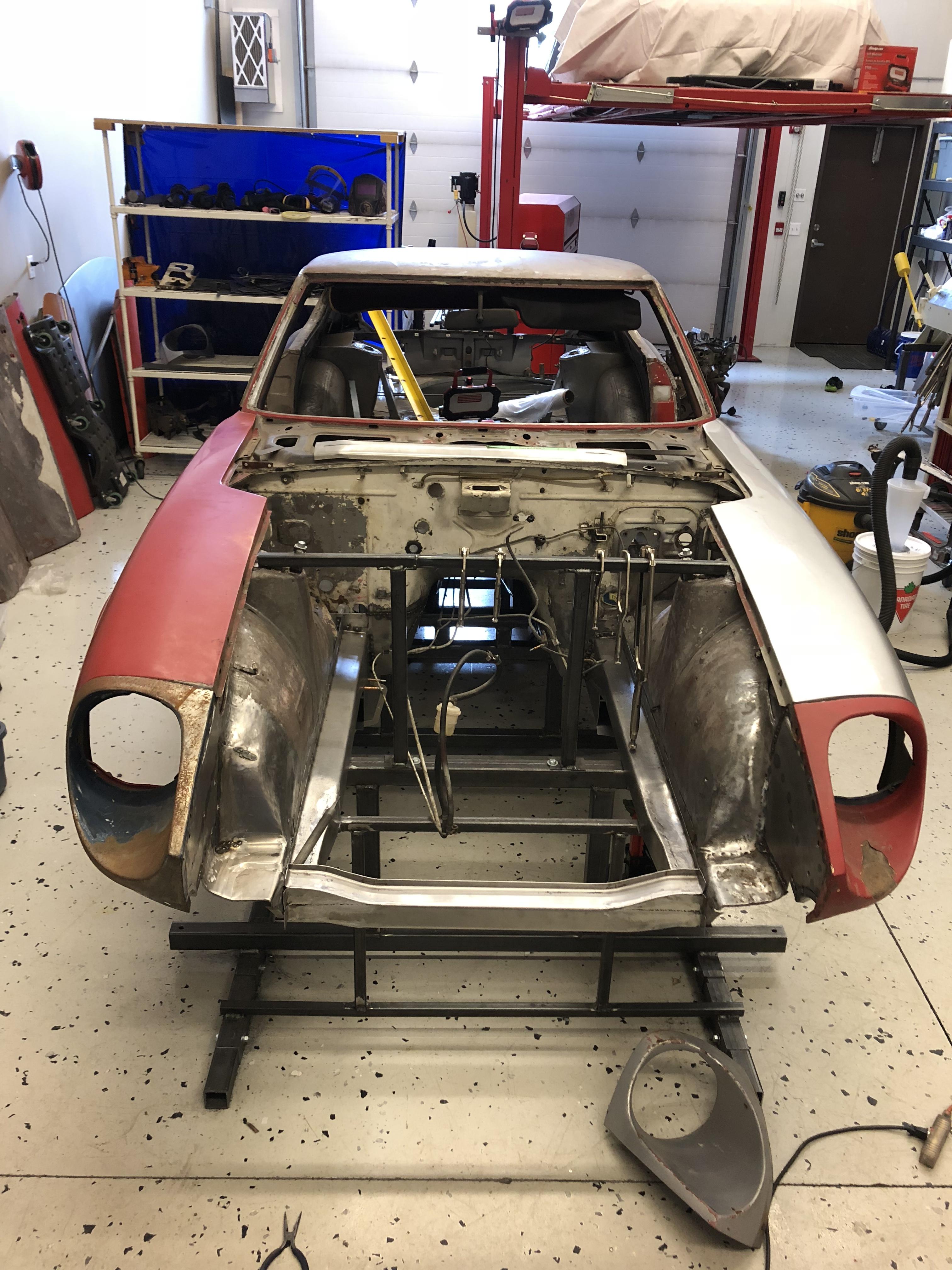

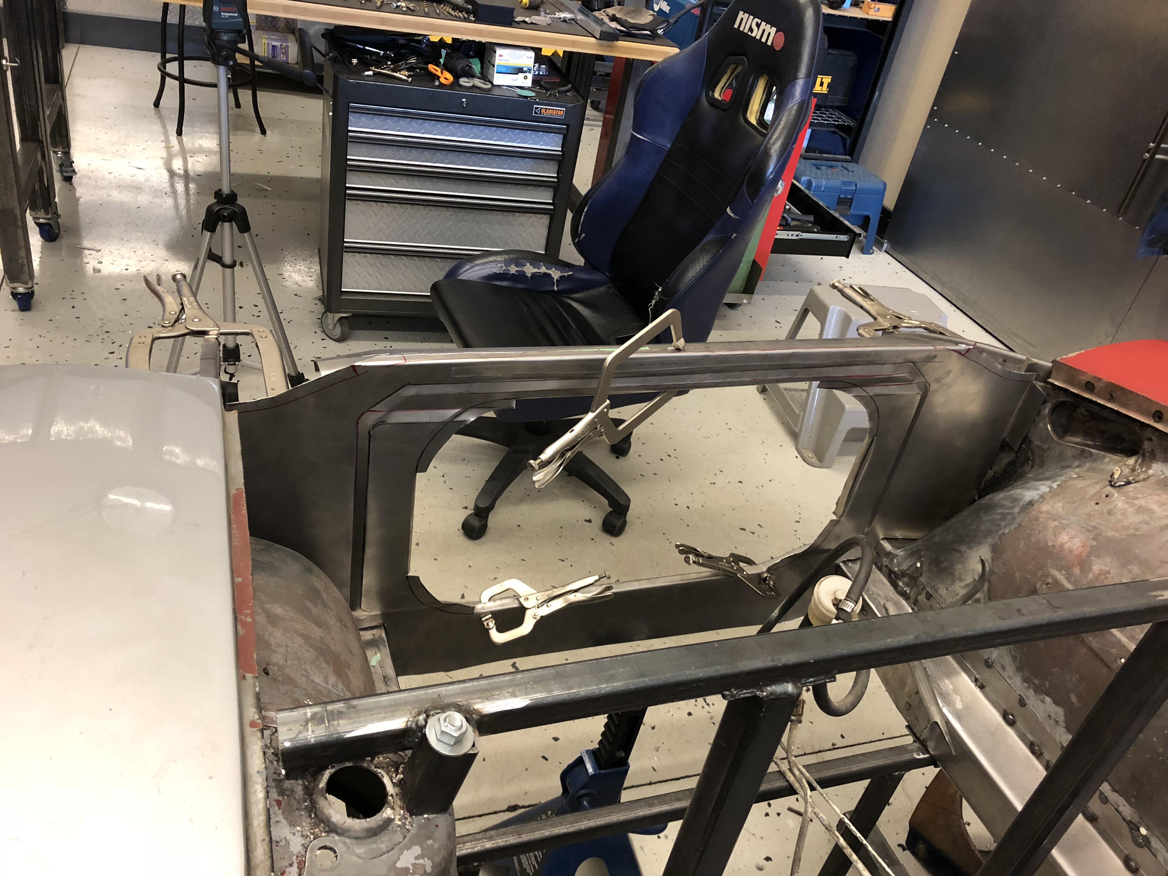

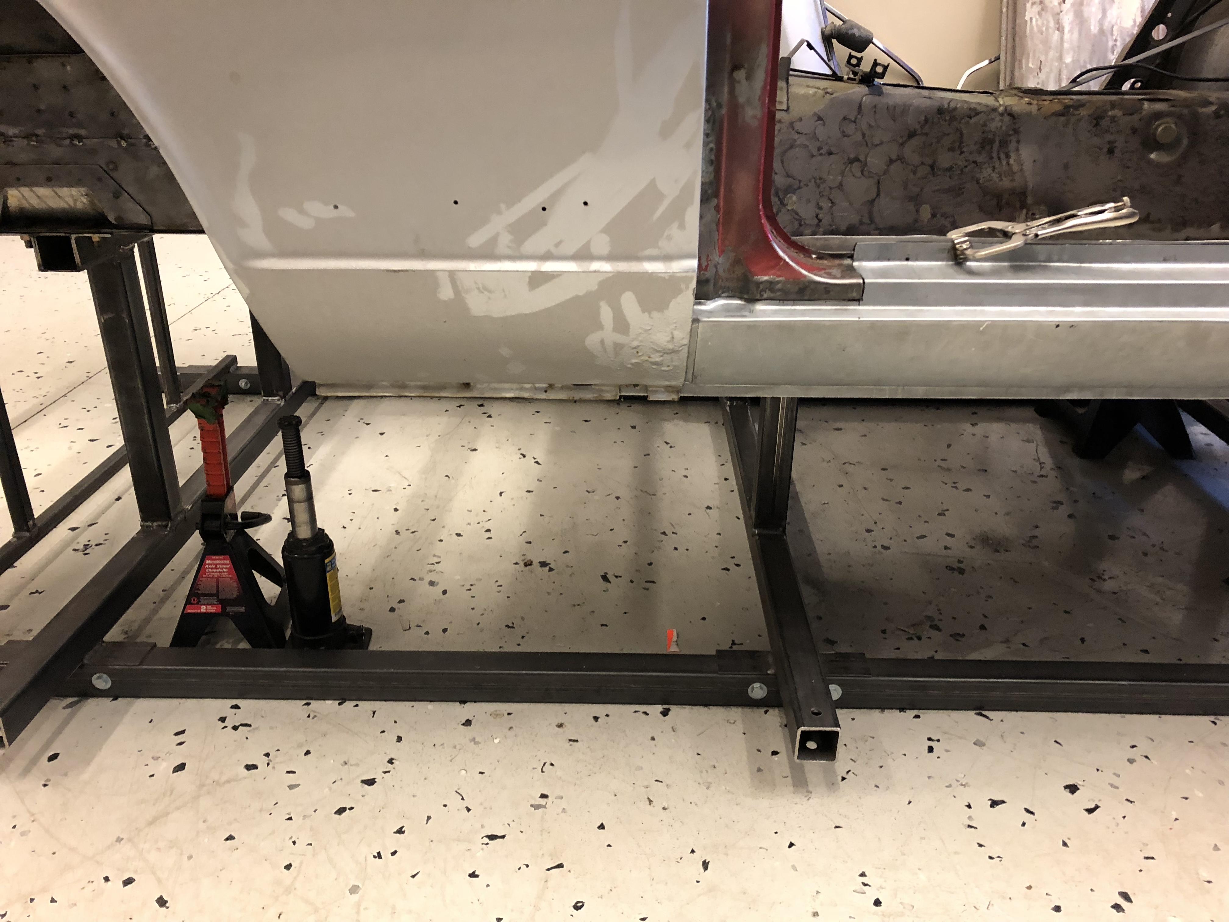

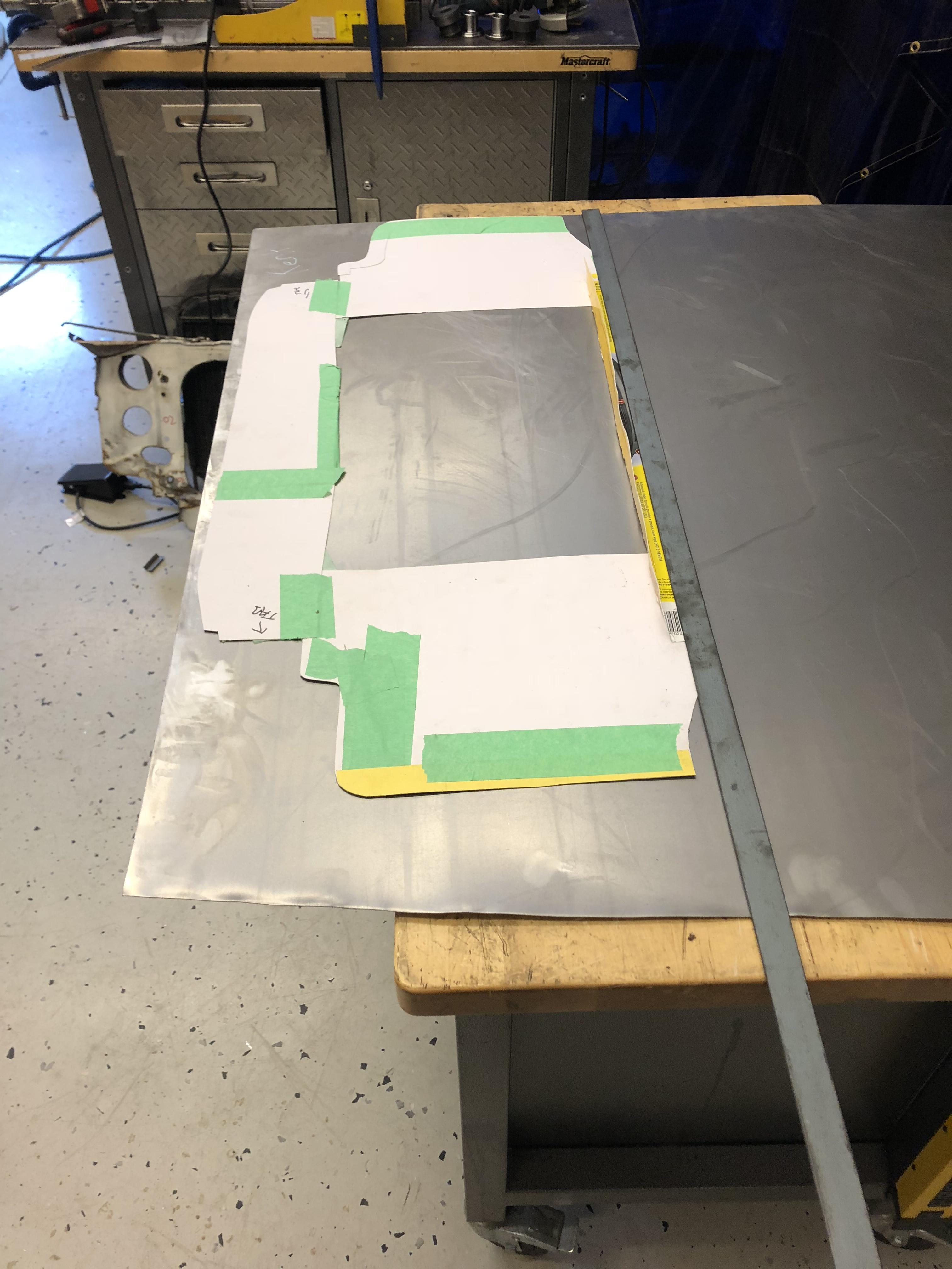

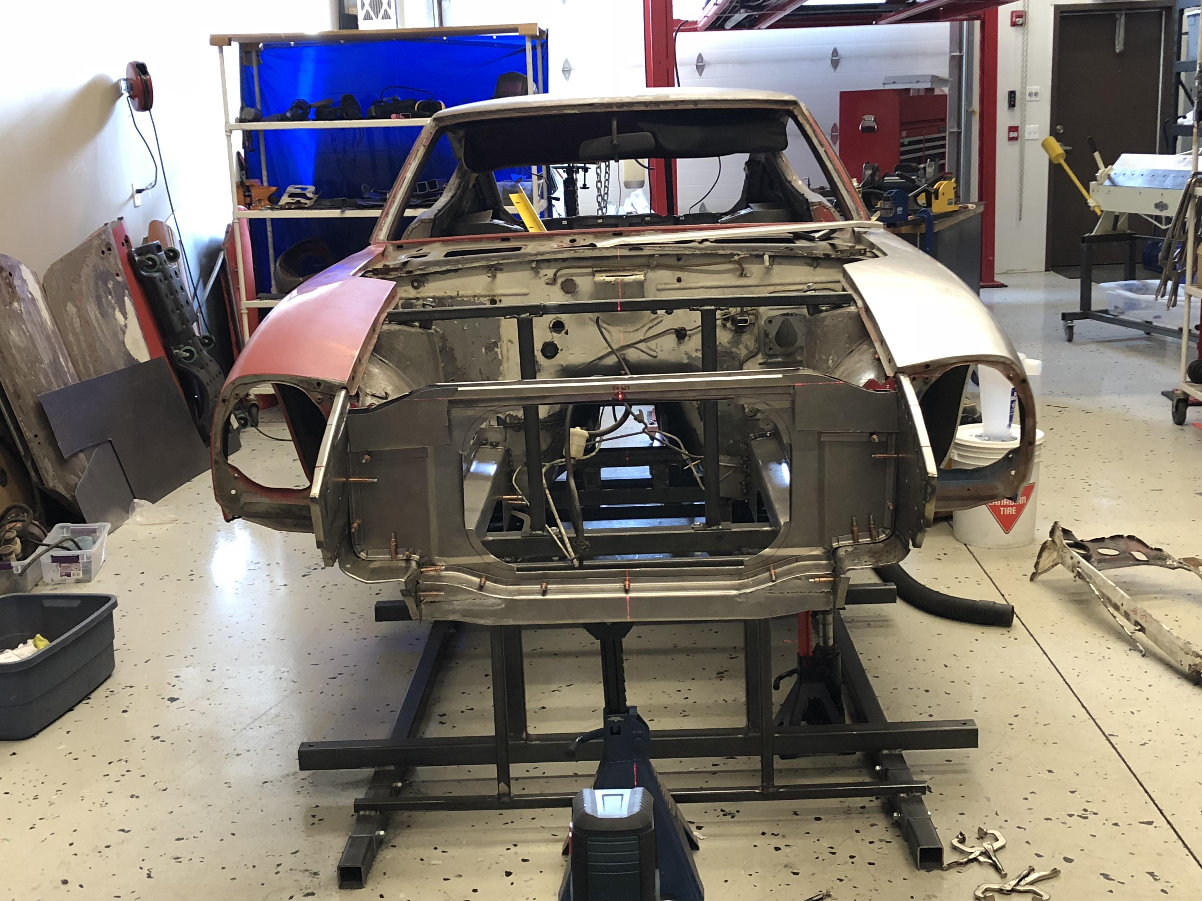

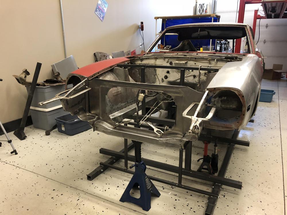

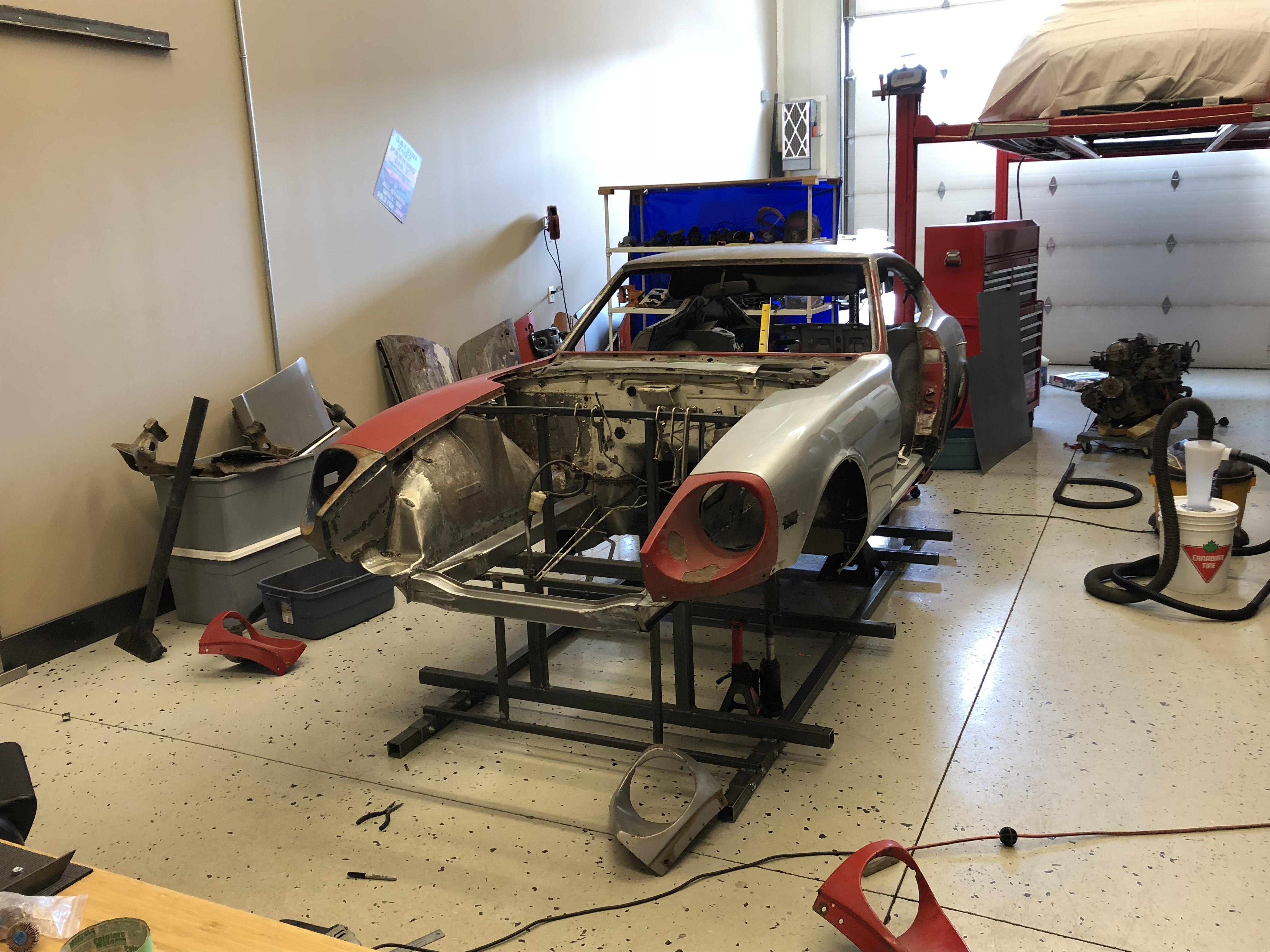

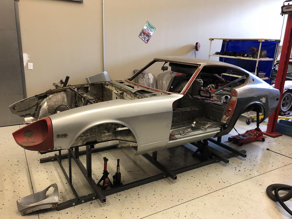

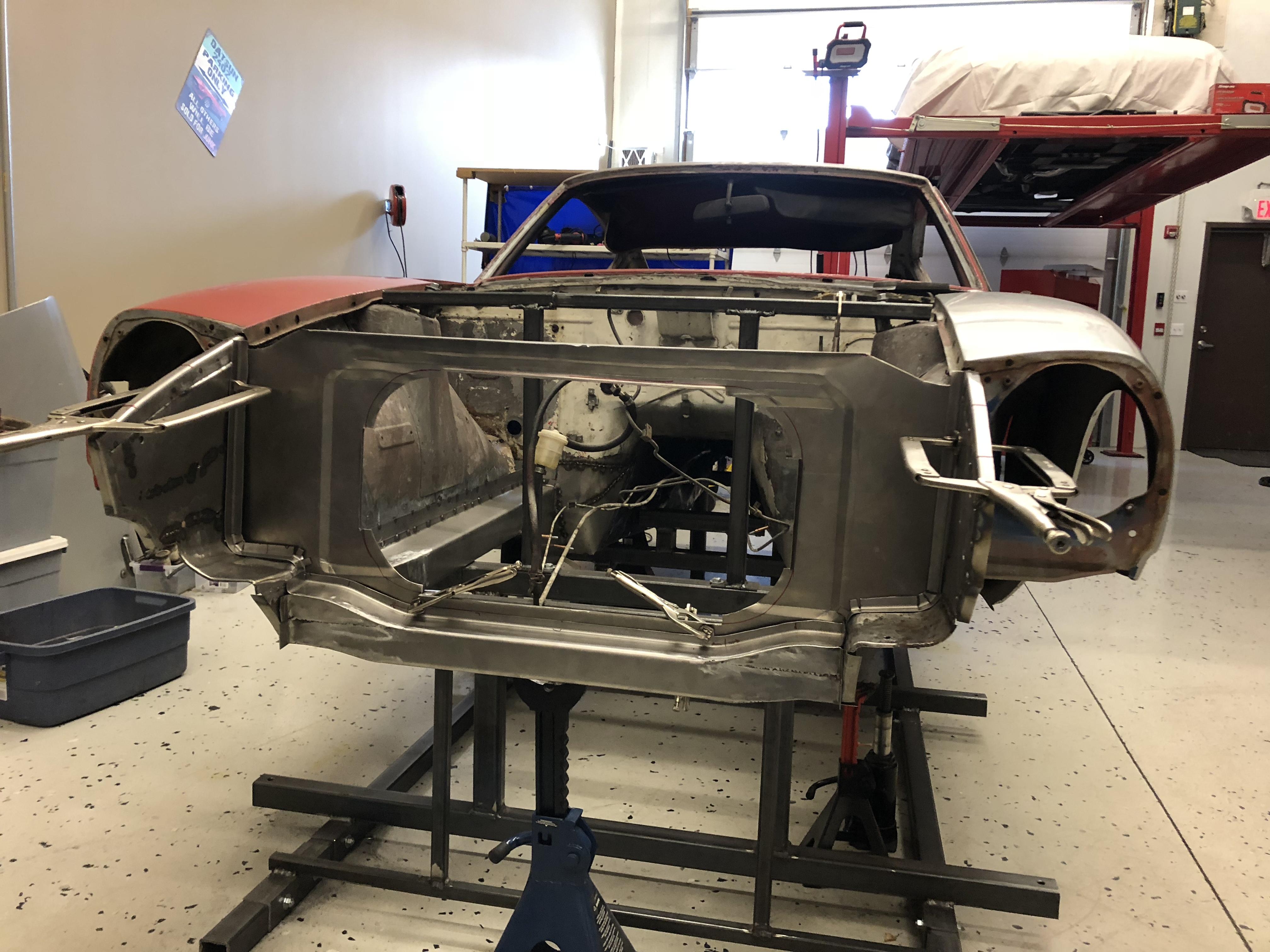

Had kind of a lazy afternoon testfitting sheet metal before welding in the rockers ....3C844836-6935-4140-B162-2BBA83317910.jpegimageproxy.php?img=&key=a75e82998c691b20
not perfect but workable ....
Nice parallel lines ...

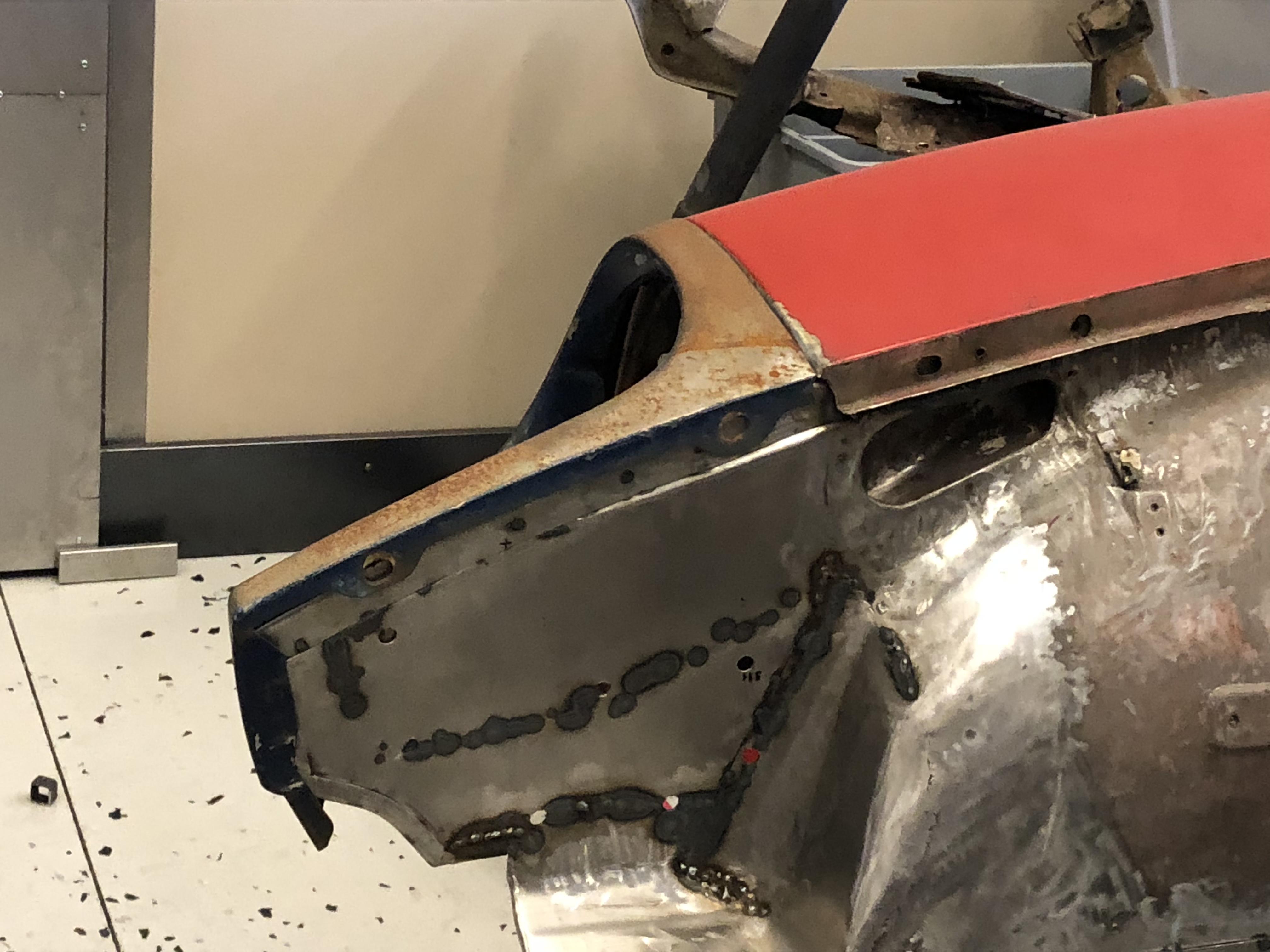

Inner fender repair fits decent ....
Funny how no two sugar scoops are identical ....

Out of curiosity (I've never looked this up), how much does a Cleco cost?  (Cdn $ please).
How many do you have in your shop? (I see 13 in use in your most recent picture, with possibly 6 - 12 more hidden from view).
What are the advantages of a Cleco over a sheet-metal screw?
Buy them in bulk on eBay etc. With the proper pliers, they snap in fast and can be removed in seconds for quick panel fitting etc.
Sheet metal screws tend to distort the metal a bit too. Cleco’s are a clean solution for metal working
So the pliers will run around $20 and the 1/8  Clecos will cost $0.50 to $0.75 cents each.  I have around 50 or 60 and the only time I got close to using them all was when I was doing floors.  kmstools and Amazon.ca have them on sale fairly regularly.
Clecos were originally developed for aircraft (which are made of aluminum and riveted together).   A pilot friend of mine put me on to them.
There are many advantages over screws.
1) no deformation of the metal (other than drilling the initial hole)
2) spring loaded - infinitely re-usable
3) perfect for the fitting process where parts are going to be attached / detached several times before final welding.  (for example the frame rails were probably on / off  a dozen times before I welded them in).
