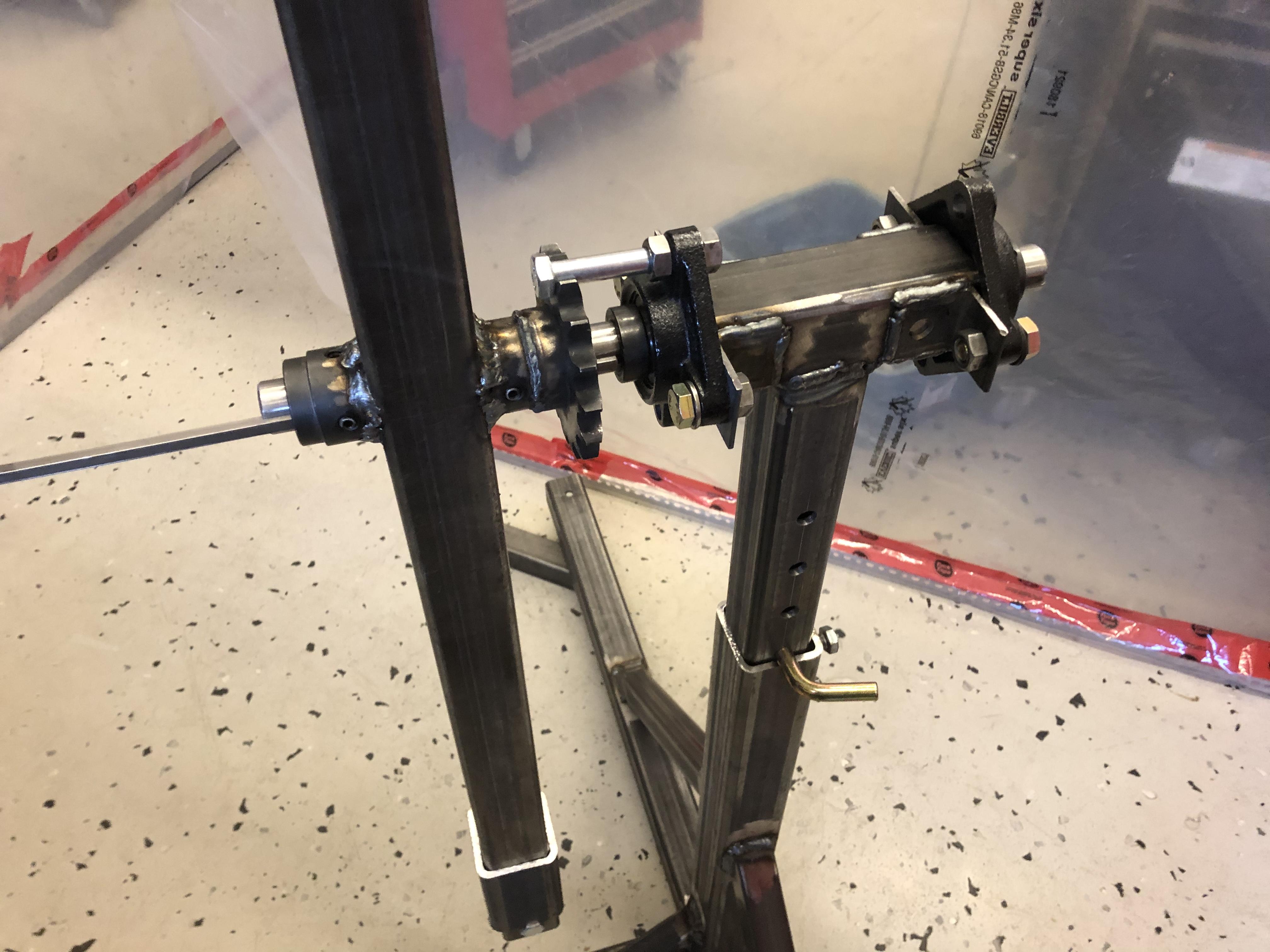

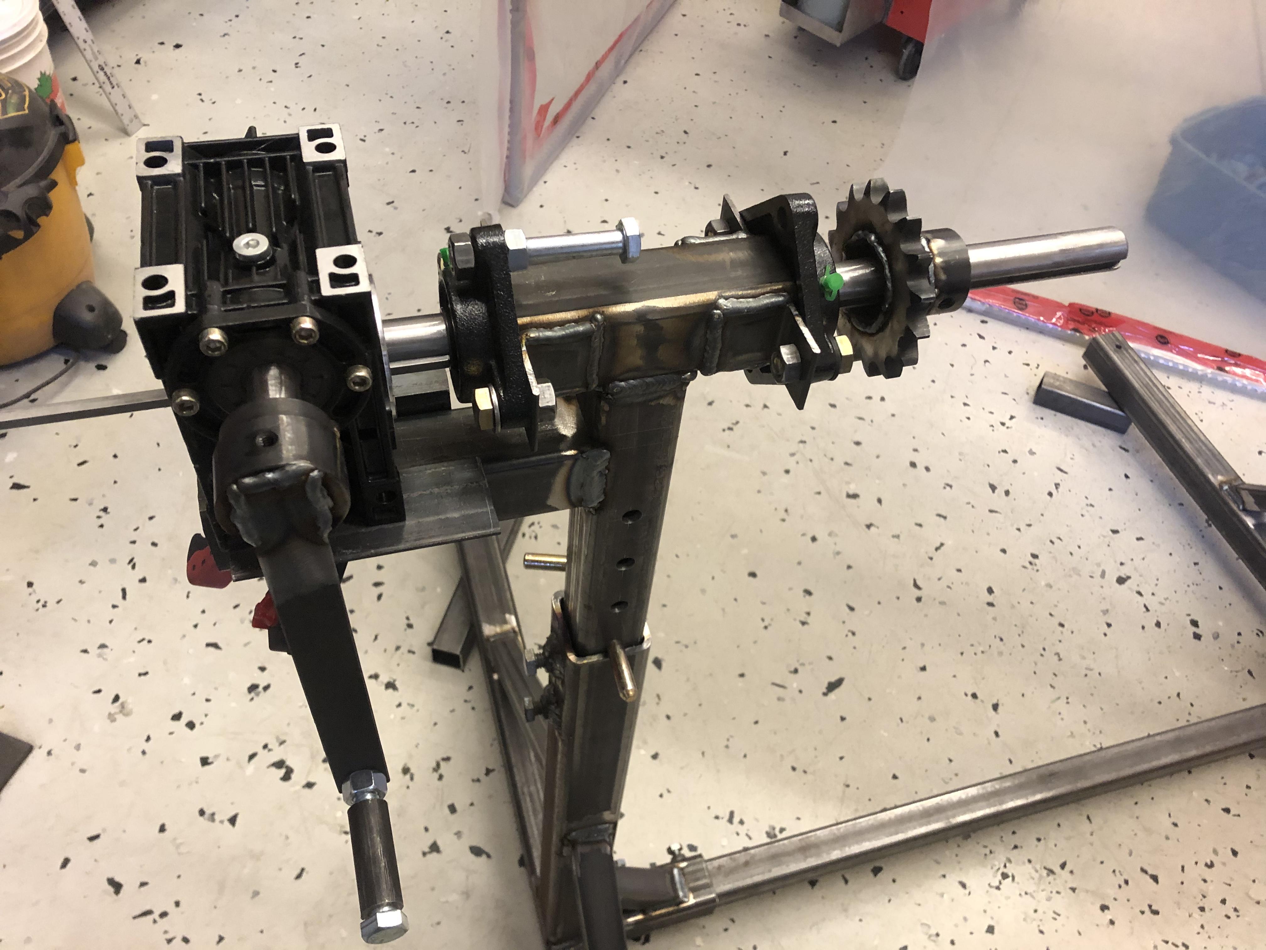

April 17, 20204 yr Author comment_597376 Managed to sneak in a few hours on the rotisserie mini-project this afternoon. Got most of my metal cut, and welded / assembled the rotator heads ... also improved the mechanical lock - basically hand tighten the nuts on both sides so the 12 mm bolt is rigid and Voila - shaft is locked .... To unlock, simply remove the inboard nut and remove the bolt ? Link to comment https://www.classiczcars.com/forums/topic/61483-240z-fabbing-new-front-rails/?&page=30#findComment-597376 Share on other sites More sharing options...

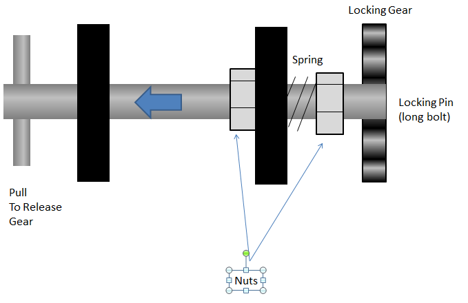

April 18, 20204 yr comment_597377 An idea: Link to comment https://www.classiczcars.com/forums/topic/61483-240z-fabbing-new-front-rails/?&page=30#findComment-597377 Share on other sites More sharing options...

April 18, 20204 yr comment_597419 Better design. Everyone wants a longer rod: Link to comment https://www.classiczcars.com/forums/topic/61483-240z-fabbing-new-front-rails/?&page=30#findComment-597419 Share on other sites More sharing options...
April 18, 20204 yr Author comment_597440 So thanks for the ideas but I figured out that the spring lock won't really work... The idea will be to rotate the shaft (and the mounted car) using the worm gear. So if the lock is spring loaded, it will automatically lock at each notch and have to be reset. In theory the worm gear will hold the car in place indefinitely and certainly long enough to manually set the locks at each end. Now that I think about it, one would encounter the same problem with the spring loaded locks even if rotating the car by hand ... Link to comment https://www.classiczcars.com/forums/topic/61483-240z-fabbing-new-front-rails/?&page=30#findComment-597440 Share on other sites More sharing options...

April 19, 20204 yr comment_597474 On 4/18/2020 at 9:02 PM, ConVerTT said: So thanks for the ideas but I figured out that the spring lock won't really work... The idea will be to rotate the shaft (and the mounted car) using the worm gear. So if the lock is spring loaded, it will automatically lock at each notch and have to be reset. In theory the worm gear will hold the car in place indefinitely and certainly long enough to manually set the locks at each end. Now that I think about it, one would encounter the same problem with the spring loaded locks even if rotating the car by hand ... The rods and springs are meant to easily and quickly pull out and re-seat. You can forget the springs. Saves you having to use wrenches. Link to comment https://www.classiczcars.com/forums/topic/61483-240z-fabbing-new-front-rails/?&page=30#findComment-597474 Share on other sites More sharing options...

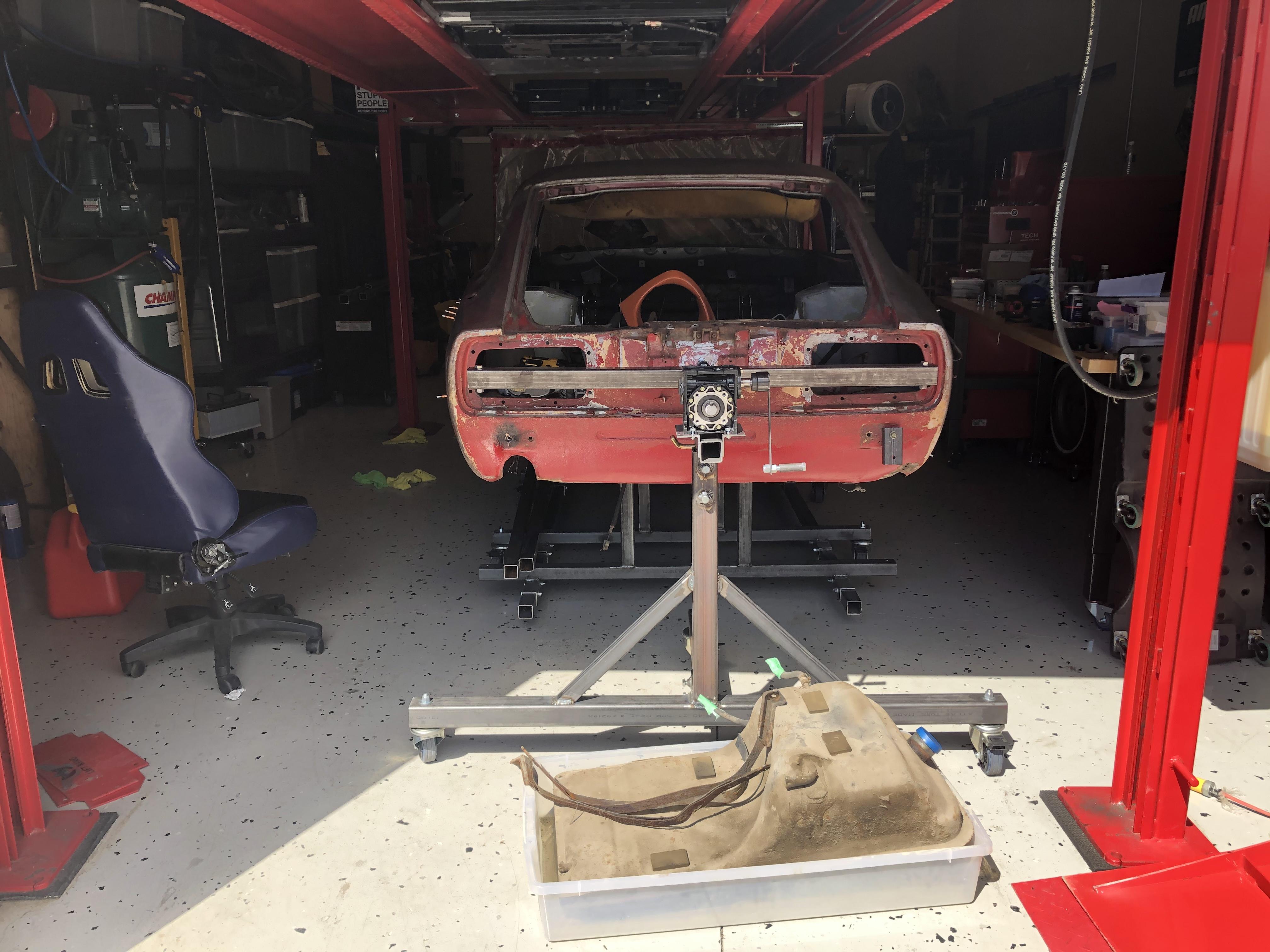

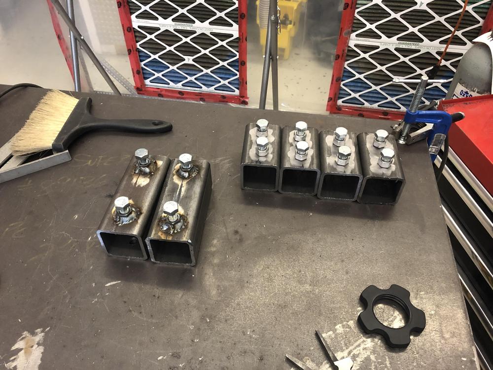

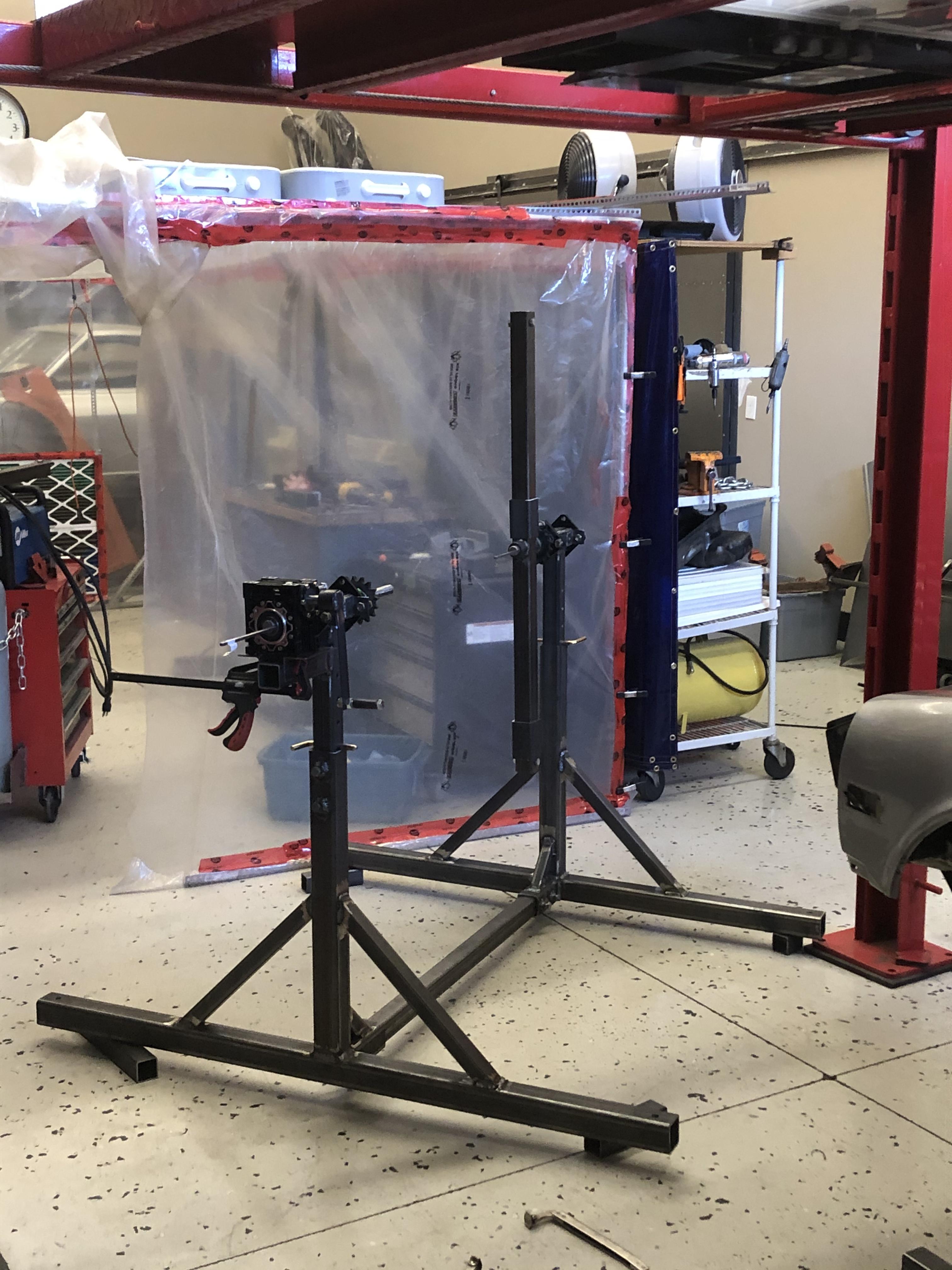

April 20, 20204 yr Author comment_597563 Made good progress on the rotisserie today! Tried to power through and finish it but ran out of gas ...oh well ... Worm drive up and running ... And one of the crossbars welded in ... Gotta weld up the other crossbar and then start laying out the attachment brackets .... Link to comment https://www.classiczcars.com/forums/topic/61483-240z-fabbing-new-front-rails/?&page=30#findComment-597563 Share on other sites More sharing options...

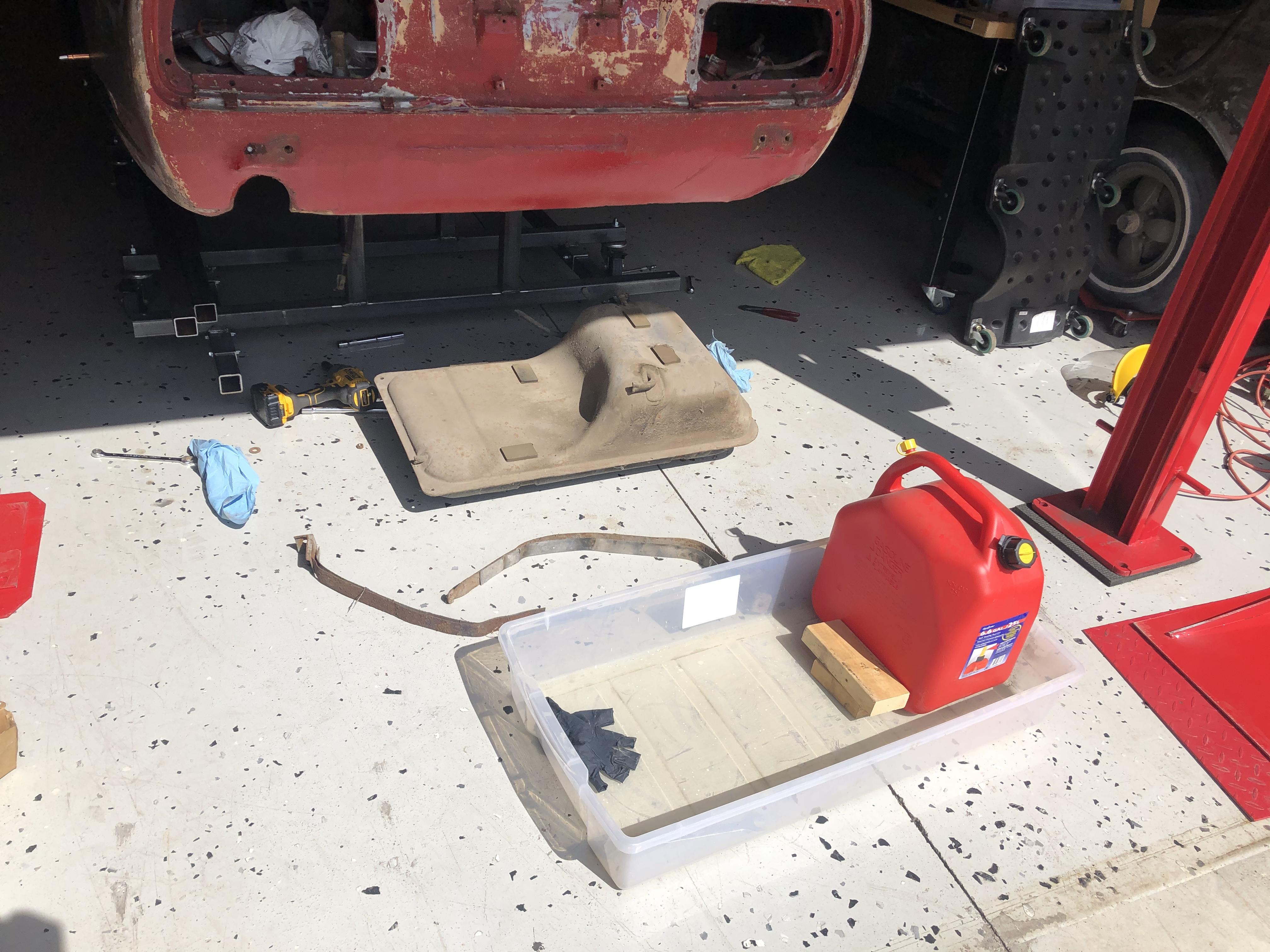

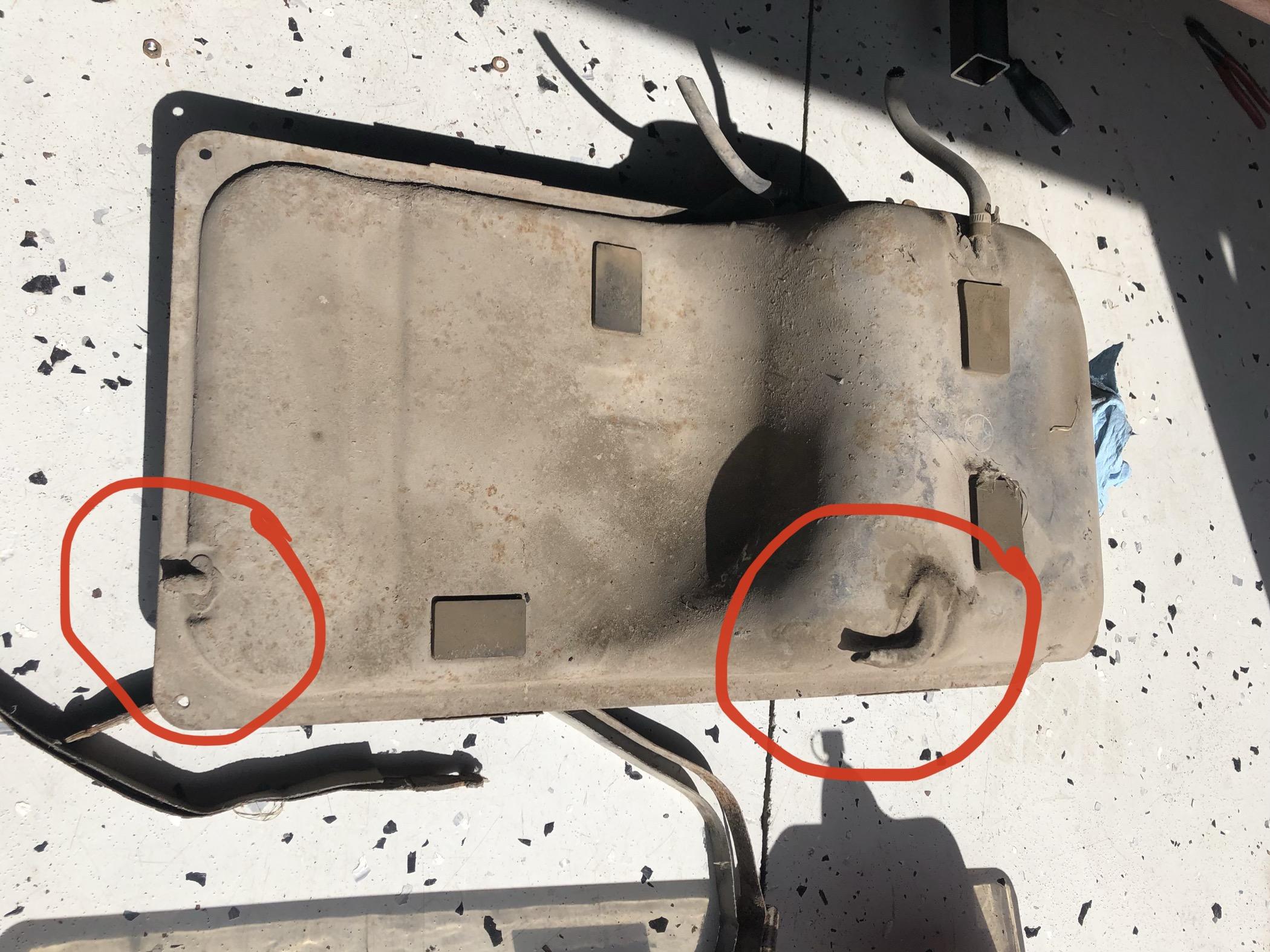

April 23, 20204 yr Author comment_597857 So I ran out of mig wire during my least favorite welding activity ...welding jam nuts ... So that sucked ... I had set the day aside to weld up brackets and finish the rotisserie .. oh well ? So I moved on to dropping the gas tank and inspecting the rear bumper brackets ... It was disappointingly easy ... It looks the tank has been modded slightly - the circled ports have been crimped and welded shut. Is this some kind of venting bypass? Off to get some mig wire before they close hopefully .... Edited April 23, 20204 yr by ConVerTT Link to comment https://www.classiczcars.com/forums/topic/61483-240z-fabbing-new-front-rails/?&page=30#findComment-597857 Share on other sites More sharing options...
April 24, 20204 yr comment_597882 Yes, those ports originally connected to hoses that lead up to the vapour recovery/expansion tank behind the passenger side c pillar. The following article shows the way the original system was "plumbed" along with an alternative solution - which appears to be what a previous owner was attempting on your tank. http://zhome.com/Racing/FuelTankVaporLineMod/FuelTankVaporMod.htm Hope this helps... and you were able to get yourself "wired". Link to comment https://www.classiczcars.com/forums/topic/61483-240z-fabbing-new-front-rails/?&page=30#findComment-597882 Share on other sites More sharing options...
April 24, 20204 yr Author comment_597883 On 4/24/2020 at 4:14 AM, Persimmon240 said: Yes, those ports originally connected to hoses that lead up to the vapour recovery/expansion tank behind the passenger side c pillar. The following article shows the way the original system was "plumbed" along with an alternative solution - which appears to be what a previous owner was attempting on your tank. http://zhome.com/Racing/FuelTankVaporLineMod/FuelTankVaporMod.htm Hope this helps... and you were able to get yourself "wired". Thanks Persimmon... That looks like what the PO must have attempted. But he used the small 10 mm port as a vent, and routed it back to the filler neck without any additional T. The vent tank has been removed ... hmmm - not the best .... Thanks for the link. Link to comment https://www.classiczcars.com/forums/topic/61483-240z-fabbing-new-front-rails/?&page=30#findComment-597883 Share on other sites More sharing options...
