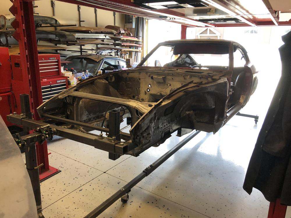

ConVerTT Posted April 30, 2020 Author Share #385 Posted April 30, 2020 I am thinking that careful pressure washing can't hurt..... I am thinking of making a tow bracket out of leftover square tube and then just rolling the whole rotisserie right outside with my truck. Then just carefully pressure wash the bad areas and dry it with the leaf blower. Roll it back it and then media blast with glass bead... (The tow hitch is really to use the truck to push it back up the grade into the garage. I am sure it will roll out just fine ?) Link to comment Share on other sites More sharing options...

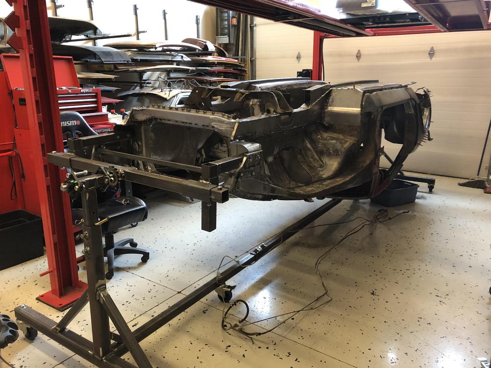

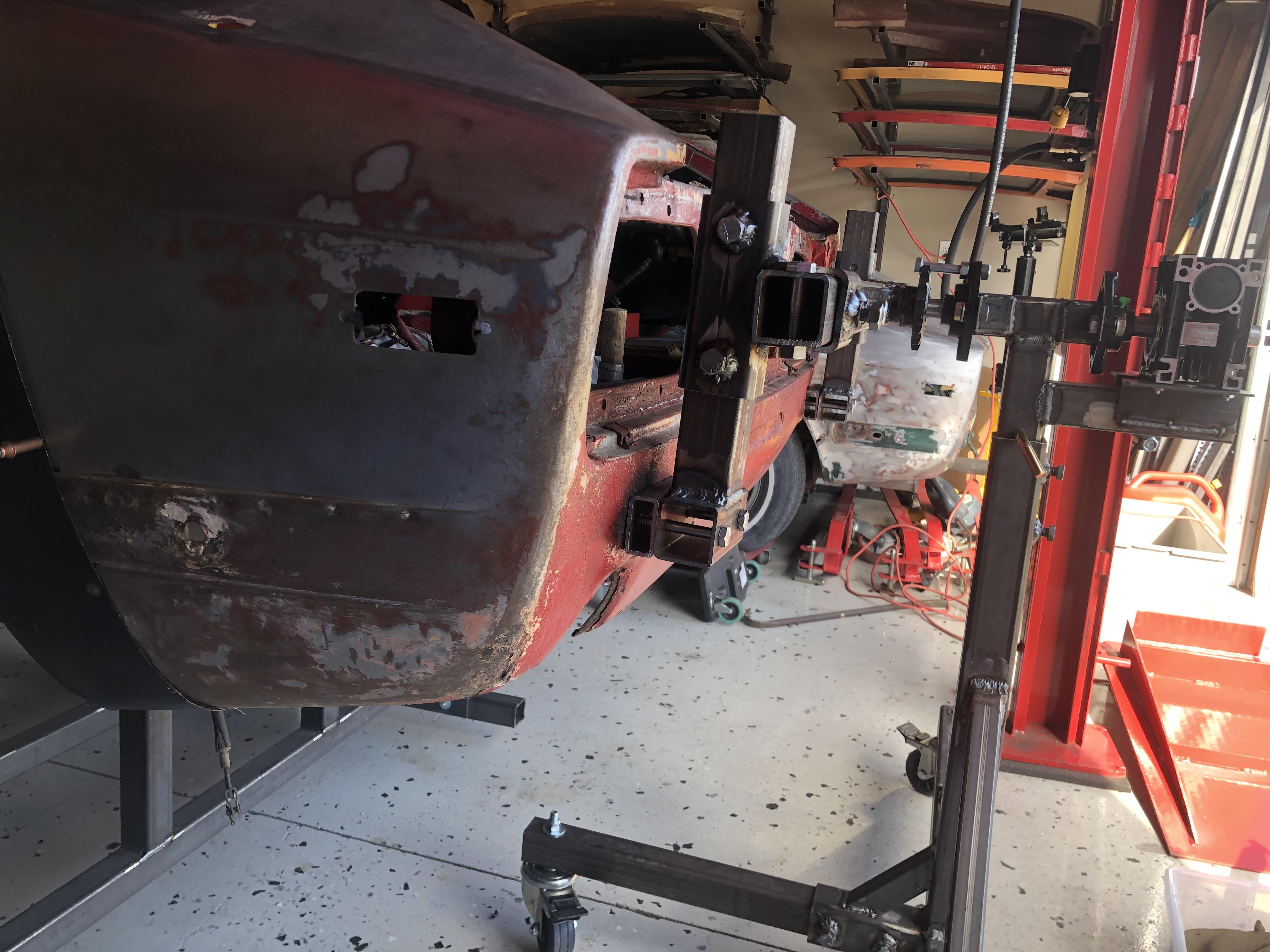

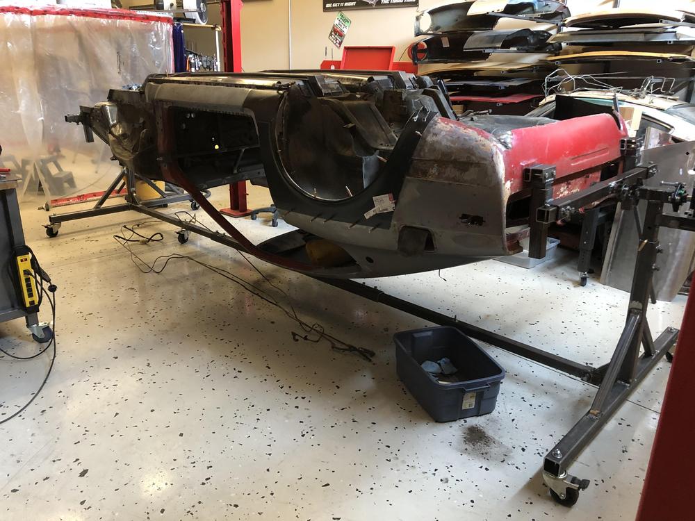

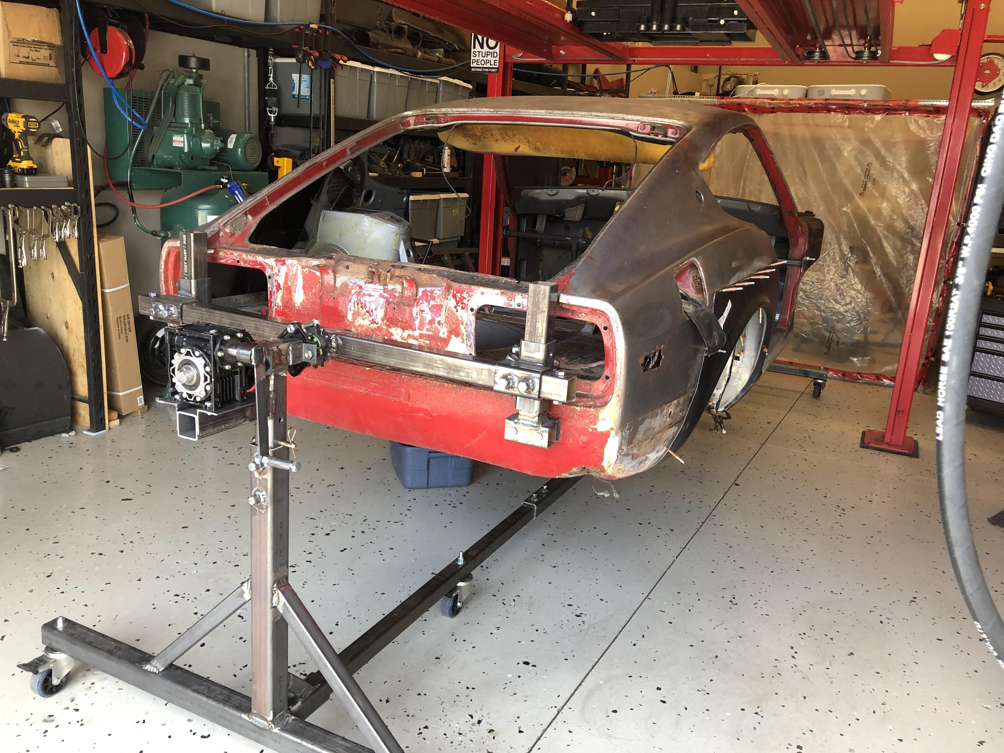

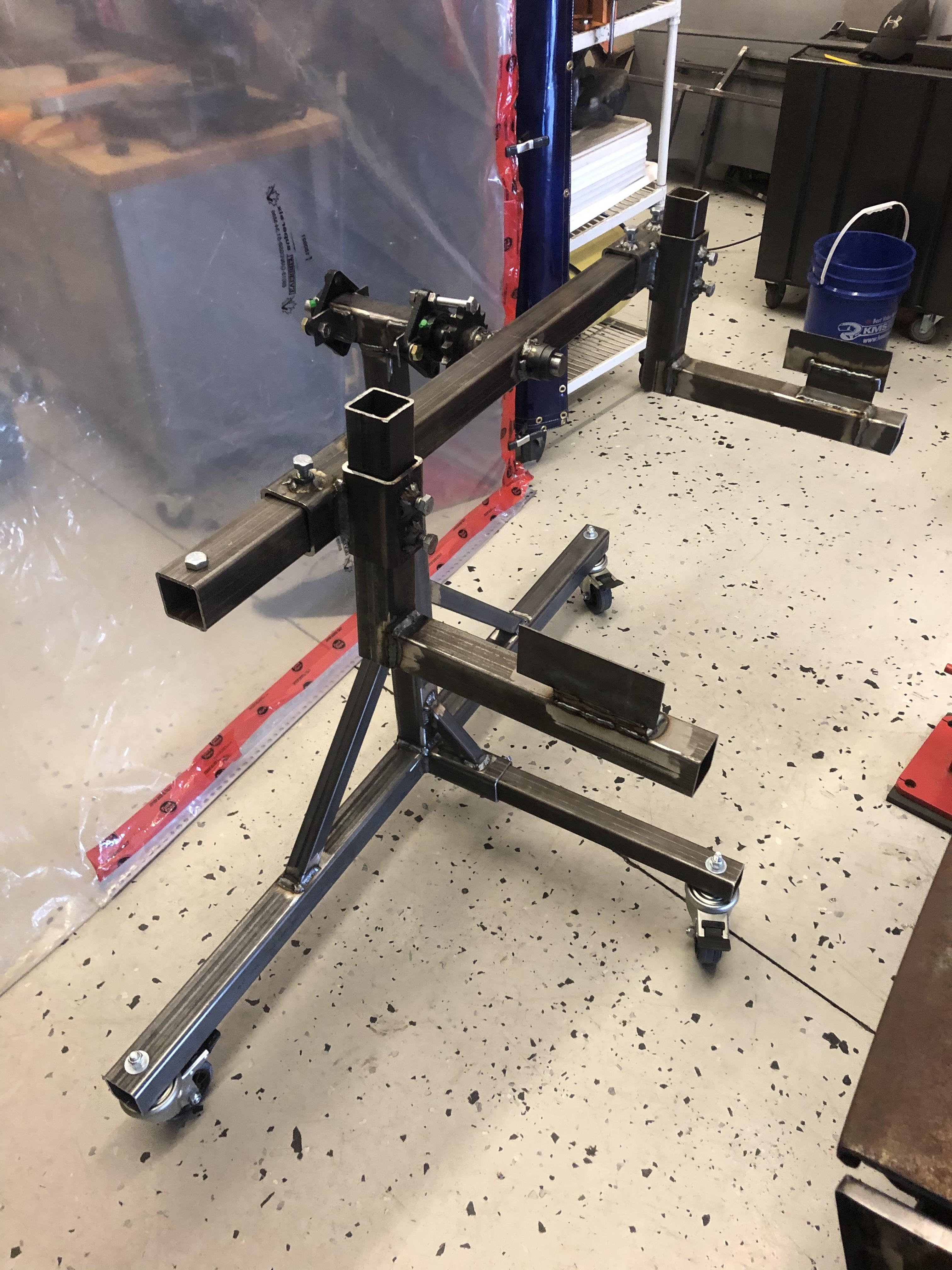

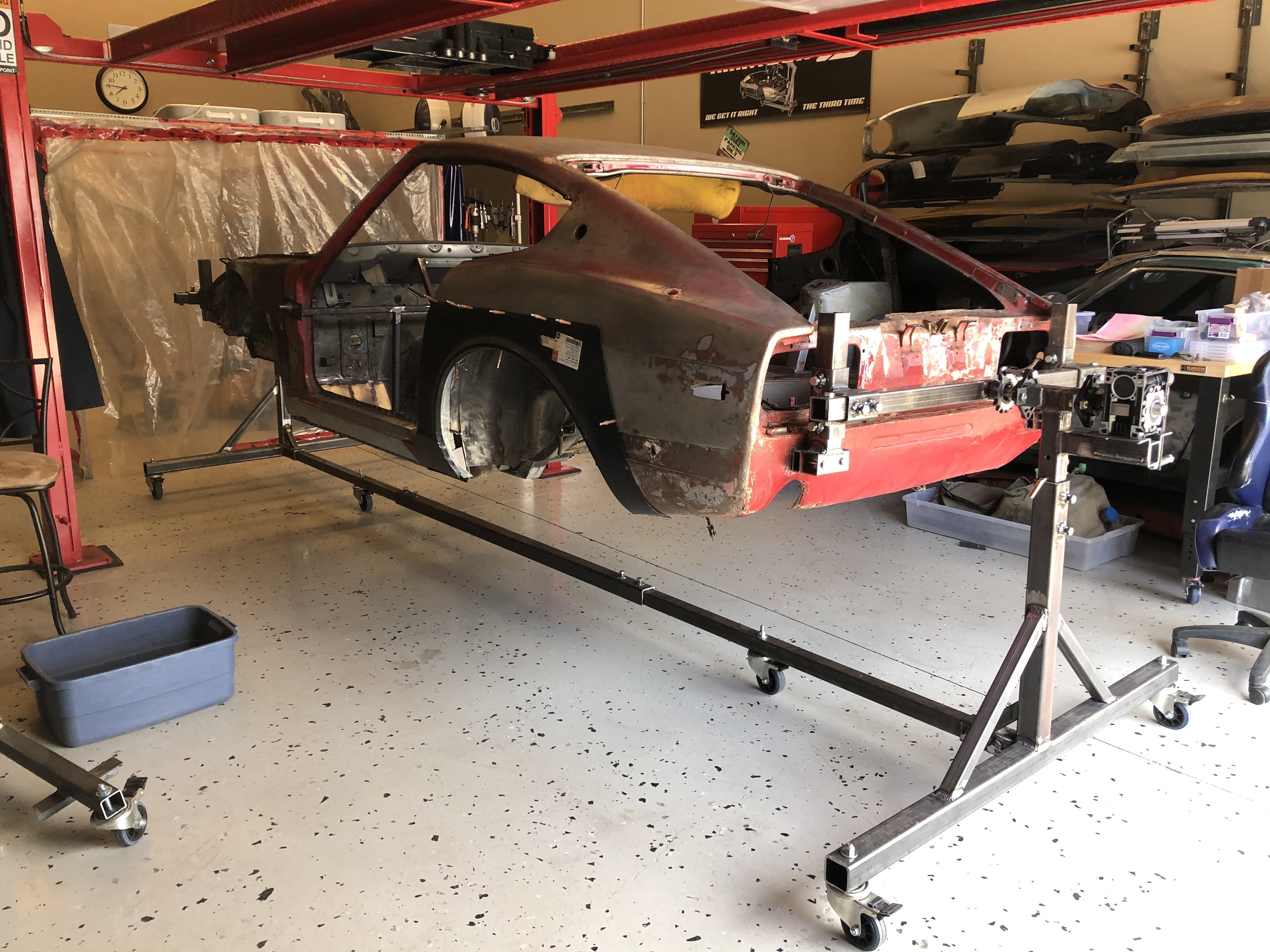

ConVerTT Posted May 2, 2020 Author Share #386 Posted May 2, 2020 (edited) So I repositioned the car a bit on the rotisserie to get better balance. It was fine side to side, but I could feel the weight increase as I rolled it to the vertical position - meaning that it was bottom heavy. Or the center of gravity of the shell was too low relative to the rotating axis. So I moved the car up about 2". For reference: The mounting bolts are 3 inches below the axis of rotation in the front and 5 inches below the axis of rotation in the back. The car is still very slightly bottom heavy (on purpose - safer) but she rolls over well by hand (with one hand) or with the worm gear.... so I probably spent around $350 on steel, $200 on the worm gear, bearings, drive shaft and pinion gears, $50 on bolts and hardware, and I already had the casters laying around - maybe $60 or so. So around $650 in round numbers not including shop supplies... Let the games begin ??? Edited May 2, 2020 by ConVerTT 1 Link to comment Share on other sites More sharing options...

ConVerTT Posted May 4, 2020 Author Share #391 Posted May 4, 2020 Pulled all the fuel and brake lines and finally got to flip it all the way upside down. It will be so luxurious to finish up the rust repair and seam welding like this …??? 1 Link to comment Share on other sites More sharing options...

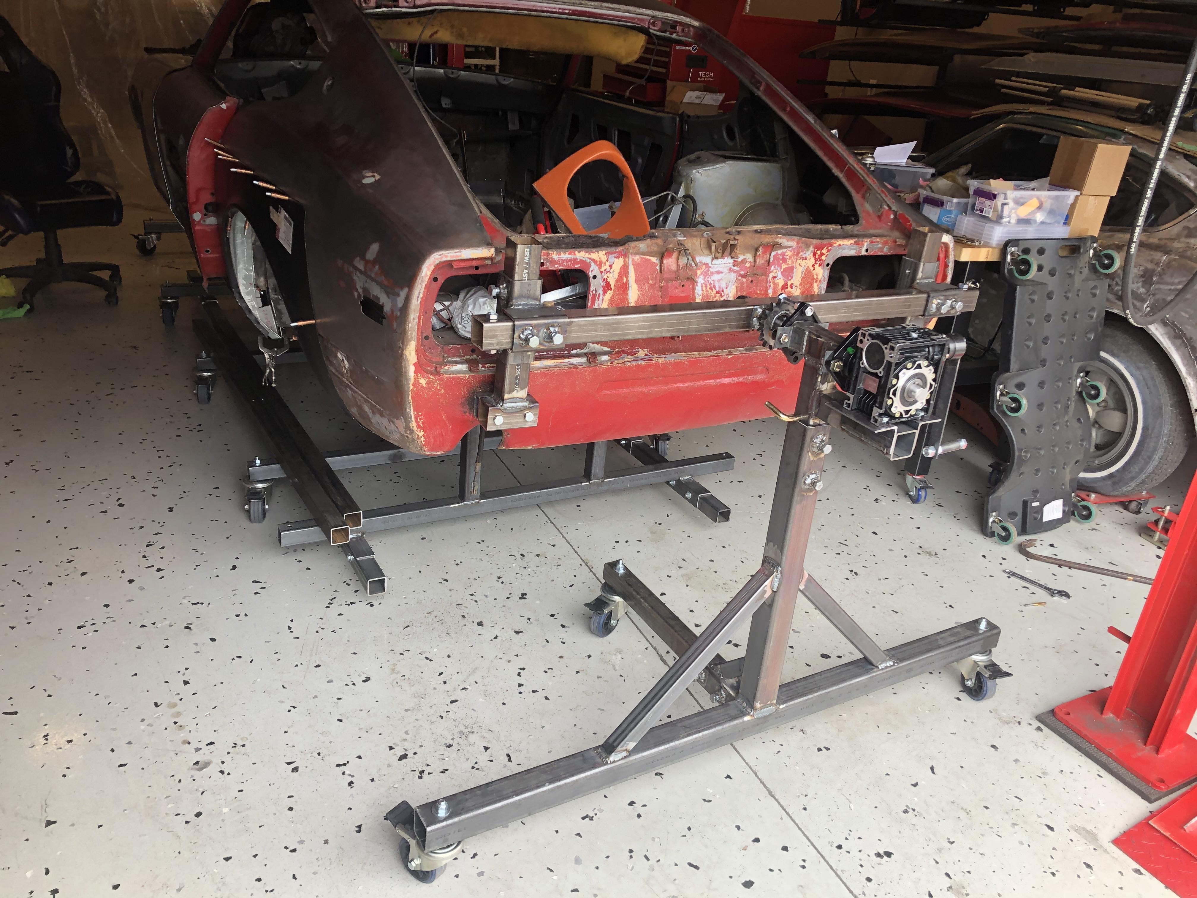

240ZBUILTBYME Posted September 14, 2020 Share #392 Posted September 14, 2020 On 4/26/2020 at 9:44 AM, ConVerTT said: Back to welding up the rotisserie...today was brackets, brackets, brackets.... The rear bumper mounts have definitely seen better days, but things seemed pretty rigid once the jam nuts were tightened up .... Meanwhile up front .... I added an additional plate so I can attach the front to both the bumper mounts and hood hinge mounting points... Still need to drill the mounting holes but it should line up something like this ( with the hood off the car of course ).... getting closer - woohoo! Hi Mate! Can I just say that this is one of my favorite build threads ever... I have read through it about 10 times. you are one skilled human being.... but enough arse kissing, just wondering what the final height from Floor to pivot point for your rotisserie? Am about to replicate your chassis frame very soon! So thanks for posting all the plans and measurements Link to comment Share on other sites More sharing options...
ConVerTT Posted September 15, 2020 Author Share #393 Posted September 15, 2020 9 hours ago, 240ZBUILTBYME said: Hi Mate! Can I just say that this is one of my favorite build threads ever... I have read through it about 10 times. you are one skilled human being.... but enough arse kissing, just wondering what the final height from Floor to pivot point for your rotisserie? Am about to replicate your chassis frame very soon! So thanks for posting all the plans and measurements Haha - thanks a bunch. The pivot is at 41 inches when the rig is on 5 inch casters. Cheers Link to comment Share on other sites More sharing options...
