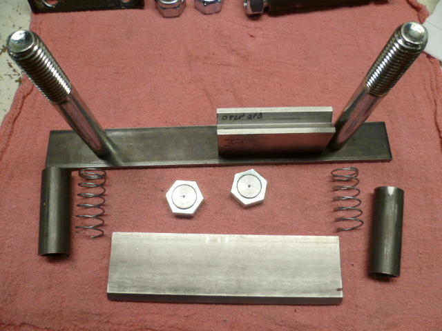

That press brake is only maybe eight inches or so long, but I'm very happy with the way it turned out. I saw the idea on the web and made up the details as I went along. Of course, as with most project, the details are where the magic is.
One longer spring I cut into two halves. Two bolts (5/8-11 I think) with the heads cut off for the guide pins. Nyloc nuts (not in pic) to adjust and hold position for different stock thicknesses. I made the bottom die shorter than the top on purpose so it functions like a finger brake with some of the fingers removed. That way I can hang the unbent portion out of the dies and keep a section straight. Here's a pic of most of the parts before final assy:

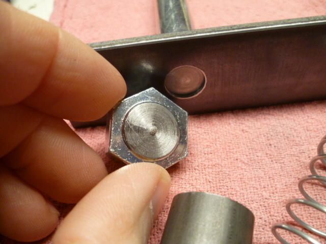

I cut the bolt heads off on the lathe and turned a counterbore shoulder. That way I can press the bolts into the base and the shoulder will make sure they are perpendicular (normal). The shoulder is a little shorter than the base thickness so the bottom is recessed. That way I can tack weld the bolts into place from underneath and the base will still sit flat:

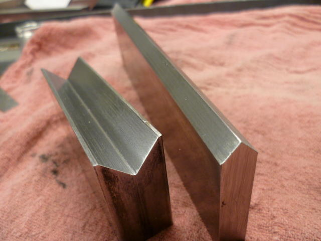

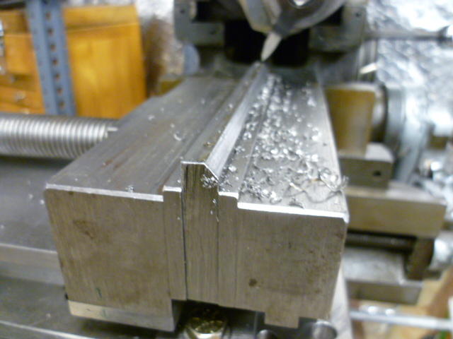

I made the dies on my metal shaper. Here's an action shot cutting the first side of the upper die:
And here's the two finished. They really should be hardened for longer life, but I'm kinda hoping that with the few bends I make, it'll last long enough without heat treat:

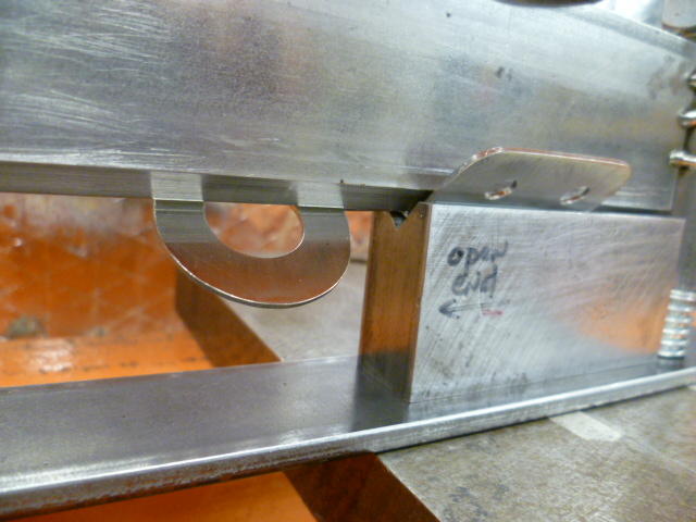

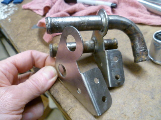

So far it's been a great little tool and has enabled me to make such beauties as this:
And this:
