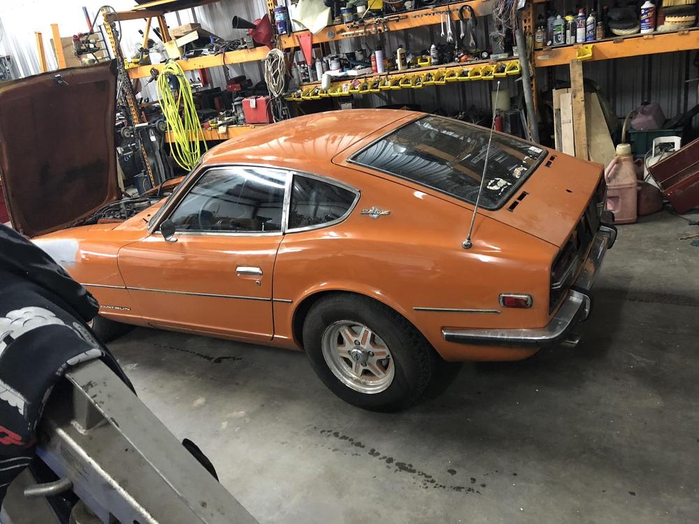

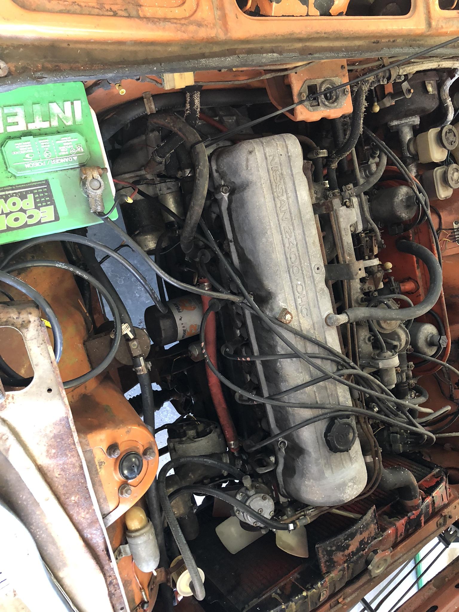

Here’s some more pics of the car including the frame rail under the battery tray and where the condensate drain tube drips onto the frame
I will throw it up on the lift tomorrow and take more photos of the car underside as well as video the engine running the SU need adjusting but I’ve got it running pretty good not perfect but decent.

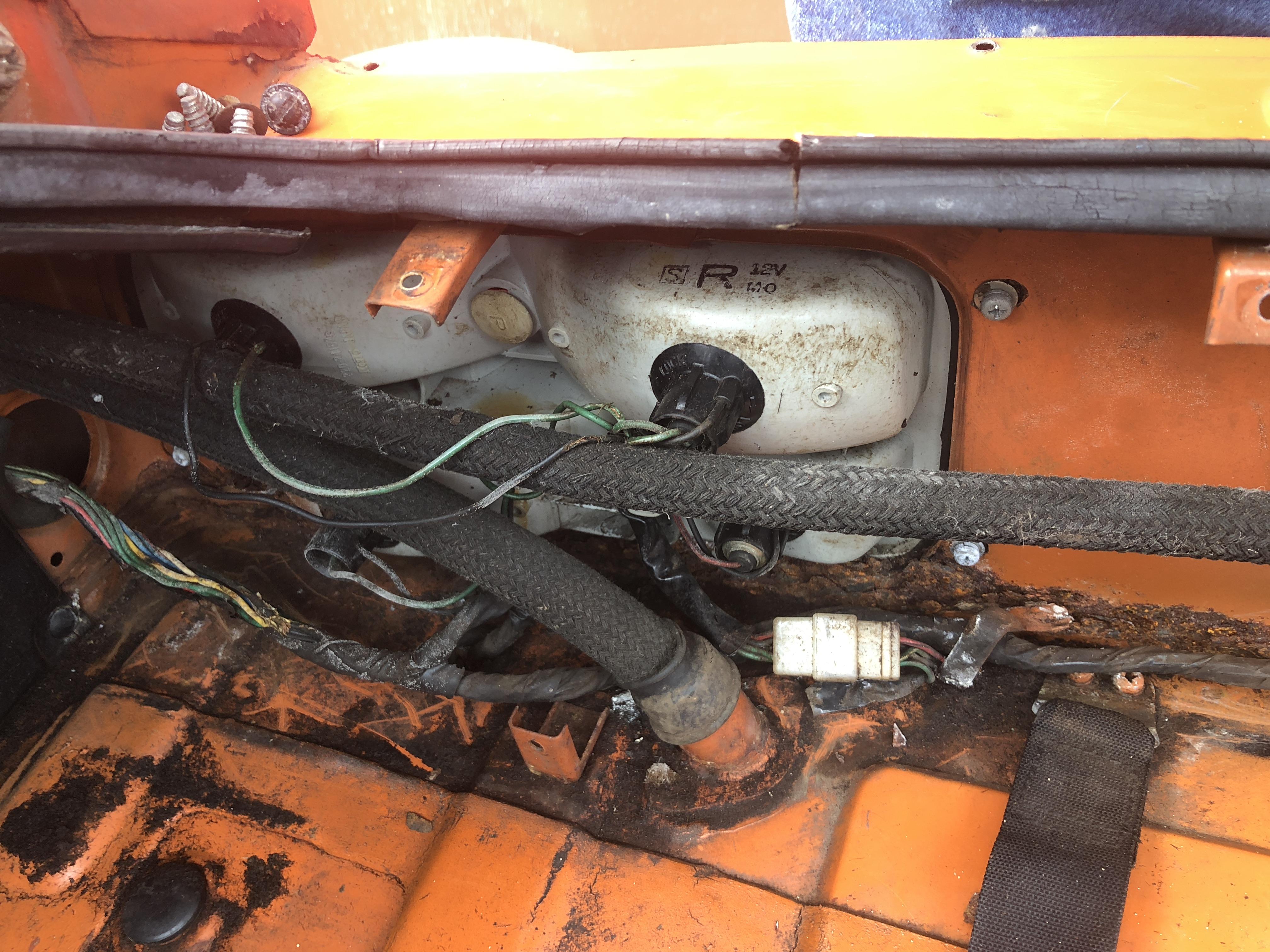

The new pics show perforation of the firewall adjacent to the top of the battery, which is unusual. Usually what happens is battery acid drips down onto the inner fenderwell right under the battery, and that perforates. But the last pic doesn't show any perforation, which is a big plus. That area can be fixed, but if you want it to look right you need to have someone with an English wheel form new metal to replace the perforated metal under the battery that needs to be cut out, and that takes skill and $$.
With this car what needs to be done is to cut out the perforated and thinned firewall area and weld in a new firewall section. If you can get the area that's needed from a donor car that should not be too much trouble. The rest of the pics that Snaponfitz is going to add should show whether the frame rails are OK. If OK then the body shouldn't be too big a job, since some of the areas that often rust, like the narrow horizontal panel at the rear of the hatch opening, isn't rusted, and the rockers look OK from what the pics show.
It needs a LF fender and the 2 headlight scoops, plus probably all of the rubber seals. By that time you might as well get it repainted in 918 orange, one of the best first year colors.

I have a parts car that has the same rust over the top of the battery tray.  The battery tray and surrounding area were fine.
According to a body mechanic, it is a very easy fix since it is flat metal for the most part.  In my case it was caused by the cowl drains getting clogged with leaves and presumably exhaust gases coming from the caps of the battery.

@87mj  You could be right about the cowl drains being clogged. The question is how thin is the firewall metal around the perforation. If the surrounding metal is thin, especially below the perforation, and if you want to keep the stamped pattern of the firewall, then you would need to source part of another good firewall for the fix. If the stamped firewall pattern doesn't matter, then a piece of flat sheet metal will do. But if I were paying up for skilled work on the firewall I would want to source a solid piece of real Z car firewall so the finished area would look right. It depends on whether someone wants to just fill the hole or have it be right for when the car gets sold. If the car is ever offered on BaT, say, there will be viewers who will pick up on a flat firewall, and then probably start to wonder what other shortcuts were take. It depends on what you want the car to be when it's done.

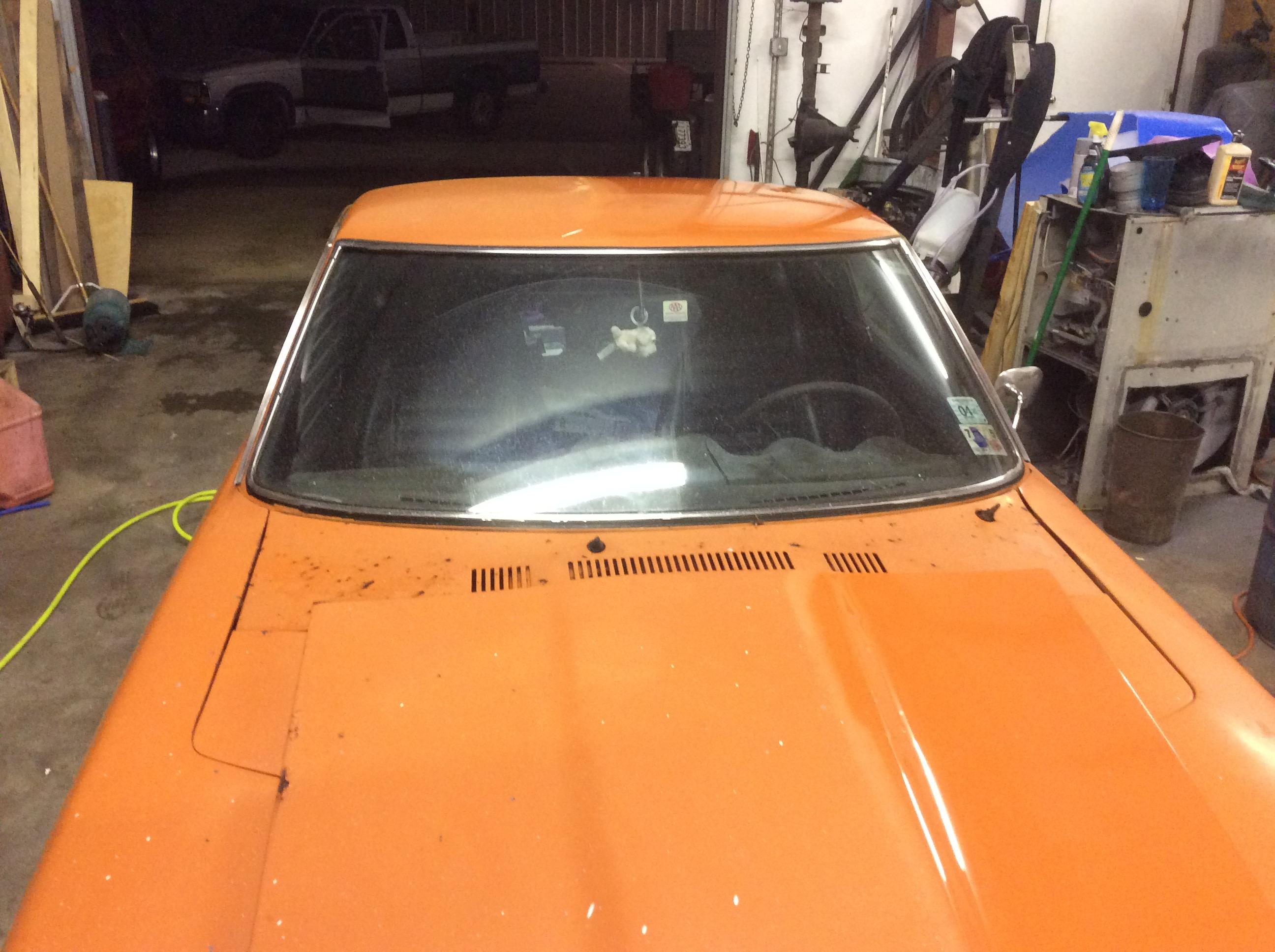

Like I said earlier, I don't see any signs of rust on the shelf at the rear of the hatch opening for example, which is often rusty in these 50 year old first-year Z cars. Similarly, from what you can see of the rocker panels, I don't see rust perforation there either. Maybe there is some, but so far I don't see it in the posted pictures.
Maybe being a Texas car has saved it, but I have seen way more rusty or butchered cars being offered lately. In my experience I would much rather have an honest, unbutchered early Z car body to work on than so many of the cars that have come out of the woodwork lately.
