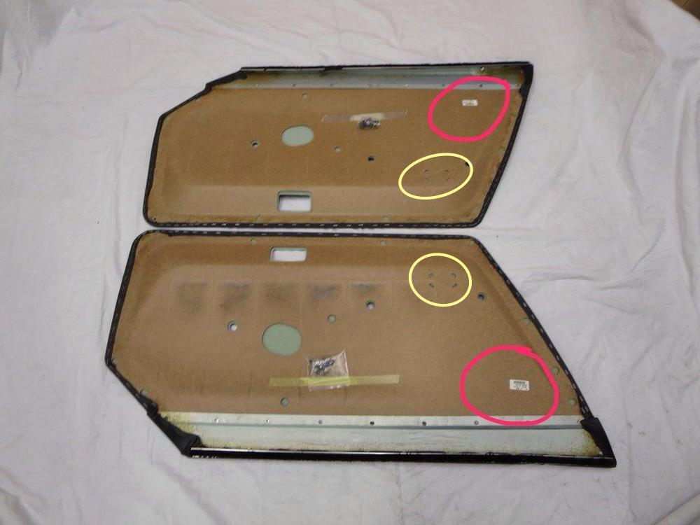

January 28, 20196 yr comment_566889 They mount in the door. If you take off the interior panel on the door, you will see some holes you never noticed before. Edited January 28, 20196 yr by zKars Link to comment https://www.classiczcars.com/forums/topic/61487-rare-step-lights/#findComment-566889 Share on other sites More sharing options...

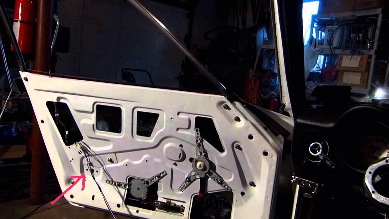

January 29, 20196 yr comment_566895 I wonder how the power is ran, as there is no hole in the door or A pillar? Link to comment https://www.classiczcars.com/forums/topic/61487-rare-step-lights/#findComment-566895 Share on other sites More sharing options...
January 29, 20196 yr comment_566899 It looks like they mount in the lower portion of the door card, to illuminate on the ground as you step out right? These spots look appropriate as they are under the arm rest. They line up better with your other pic of the door too. I would think power would be run from the door jam push switch by the hinge, so they come on as you open the door like the interior light. Link to comment https://www.classiczcars.com/forums/topic/61487-rare-step-lights/#findComment-566899 Share on other sites More sharing options...

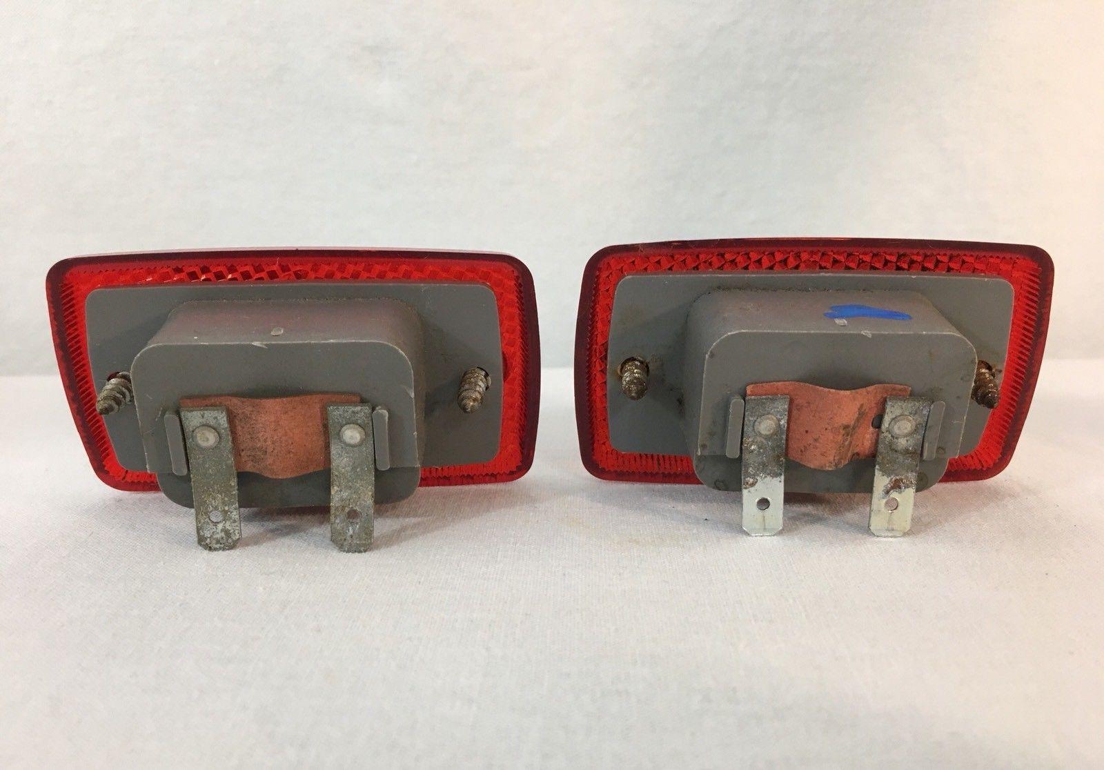

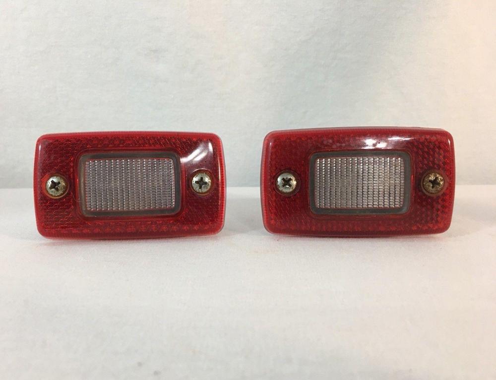

January 29, 20196 yr comment_566903 The wiring pigtails (pair of bullet connectors) for them are under the dash on each side, taped to the rest of the harness with blue tape in every Z I've worked on. Just like the fuel pump wiring waiting for you in the back with the sender harness. I also have wondered how to wire them properly into the doors. I have used the pigtail wires to wire some simple little LED fixtures under the dash on each side to vastly improve the interior lighting. Edited January 29, 20196 yr by zKars Link to comment https://www.classiczcars.com/forums/topic/61487-rare-step-lights/#findComment-566903 Share on other sites More sharing options...

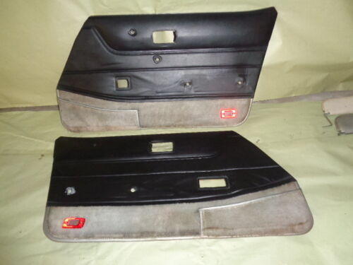

January 29, 20196 yr comment_566911 Hoover's above post of the originals are the first I've ever seen of them, although I knew of their existence from the parts manuals. I've had my eyes on the step lights from a 280zx for some time. These are red---there was a clear version as well. While not as correct as these originals, they could be had for considerably less and should work just fine. They would mount in the locations shown but somewhat differently, in that they would screw into the door cards from the front, finished surface. Edited January 29, 20196 yr by Zup added photos Link to comment https://www.classiczcars.com/forums/topic/61487-rare-step-lights/#findComment-566911 Share on other sites More sharing options...
January 29, 20196 yr comment_566956 Yes, i agree the door switch would turn them off and on, just not sure how the wire would go from the switch to the lights in the door. The wires would have to be long enough to open the door all the way and not to long to get pinched it the door when closed. As well as holes drilled in both the door and A pillar. Seems like a lot, when the hole is already in the door card and wires run in the harness. Much more than plug and play. Link to comment https://www.classiczcars.com/forums/topic/61487-rare-step-lights/#findComment-566956 Share on other sites More sharing options...
