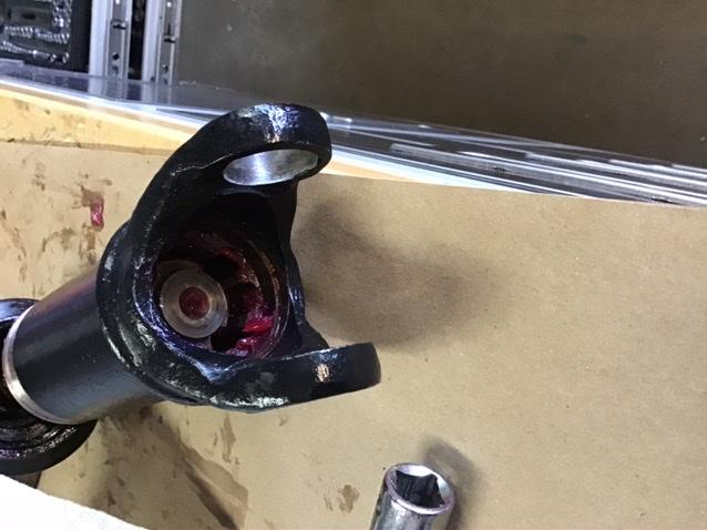

@wheee! how much play is there with it fully assembled?  In essence, how far can I pull shaft apart if I yank from both ends?  If I’m correct, the cap/clip will eventually stop me from pushing it together.
NOTE:  if I remove the cap/clip I can push them together pretty easy.  Pulling them apart is hard but doable until the end of the shaft is inside the case about one inch and then hard stops.

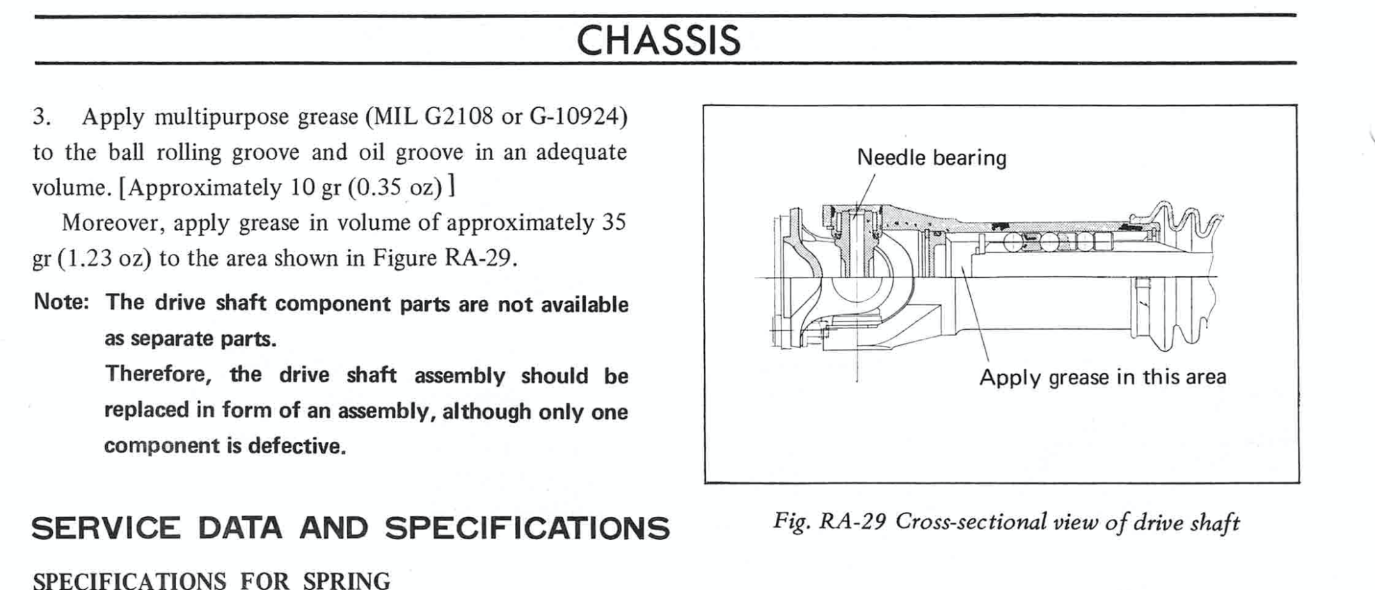

The FSM says apply 1.23 oz. to the area shown in the diagram.  The diagram is a bit tricky, but it looks like I apply 1.23 oz. to the entire channel where the balls and spacers go.  I think I likely used more grease than that.  Thx again.
