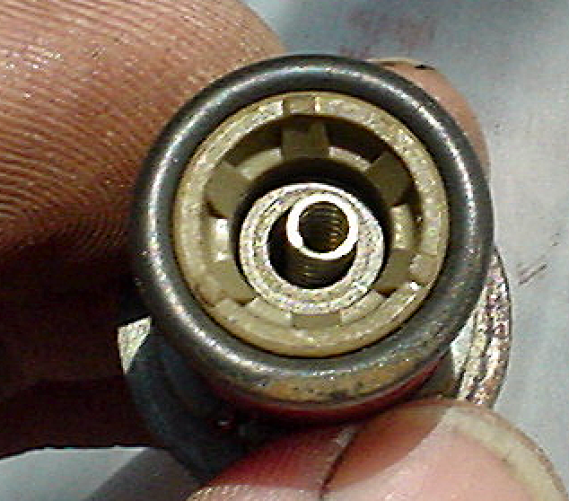

This is off the intake manifold on my spare engine. I am toying with the idea of trying to get it running on the existing parts to base line it before any decisions are made as to rebuilding the engine.
So 1st order of business is to get the fuel injectors working. So far I am up to 3 working. here is a video of my setup to unstick some frozen injectors. The 3 remaining hard cases are now off the rail so I can get some PB blaster down the inlets hoses. The one under suction did NOT come unstuck. I will run them for several hours and see if anymore come unstuck. If not I will try the suction approach again, but will use my 2 stage vacuum pump rather than the little hand held job. I was hoping the reverse flow would work better since I presume there is spring loaded plunger that would be pulled up by the vacuum, assuming its stuck down (closed). I did try rapping them with the back of a large screw driver, in an attempt to shock break them.
I also have the bolt buster induction heater, that seems like a last ditch method as I have no idea of how it would effect them. I could try holding the large body in the center of a ring and give it a few seconds just to see what happens.
