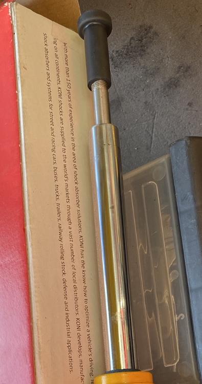

September 7, 20204 yr comment_605507 It might just keep sharp edges, and dirt and grime from wearing the bump stop out. It distributes the force more evenly than the ragged edges and holes of the gland nut. Surely if the bump stops are being hit that often to take damage from the gland nut then the suspension setup needs rethinking! In all my crazy Z driving over 8 years I have only ever hit the stops twice while being very silly over a bump back bridge at speed. BTW the Koni gland nut is pretty smooth with no sharp edges - not a great photo here as I was focused on the spring markings but you can see what I am talking about. Also I used motorbike dust covers on mine which provide a lovely tight fit. So no dust / grim getting in Back to the point[mention=6833]madkaw[/mention] raised, that steel spacer is missing off the pretty generic instructions from what I could tell. Link to comment https://www.classiczcars.com/forums/topic/61542-koni-sports-for-classic-zs/?&page=16#findComment-605507 Share on other sites More sharing options...

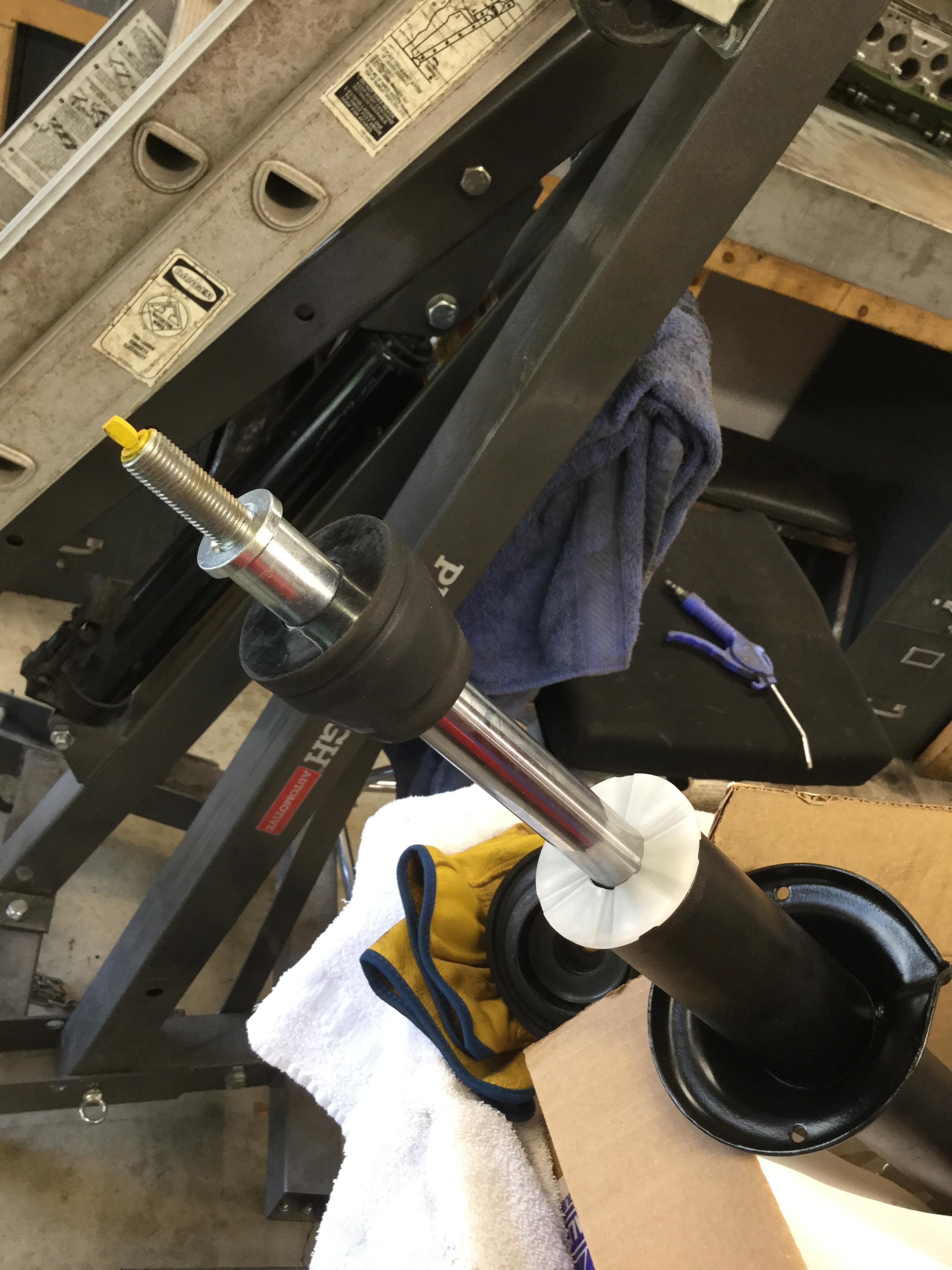

September 8, 20204 yr comment_605526 16 hours ago, madkaw said: Freaking IKEA instructions - give me a break . what about the spacer ? I can’t find it in the instructions . Steel bushing guys - on top of strut piston ! Is that on correctly ? What is it’s purpose? My KYB’s do not have this . Anyone ? Link to comment https://www.classiczcars.com/forums/topic/61542-koni-sports-for-classic-zs/?&page=16#findComment-605526 Share on other sites More sharing options...
September 8, 20204 yr comment_605534 When I did mine I found that the way up you have it works best. It basically locks the top of the plunger to the bottom of the strut cap thing with the 3 studs coming out of it. You can even put it on upside down and it will work, but you can’t install your shocks without it as far as I could see. Well you could but the lip on the small part of the shaft isn’t large enough to be strong enough. Does that make sense? My old tockicos didn’t have it but the shaft was uniform and fat all the way to the top, the Konis aren’t without that spacer. My guess is that the plunger shaft is a generic design used for other models and they provide the spacer to fit the Z. Here’s the comparison of tockico v Koni Link to comment https://www.classiczcars.com/forums/topic/61542-koni-sports-for-classic-zs/?&page=16#findComment-605534 Share on other sites More sharing options...
September 8, 20204 yr comment_605541 That’s what I thought -but wanted to make sure Link to comment https://www.classiczcars.com/forums/topic/61542-koni-sports-for-classic-zs/?&page=16#findComment-605541 Share on other sites More sharing options...
September 8, 20204 yr comment_605545 Always good to do the job the once ;) BTW as I’m sure you know, that bump stop will sit nicely on the spacer of you push it all the way up. Link to comment https://www.classiczcars.com/forums/topic/61542-koni-sports-for-classic-zs/?&page=16#findComment-605545 Share on other sites More sharing options...
