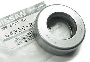

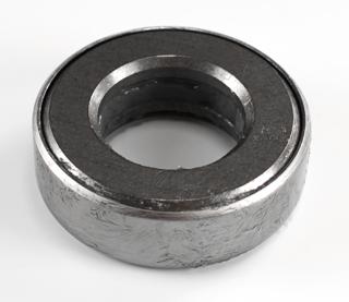

If these are the fronts.. why is there not a bearing in the top that can let the top rotate?  (these bearings are bearings that are not like the wheelbearings but rotate top and lower part ..  (i don't know how to say this on an other way..)
Nice picture drawn but the topbearing shoud be drawn in an other way.. there should be a top and lower half with ballbearings in between. Again, nice drawn.. you'll figure it out i'm sure!  😉

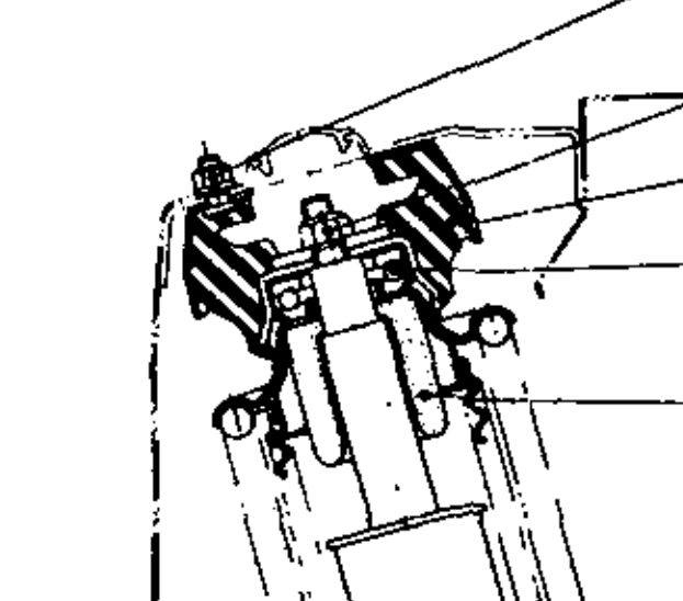

I was thinking about drawing up some Datsun Specific instructions for these. Is that something anyone would be interested in? I started modeling some reference 3D files for my own sake. Can anyone confirm this is the stack up for the fronts?
This is much clearer than the Nissan drawing.  I posted that snip from the FSM mainly to show the ball bearings in the races.  And the "bound bumper rubber" that I think nobody has ever actually seen.
Actually, I have seen those Nissan OE snubbers. I bought them from MSA back in the mid-1980's.  They were installed on struts that got stored and I didn't get around to using them until 30 years later.  When I checked them out, they looked perfect but crumbled to the touch.  So much for open-cell, natural rubber suspension bushings.  The sad part is that today's no-cell neoprene bushings are not the answer for a lot of owners (unless you are dedicated to track days, autocrosses, or live in a part of the world were roads aren't exposed to frost-heave).

Here is an updated Cross Section with the edited bearing for clarity. I've also created a file for a longer strut adjustment knob that I am looking for a place where it can be readily downloaded and 3D printed if you wish. I will post when it is live.
