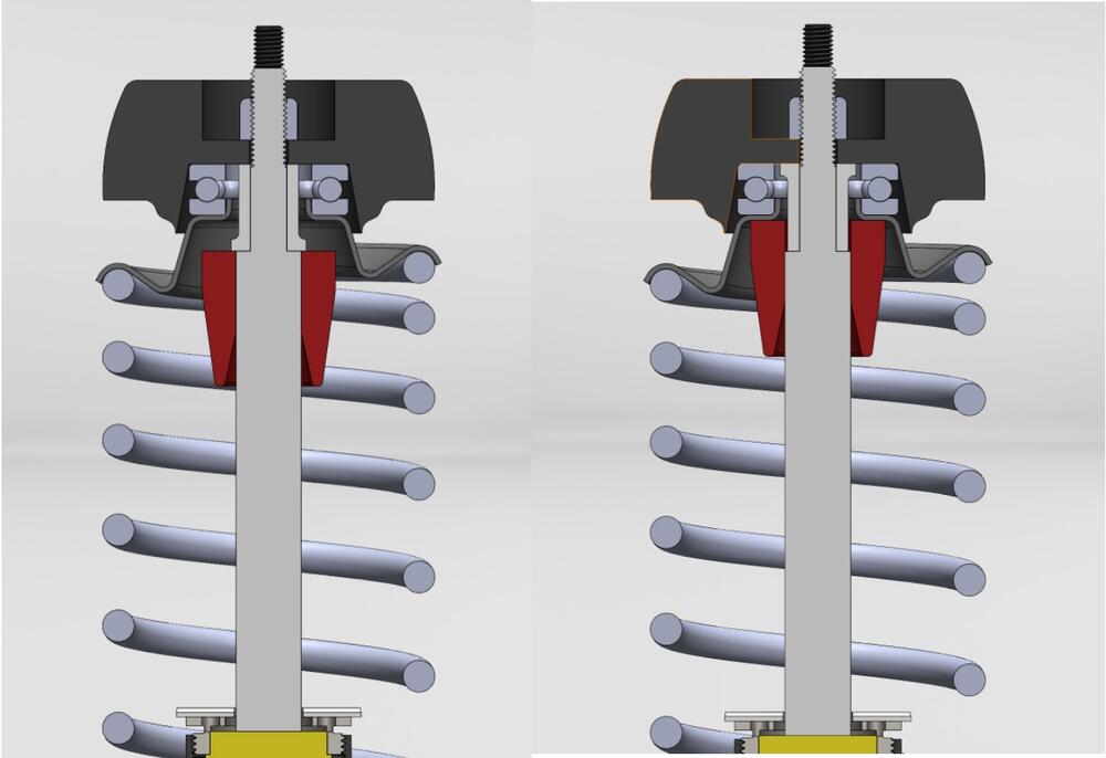

The way I modeled this was based off my own interpretation and I chose to place the flange on top to give more surface area support for the insulator as well as to let the bump stop seat all the way into the spring perch as it does in the stock setup. Given that the stock struts do not have a flange and are fine with the contact area they have I can see why the koni engineers would say either way is fine. I chose mostly based off the way the bump stop seats but if you have a different bump stop the results may vary.

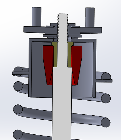

I wanted to see how this setup looks like if you use the Insulated Spring Seat & Strut Mount Set from MSA.

It looks like a sleeve without the flange would help to move the bump stop further upwards.

Well, right now I am still gathering parts, I have not installed the MSA strut mounts yet.
But they seem to provide more damper travel (as advertised).

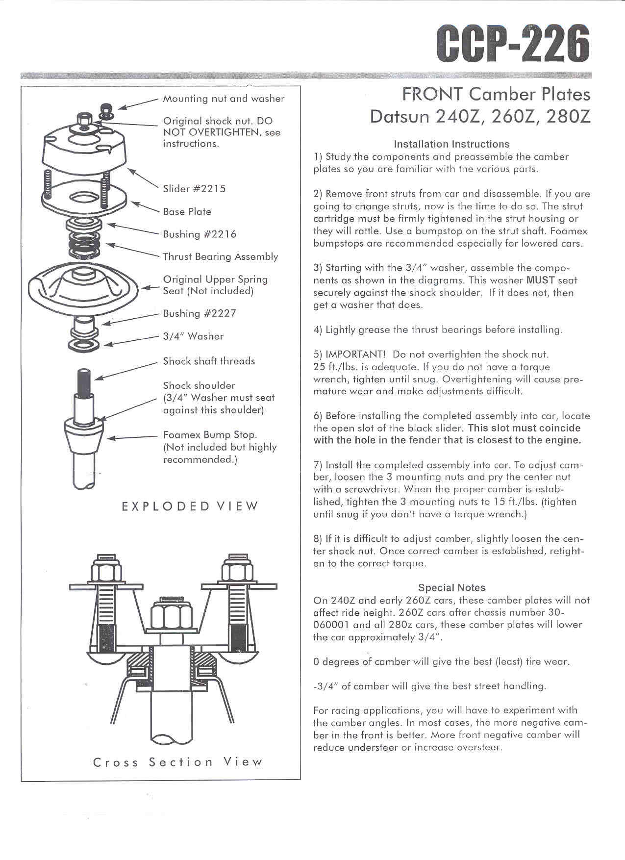

Those diagrams are awesome... I started a convo on Facebook about this install. I got the Eibach Progressive Springs, Koni Yellows, and for the front the Adjustable Street Camber Kit from MSA. So weird mix of parts and I made it to this thread and this was all mega helpful. The street camber kit as an extra bushing that is designed to sit on top of the strut where the metal bushing from the Koni's goes... so I assume we just can exclude that? In the diagram I am attaching it is "Bushing #2227"
