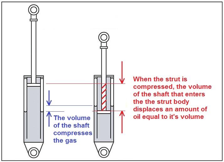

February 19, 20196 yr comment_568788 6 hours ago, LeonV said: The force exerted by the gas charge, and thus spring rate, depends on the piston size and pressure. I'm no suspension expert and I'm going to go out a little too far on my limb here, but I don't think that's quite right. I believe the force exerted by the gas is proportional to the diameter of the strut shaft where it exits the cartridge, not the diameter of the internal piston. I don't think the diameter of the internal piston has any effect in this case. My understanding goes like this: The more the strut is compressed, the more of the shaft is INSIDE the strut. The additional volume of the shaft (A*L) inside the strut assy will displace oil inside the body. That volume of oil displaced will compress the gas inside the strut, but only by the amount of VOLUME of the strut rod which has entered the strut. The internal gas pressure is static across the internal piston. At least that's how it appears to me way out on my limb here. Link to comment https://www.classiczcars.com/forums/topic/61542-koni-sports-for-classic-zs/?&page=5#findComment-568788 Share on other sites More sharing options...
February 19, 20196 yr comment_568796 13 minutes ago, Captain Obvious said: I believe the force exerted by the gas is proportional to the diameter of the strut shaft where it exits the cartridge, not the diameter of the internal piston. I don't think the diameter of the internal piston has any effect in this case. So in you diagram the plate (red arrows) inside the strut that the shaft is attached to has holes so the oil flows through the plate and it's the additional shaft volume inside the strut that compresses the gas. This plate is to keep the shaft centered in the strut. This does make sense to me. Link to comment https://www.classiczcars.com/forums/topic/61542-koni-sports-for-classic-zs/?&page=5#findComment-568796 Share on other sites More sharing options...
February 19, 20196 yr comment_568838 The plate you pointed to is the main hydraulic piston where the damper valve(s) are located. There is a seal around the outside of that plate and valves built into it. It does keep the bottom of the shaft centered, but that's not the only thing it does. That's where the primary "function" of the damper is located. Here's what I'm talking about with the gas compression. When fully extended, there will be some preload factory set pressure in the gas. And then when the strut is compressed, the gas does get compressed some, but it does not see compression proportional to the diameter of the main internal piston. It only sees compression proportional to the diameter of the shaft that enters the strut assembly: Link to comment https://www.classiczcars.com/forums/topic/61542-koni-sports-for-classic-zs/?&page=5#findComment-568838 Share on other sites More sharing options...
February 19, 20196 yr comment_568844 Thanks for the clarity, I thought that's pretty much what I said about the shaft volume increasing in the strut is what compresses the gas. Since these new Koni's are adjustable, I'd guess that the adjustment is to what you refer to as the "damper valve(s)" which changes how easily the oil can move through the plate attached to the shaft. The more open the Damper valve(s), the softer the ride. Edited February 19, 20196 yr by w3wilkes Link to comment https://www.classiczcars.com/forums/topic/61542-koni-sports-for-classic-zs/?&page=5#findComment-568844 Share on other sites More sharing options...
