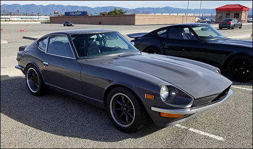

February 22, 20196 yr Author Vendor comment_569070 Koni Test Drive Z Owner Ian Stewart’s Impressions "Hello everyone, my 260Z was used as the test vehicle for the new Koni struts. The car was the perfect candidate as I had already rebuilt the suspension with new ball joints, Urethane bushings throughout (both front and rear), stiffer springs and Illumina struts. The only change that was made for the testing was replacing the Illumina’s with the Koni’s. The Koni’s are an improvement over the Illumina’s in my opinion. You need to get used to not having a way to tell where you are at as the Koni does not have an indicator, but the adjustment range is much wider and you can really feel the difference when you make a change. I never really noticed differences when I adjusted the Tokico’s, whereas I can definitely feel the difference when I adjust the Koni’s. My car is fitted with 160in-lb front and 180in-lb rear springs that lower it about 1.5 inches from stock. Note that these spring rates are similar to most aftermarket spring sets for Z-Cars, at roughly 2X stiffer than stock springs. At full stiff on the Koni adjustment the car is too harsh, but at full soft, it is comfortable (to me) for street use, I like the ride. I have not auto-crossed the car yet, but expect the full stiff setting will work very well." Ian Stewart. Link to comment https://www.classiczcars.com/forums/topic/61542-koni-sports-for-classic-zs/?&page=6#findComment-569070 Share on other sites More sharing options...

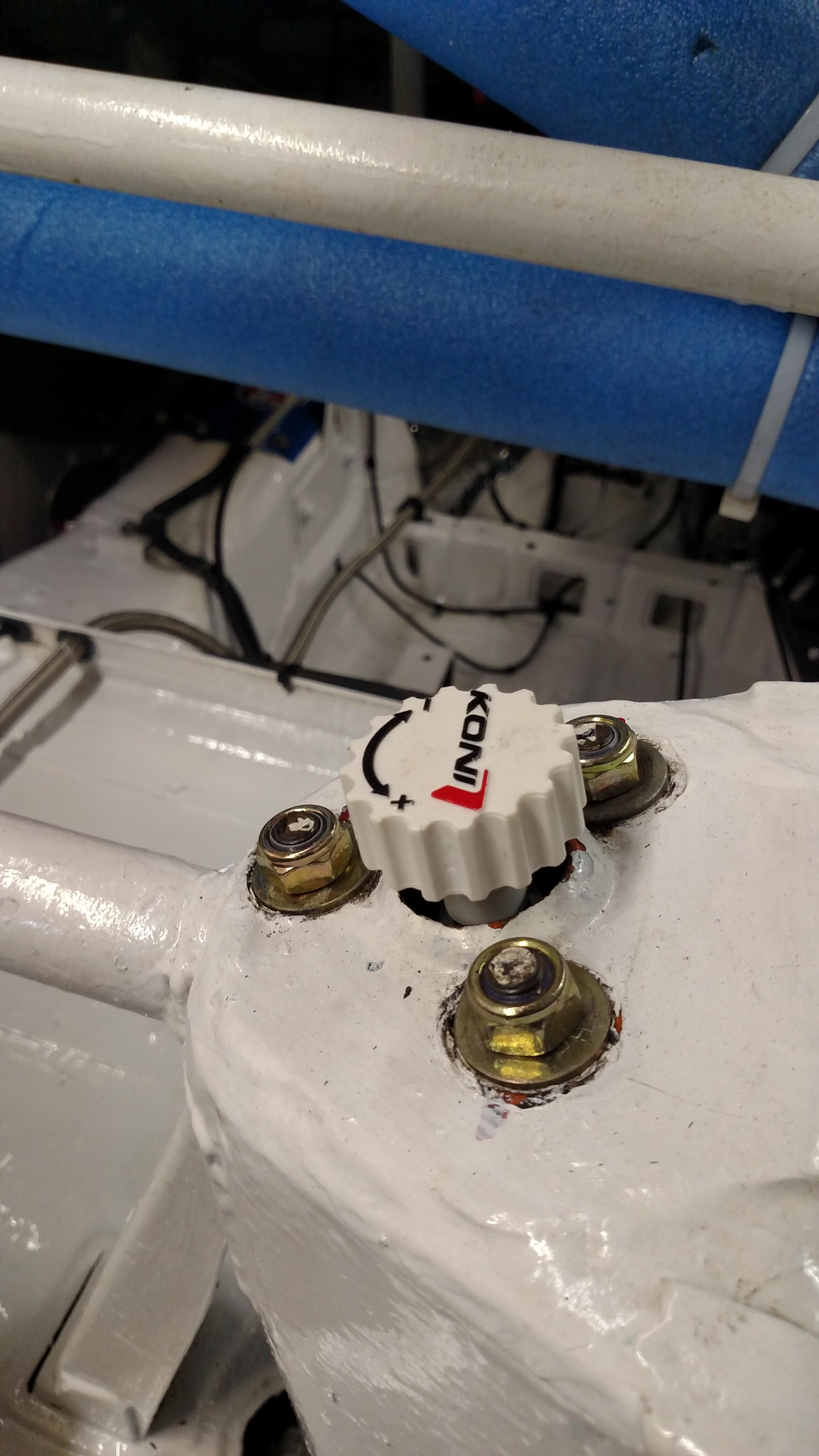

February 23, 20196 yr comment_569149 I am in the process of switching out my Tokico HTS shocks for a set of Koni 8610-Race because I am increasing the front springs from 375# to 450# which many folks believe is too much for the HTS's to handle before blowing. While this might not be true, having to replace a shock or shocks at the track would be a PIA not to mention that HTSs are NLA. Like the Koni the HTS had a wider range of adjustment with no numbers to go by just the requirement to remember how many turns you made. Unlike the Koni the HTS could not be rebuilt. These Koni "Sport" shocks look to be a perfect solution for every type of driving one might do. That Koni and MSA are now producing a Better replacement shock for our Zs is wonderful news and I salute their efforts to ensure we can continue to enjoy these great cars for many more years. I've attached a picture of the Race shock adjuster which I assume is similar to the one used for the Sport version (once it's set you would remove it from the shock and Koni suggests that you put it in the glove box). Link to comment https://www.classiczcars.com/forums/topic/61542-koni-sports-for-classic-zs/?&page=6#findComment-569149 Share on other sites More sharing options...
