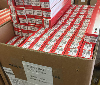

April 5, 20195 yr Author Vendor comment_572710 Hey late 260Z & 280Z owners, look what showed up in our warehouse this week! If you pre-ordered your struts, they are already on the way. If you didn't pre-order, get yours from the first batch so you don't miss out on adding these in time for the summer driving season (the huge box of 240Z & early 260Z struts we posted previously, for instance, is half empty already). 280ZX owners, we'll update you here as soon as we have more info. Thanks for your patience! Link to comment https://www.classiczcars.com/forums/topic/61542-koni-sports-for-classic-zs/?&page=7#findComment-572710 Share on other sites More sharing options...
