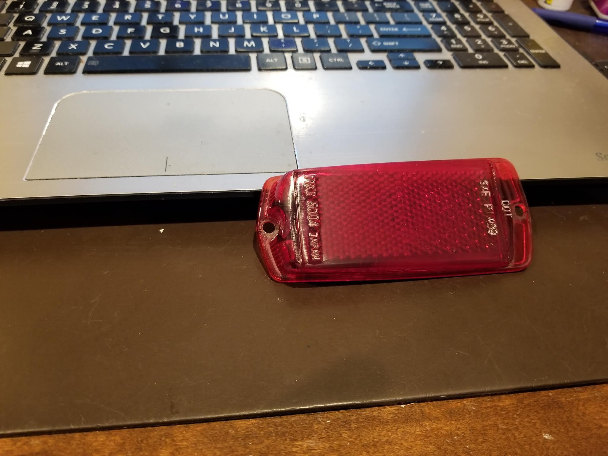

I saw somthing on the web that showed the restoration of a plastic lens.  I think the youtube was done by chris fix.  They did something I had not seen before - clear coating plastic – so I thought I would give it a try.  Side marker lens' are fairly inexpensive and available so if I screwed it up or if it just flat out did not work it would not be a total disaster.  My rear side markers were scratched and they were moderately oxidized.  Unfortunately, I was so excited to try something new that I did not take a “before” picture.  I did think of a picture after I had sanded the reflectors.  Below is the image after wet sanding with #600, #1000, #1500, and #2000 grit.  If you decide to do this you can skip the 1500 grit, its just not necessary for this type of project.

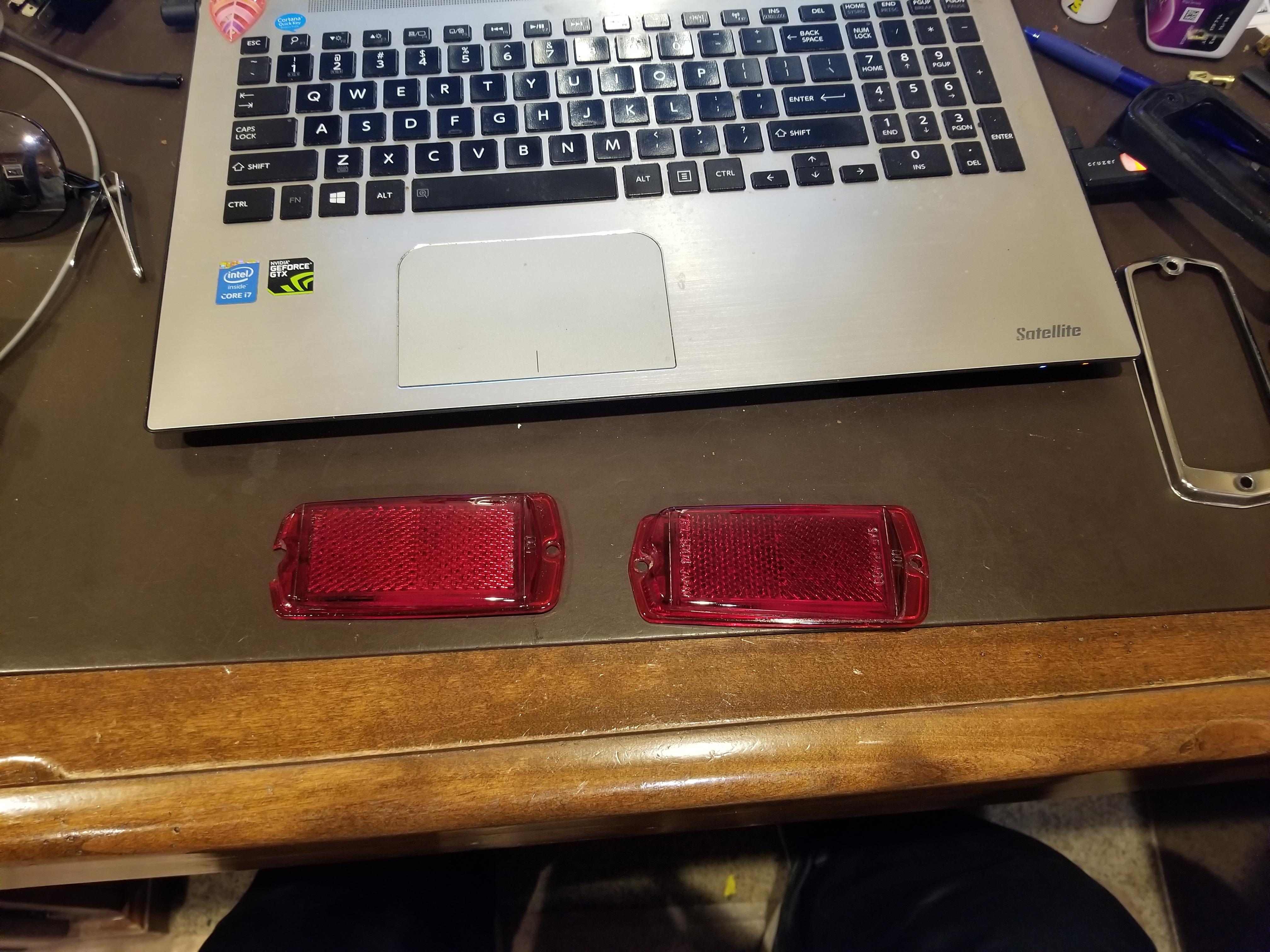

After sanding I cleaned it with Eastwood Pre Prep.  Then I sprayed an adhesion promoter for plastic (I am happy with the results that I get with SEM products (sand free), but there are others as well).   I then sprayed clear using a VHT spray can that I had left over from another project.  A couple of light coats and then 2 medium wet coats.  The trick here is to try to get the clear to flow without causing any runs.  If you do get a run or noticeable orange peel you can always sand it with #2000 grit, and polish and buff, or you can always start over with #600 grit, #1000, #2000 and re-clear.  Anyway, below is an image of both reflectors with clear coat.  You will have to trust me on this - the picture does not measure up to the actual result.  The lens look like brand new.  For some reason, lighting, reflections, who knows what the picture just does not measure up.  One caution - do not touch the lens for at least 24 hours.  The clear coat needs to cure (harden) before you handle it and definitely do not rush to assemble it.

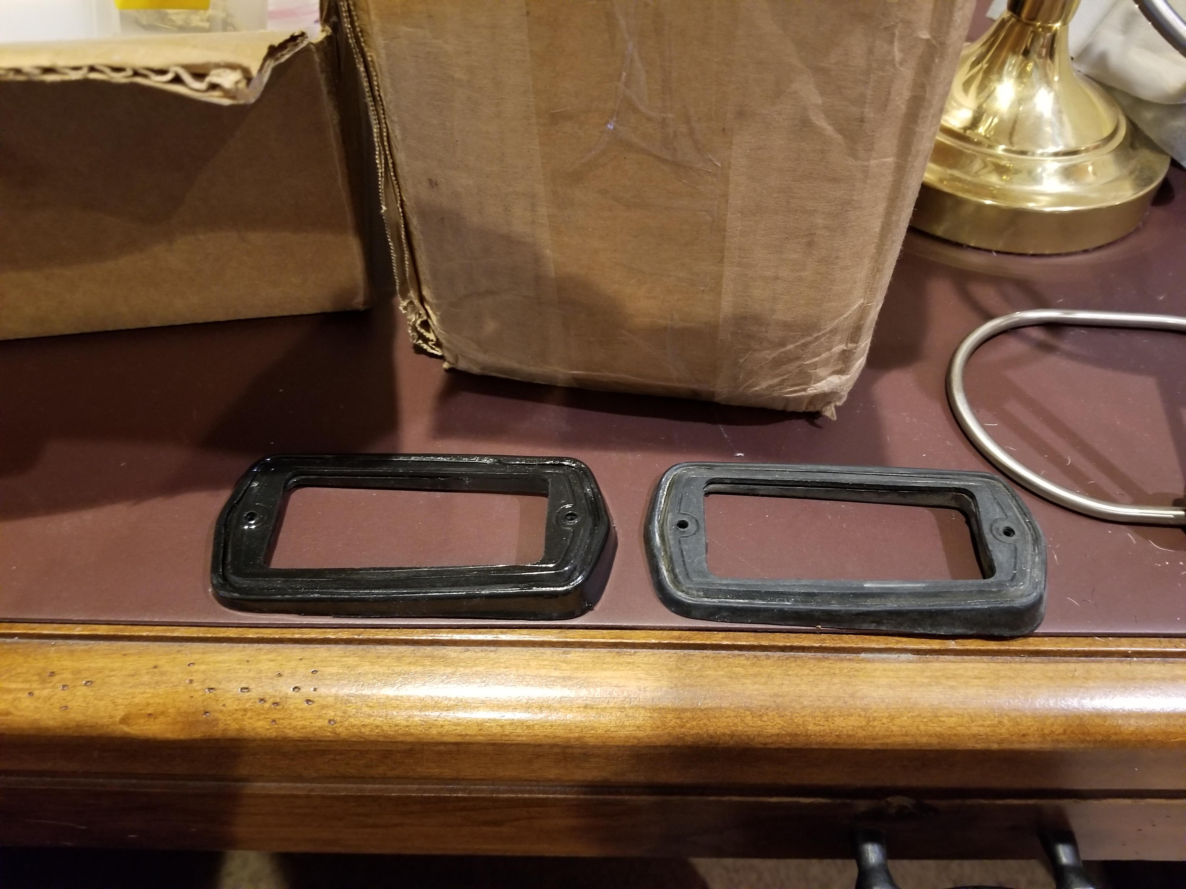

Of course, if a little is good why not do more – so I cleared a rubber gasket just to see if it would take the clear.  The next image shows one gasket cleared and one without the clear coat.  Normally I would not even try to paint rubber without the right product, but the gasket took the clear and it is a big improvement.  If anyone has used a specific product line please let me know what adhesion promoter worked for you on rubber.
I am amazed with the results.  Now, I don’t know if any of the products that I used will ultimately do harm to the plastic reflectors or whether these results will hold up for any length of time, but at this point I would have to say the results were terrific without spending a great deal of time and without requiring a lot of technique, and with very little expense.
Bottom line: I would certainly recommend this process.  My expectation is that the clear will hold up over time and the only real danger to the plastic could be the adhesion promoter.  Next time around I would leave out the adhesion promoter and only sand with the #600 grit and then clear.  If that was not smooth enough perhaps sand with finer grit after the clear coat and then buff.  Of course, I would like to hear from anyone that can tell me what the long term expectation should be and whether or not I should expect the lens to deteriorate.
