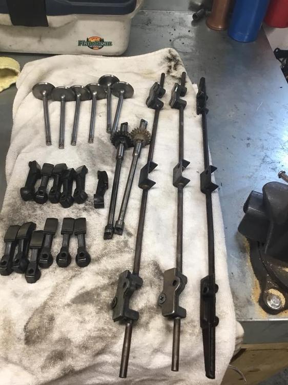

Hard to tell from the picture - but the valve train doesn't look to bad for a 50 year old. Oil bar is still intact.. Looks like a spare from a 260Z. Glad you were able to get the rear drums off - without destroying them. Take your time and enjoy the process..
Carl B.
The oil spray bar is there, but it's not to be trusted. The tell-tale angle of the tips says it's at high risk of coming apart soon. Especially at the rear.
I'd get a replacement in there before you put any significant time on the motor.
@z8987 if it's still available, you should buy the (newer design) oil spray bar all the way on the right in this pic:

If it's that important, is it possible to get a new one?

Don't think so. Last I looked, there were a couple people out there in the ether that make aftermarket replacements, but I think the design of the factory parts (the newer version at least) are better. There were two revisions from the factory... The early ones (like what you have on your car) sucked because they fell apart (like what yours is ready to do). The later version (like the one on the far right in that pic) were put into service to replace the early ones and do not suffer the same fate.
I actually don't know if they are still available at Nissan new. I think you should check and report back.   :geek:
