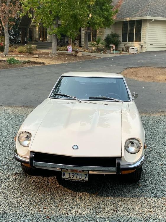

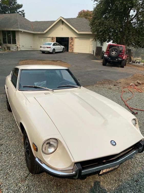

I've been driving and just enjoying the 70z.  I found another z in a garage.  This one has been sitting for over 30 years and appears to be in great shape.
