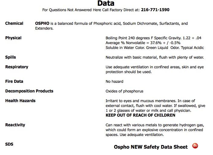

Ospho is an acid and you shouldn't be inhaling it. I normally do that kind of stuff outside but I don't normally wear a respirator. As long as you can't really smell it you should be good. Of course I could be wrong...
