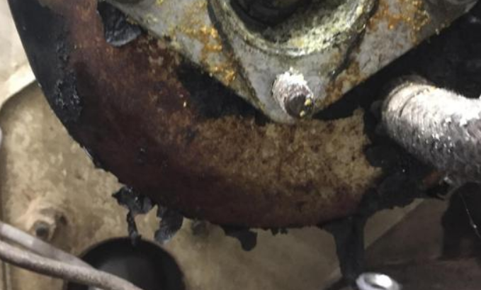

I pulled the master cylinder resivour off.  It's dried out and it looks like some type of corrosion.  The master cylinder itself is full of crud!  Do I need to pull the unit off the firewall and flush/clean it?  I'm cleaning the reservoirs and will blow out the lines. I'm just not sure what to do with the unit on the firewall?

The brakes are the most important system on any car,  pull the M/C and the booster,  if the inner cylinder of the M/C is in good shape you may be able to restore it with a rebuild kit but then a new M/C is cheap at about $110.  Brake fluid may have leaked into the booster so you will need to check that out, clean up and repaint.
You need to see if the booster will hold a vacuum. A vacuum gauge will be needed to accomplish this. Many fuel pressure gauges will also measure vacuum. It would be easiest to measure on an idling car. Then engine acts as the air pump. Plumb the vacuum gauge between the booster (the black thing on the firewall) and the check valve. Run the car, pull vacuum down and cut the car off. See if the vacuum holds or drops slowly. When master cylinders look like this, they have generally already leaked into the booster. The brake fluid destroys the diaphragm in the booster making it tear. Reconditioned boosters are available from vendors.

Especially the Master-Vac.  Might be worthwhile to disassemble it and seal any small tears in the diaphragm before they get big.  You know that brake fluid has probably been in there, the paint's peeling from the bottom of the booster.

52 minutes ago, Zed Head said:
Aren't these 240Z brake parts hard to find?  You guys are making it sound like it's a simple go to the store, swap the parts.
I believe most of the boosters are available reman'd. Although the smaller 7" boosters have a premium. He could also send it to a rebuilder and have it reworked. I have tried sealing that diaphragm in the past and have been unable to get satisfactory results. Harmon Brakes in GA is one possibility. If the OP is really industrious he could rebuild it himself like in  the booster rebuild thread. Reman'd boosters normally come unfinished; the boosters from a rebuilder come looking like new
Last year I couldn't find any new, nor remanufactured 6/7" boosters for my 72 240Z ... the reman's at that time said they had no cores to work with. There were remanufactures that would rebuild yours - if you sent it to them though one of the Major Auto Parts Stores.  I did not like that option, to easy to get lost on all the handling by different people.  Oh yes, I hasten to add when I did find the right size boosters on line - I ordered them - when they arrived they were the wrong size (1973 size) - so had to return them.
So I sent mine to Booster Dewey in Oregon.  His web sight doesn't mention rebuilding 240Z booster - but I called him - and one of the guys that works there owns a 240Z, so they did them as well. I sent him my original and had it back about 7 days later.  It wasn't cheap - AIR $165.00.- but I was happy with the turn around time and quality of work. Might want to give them a call if you can't find someone closer to you..1-503-238-8882, 4335 SE 63rd Ave.

While you are at it and everything is apart - replace it or rebuild it now. (nothing lasts forever).
