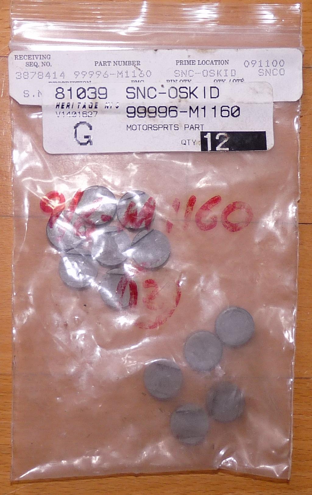

Good point.  I can check to see if all the lash pads are in place.
