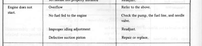

The pistons are black and it took a little work to wiggle them out.   I'll attach a picture.  Can I just clean these up, add oil then try the start sequence again? should the carbs be pulled rebuilt ?   I'd sure like to hear it run before I dig much deeper.
I couldn't find any carb stuff in the 70 or 71 FSM's.  But 72 might get you started.  Those are round top SU's I believe.  ZTherapy sells a CD that describes how to make them work too.
