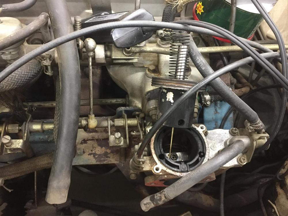

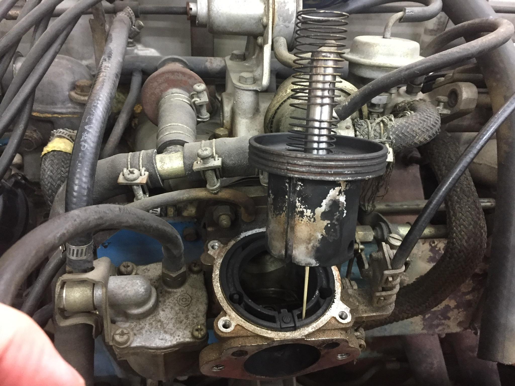

February 13, 20196 yr comment_568256 2 hours ago, z8987 said: I really can't do this witout you guys. I'm learning I now know what you mean by the piston, and oil. I turned it upside down, and guess what there's oil in it. Not the proper amount now, but there was oil. What type of oil and how much?? ? The pistons are black and it took a little work to wiggle them out. I'll attach a picture. Can I just clean these up, add oil then try the start sequence again? should the carbs be pulled rebuilt ? I'd sure like to hear it run before I dig much deeper. Rule #1, DON'T BEND THE BRASS NEEDLE that protrudes from the piston bottom. Start with a can of lacquer thinner, a soft brush, and some cotton rags. Clean every surface that you can reach. All those black surfaces in the pic are actually aluminum. When everything is clean reassemble the piston and dome onto the carb. The piston should slide up and down with no interference. Add 20 wt oil or ATF to the fill line on the small black stem. It might be a good idea to take a look in the float chambers to see if there's any flotsam or jetsom in there. Link to comment https://www.classiczcars.com/forums/topic/61554-ive-been-looking-for-a-project/?&page=5#findComment-568256 Share on other sites More sharing options...
February 14, 20196 yr Author comment_568265 1 hour ago, Mark Maras said: Rule #1, DON'T BEND THE BRASS NEEDLE that protrudes from the piston bottom. Start with a can of lacquer thinner, a soft brush, and some cotton rags. Clean every surface that you can reach. All those black surfaces in the pic are actually aluminum. When everything is clean reassemble the piston and dome onto the carb. The piston should slide up and down with no interference. Add 20 wt oil or ATF to the fill line on the small black stem. It might be a good idea to take a look in the float chambers to see if there's any flotsam or jetsom in there. She started. wood Link to comment https://www.classiczcars.com/forums/topic/61554-ive-been-looking-for-a-project/?&page=5#findComment-568265 Share on other sites More sharing options...
