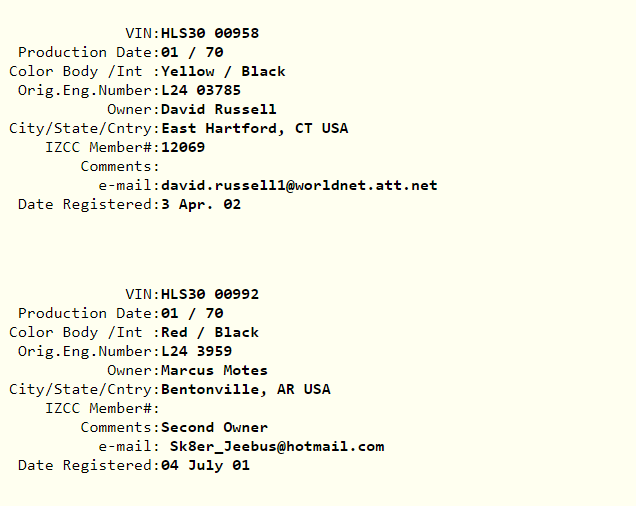

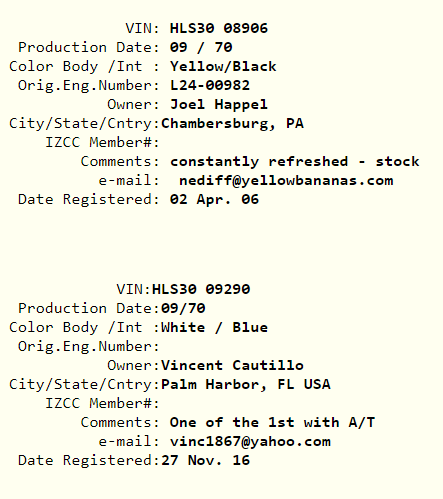

It's possible that my car is the first automatic.
So far as we have found - with a couple of exceptions -  the Datsun 240Z’s with VIN’s between HLS30 8944 and HLS30 9603 with DOM's of 08/70 - have been A/T equipped. The earliest reported was HLS30 07963 07/70.

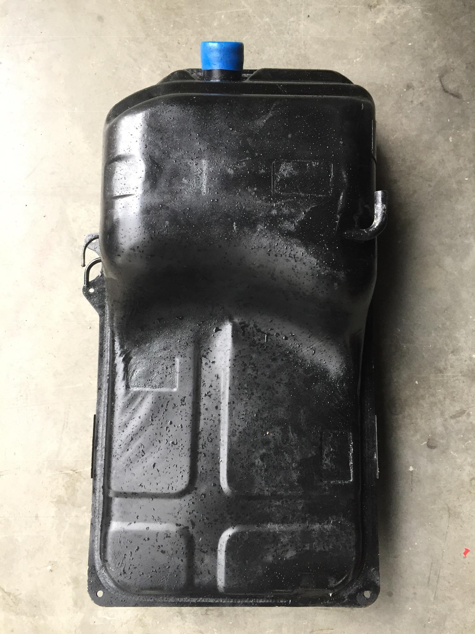

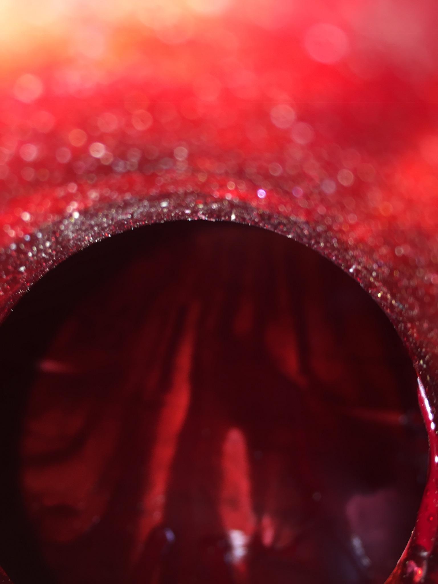

I got my tank back today. I asked them not to paint it, but they painted it. I was going to por15 it. Now I have just one vent, facing the right way.  I also had them line, that's the picture of the inside. I've never seen this done before.  I really wanted to do the por on it, and now I need to clean it up.  I was thinking about taking it to a place that does powder coating, and having it sand blasted and then doing the POR on it.   should I just have it powder coated.  Ideas?
