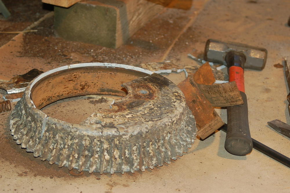

February 7, 20196 yr comment_567629 If you want to replace rear drums, they are cast and can be cracked apart to remove. Link to comment https://www.classiczcars.com/forums/topic/61557-70-240z-parked-15-years-brakes-stuck/#findComment-567629 Share on other sites More sharing options...

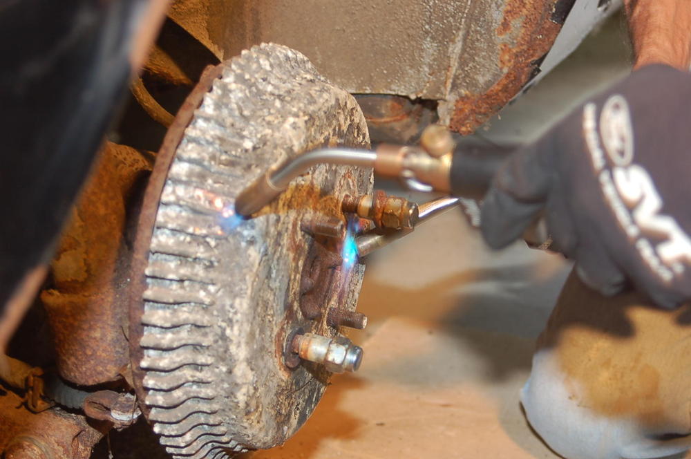

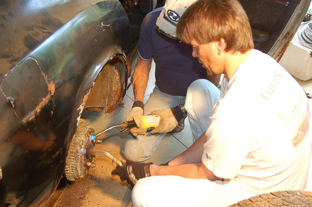

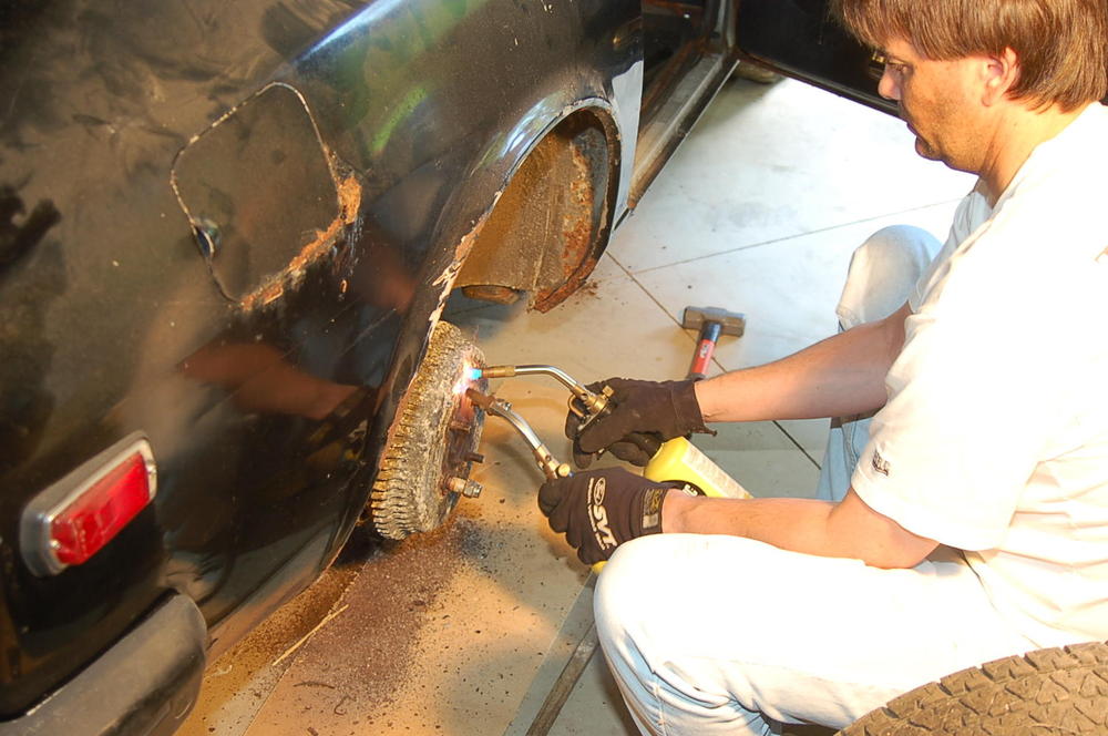

February 8, 20196 yr comment_567668 Heat the brake drum between the wheel studs to brake the rust that forms there, you need to get it pretty hot, penetrating oil will help also. Backing off the brake shoes will greatly help if possible. The fins are delicate use a block of wood between the hammer and drum. Lastly keep at it, it took several cycles of heat and banging on them in my case. Edited February 8, 20196 yr by jwtaylor Link to comment https://www.classiczcars.com/forums/topic/61557-70-240z-parked-15-years-brakes-stuck/#findComment-567668 Share on other sites More sharing options...

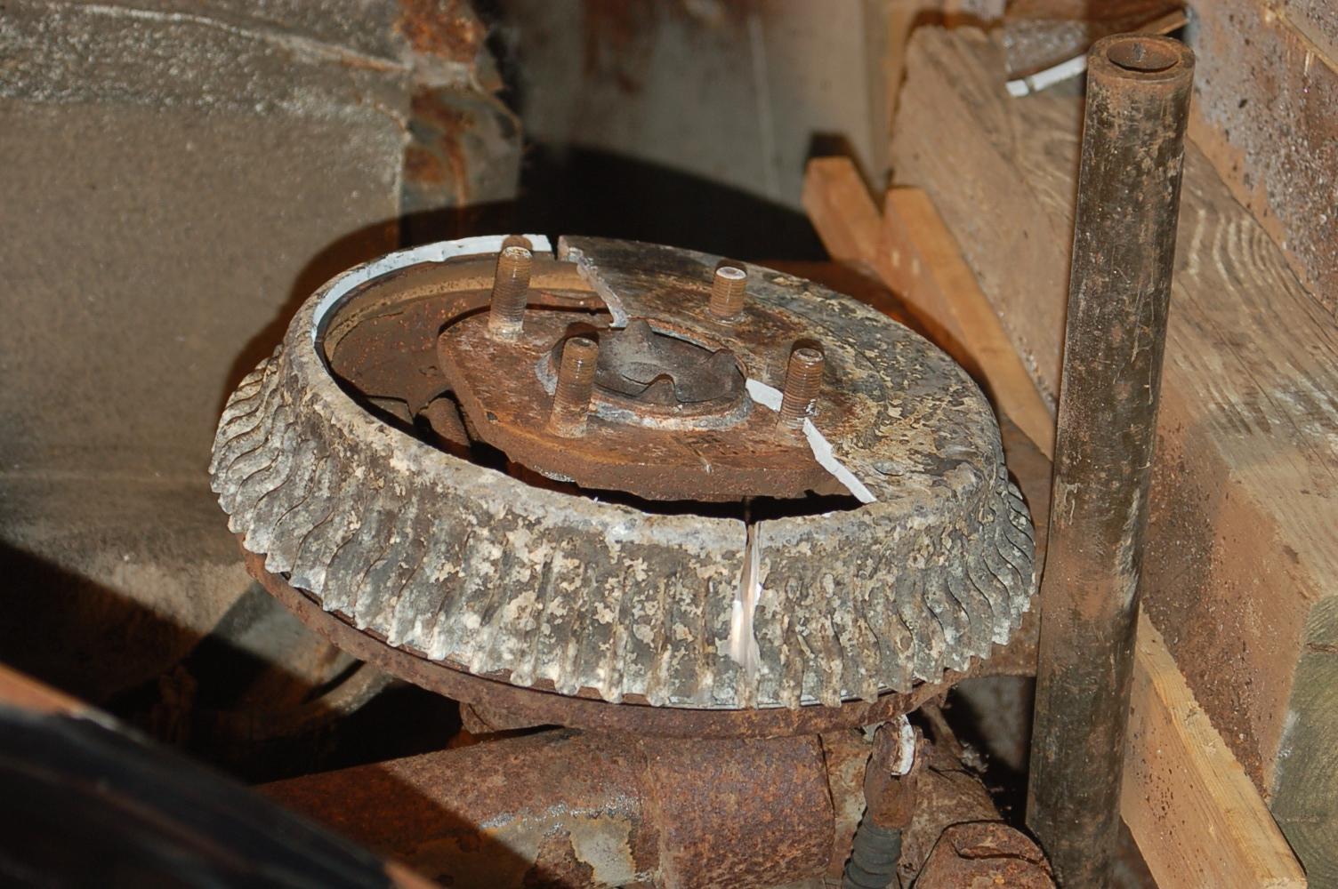

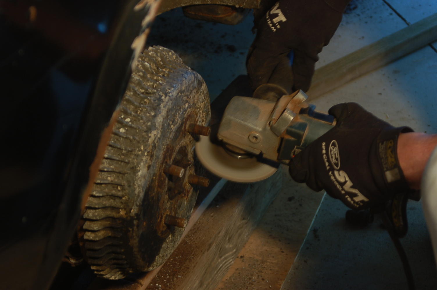

February 8, 20196 yr comment_567671 Depending on how bad they are, it might require drastic measures. I had one rusty old 280Z parts car that had been stored for about a decade and the drums were so seized on that I had to cut the drums in two. Even then, they were a bear to pry off. Hopefully it doesn't come to this! Good luck. Edited February 8, 20196 yr by Jeff G 78 Link to comment https://www.classiczcars.com/forums/topic/61557-70-240z-parked-15-years-brakes-stuck/#findComment-567671 Share on other sites More sharing options...
