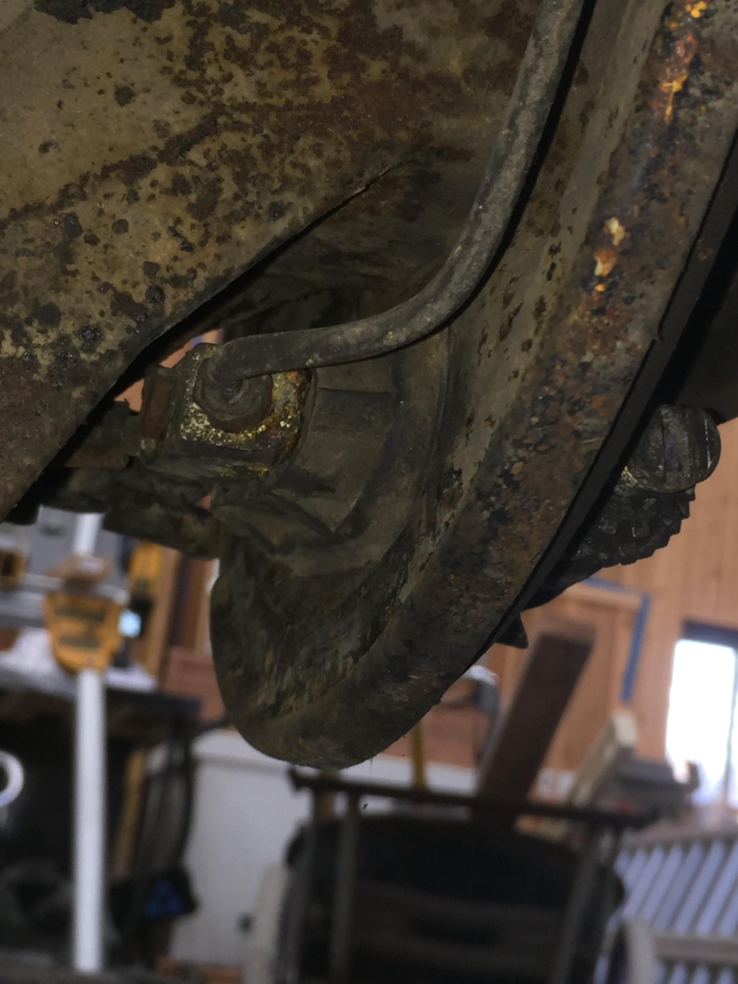

I don't have an access point in the back to adjust the brakes.  Is this normal, or do I have some type of aftermarket products?  The one photo you can see the adjuster and also the back where you would access it.
If you take a screwdriver and turn this gear up? I think, it will tighten the shoes by spreading them further apart.  First I would pull the emergency brake up a few times.  That should get them tighter.  You'll know by how far the handle comes up after a couple of pulls.  Should be less and less with each pull.
Edited by siteunseen
3 hours ago, z8987 said:
Ok, I got it. The adjuster is in the front of the wheel.  I got both rear wheels off, took the brakes off cleaned and reinstalled. So I did my first rear brake job.  Old parts, but now I know how.
Congratulations.  Regarding reinstalling the old shoes: the lining will have significantly hardened/glazed over the years and won't provide a lot of stopping power.  New shoes are pretty cheap and a good investment for your safety (and that of others).  Been there, done that!
