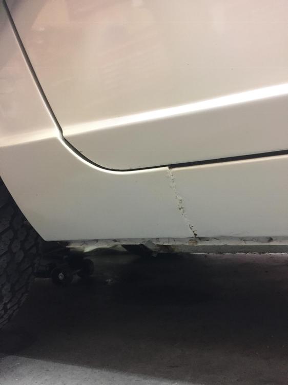

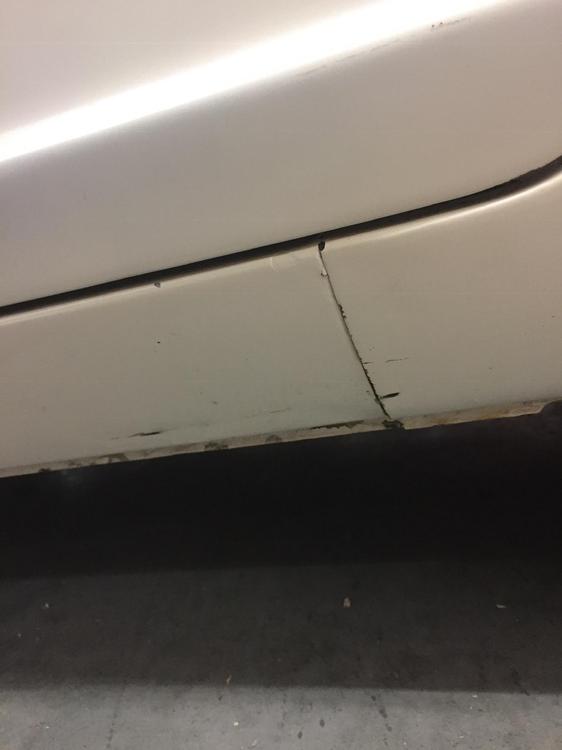

February 9, 20196 yr comment_567782 The bottom of a car doorSent from my iPhone using Classic Zcar Club mobile Link to comment https://www.classiczcars.com/forums/topic/61573-70-240z-wtf-is-this/#findComment-567782 Share on other sites More sharing options...
February 9, 20196 yr comment_567783 I'd say it's a half arse dog leg patch panel install. The inner rocker under that is probably pooched unless they tackled it too. But judging by the fit up.... Probably notSent from my SM-N960W using Tapatalk Link to comment https://www.classiczcars.com/forums/topic/61573-70-240z-wtf-is-this/#findComment-567783 Share on other sites More sharing options...
February 9, 20196 yr comment_567812 It could also be just some rust poking through at the seam between the dogleg and the rocker, clean it up with a wire wheel and see if that does it, you can also remove the panel between the wheel well and the door and peek through the hole on the body and look down into that rocker to see if it has spread further. Fingers crossed that you see clean metal. Link to comment https://www.classiczcars.com/forums/topic/61573-70-240z-wtf-is-this/#findComment-567812 Share on other sites More sharing options...
