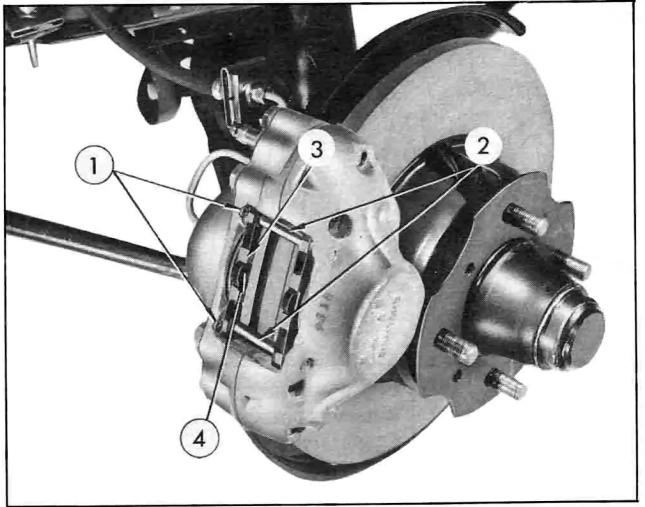

April 29, 20195 yr Author comment_574453 Have a question for anyone who might know. Was getting ready to rebuild the calipers and noticed that car 304 calipers were blank. They had no casting marks like you see most calipers like in picture # 0275 below. Does anyone know if the blank calipers are correct for this car? Thanks, Rod Link to comment https://www.classiczcars.com/forums/topic/61577-the-restoration-of-car-304/?&page=4#findComment-574453 Share on other sites More sharing options...

May 3, 20195 yr comment_574782 On 4/28/2019 at 6:52 PM, Rod's Garage said: Have a question for anyone who might know. Was getting ready to rebuild the calipers and noticed that car 304 calipers were blank. They had no casting marks like you see most calipers like in picture # 0275 below. Does anyone know if the blank calipers are correct for this car? Thanks, Rod Does anyone have thoughts on this? Link to comment https://www.classiczcars.com/forums/topic/61577-the-restoration-of-car-304/?&page=4#findComment-574782 Share on other sites More sharing options...
May 3, 20195 yr comment_574801 @zKars, do you have any blank calipers in your collection? Link to comment https://www.classiczcars.com/forums/topic/61577-the-restoration-of-car-304/?&page=4#findComment-574801 Share on other sites More sharing options...
May 4, 20195 yr comment_574804 Here are calipers in FSM that was photographed probably summer of 1969: Sumitomo on the casting. Link to comment https://www.classiczcars.com/forums/topic/61577-the-restoration-of-car-304/?&page=4#findComment-574804 Share on other sites More sharing options...
