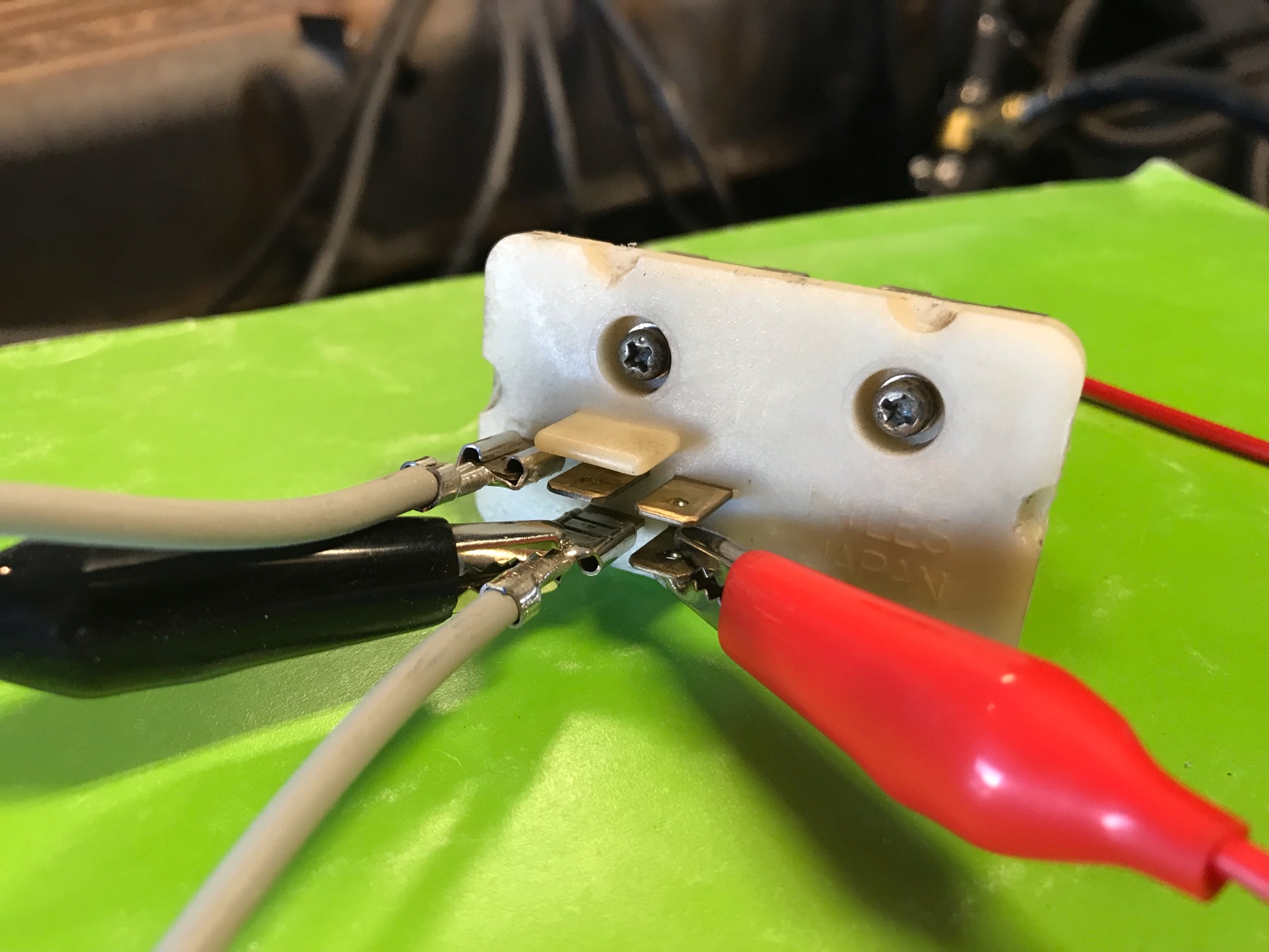

If you are getting the correct reactions on pins 91, 95, and 97, then the relay is working properly.
I suspect the "failure" you are seeing on the test between 95 and 96 is a test procedure error. You're trying to measure resistance on a device while it's under power, and your meter is not interpreting the results as you would expect.*
Out of curiosity... What resistance do you read between 95 and 96 if you swap the two meter leads? Put the meter on the 2K range, not the 2M range.
* For those who care... The Ohmmeter works by applying a small known voltage across the device being tested and then measuring the amount of current that flows. If you try to measure the resistance of something that already has a voltage applied to it, the meter doesn't interpret the results correctly. And in this case, if pin 95 is connected to +12 and 96 is connected to ground, you're putting an Ohmmeter directly across a 12V power source. Meter will display incorrect results.
I did ponder the measurement of resistance on a circuit that had voltage.  My reasoning didn't give me an answer.  A test light to represent the pump circuit might be a better test.  I thought that somebody had found a flaw in Nissan's overall test procedure for the pump control.   Maybe that was it.
The test results don't fit the original problem very well.  As SteveJ noted in post #11.  I just tried to move things along.  Might have extended the barking instead.  Sorry.
I get   .059 on the meter.
so my relay is working as it should.   If thats the case what else can be causing my fuel pump to turn off?   seem that after it runs for a bit it stops pumping, I dont hear it whining.

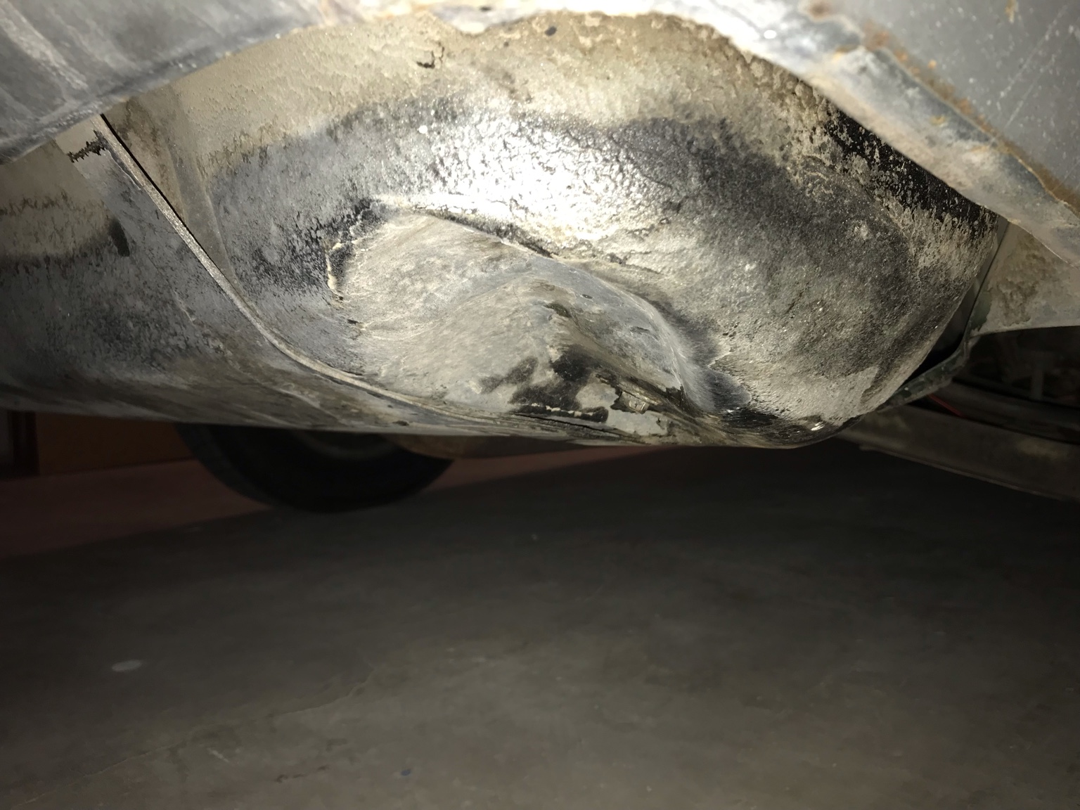

I did as you suggested and turning they key to the on position the fuel pump is working but it looks like its not getting gas.   I have a clear fuel filter on the outlet of the pump and its barley pushing any gas into it.  it get some pulses of gas but its not very much and sometimes it goes a good while with no gas pulsing in. is that normal or should there be a constant flow of gas ?   i have put at least 10gal of gas so i know there is gas in the tank.  sometimes during when it does pull gas from the tank i here some burping in the tank.   when i turn the car off i also here some burping.
Meter stayed around 11.45 volts
some extra info
there is a dent in my tank on the passenger side.   i know the outlets are also on that side.   Inside the tank how do those outlets look? are they flush to the inside of the tank or are the tubes inside as well?     had the car for years and never had an issue with the tank cause of the dent.  car also had the tank removed and cleaned out cause of bad gas.
Pic of dent attached IMG_3309.thumb.JPG.d0420a0618b8a9f0fb5021829764829a.JPG
